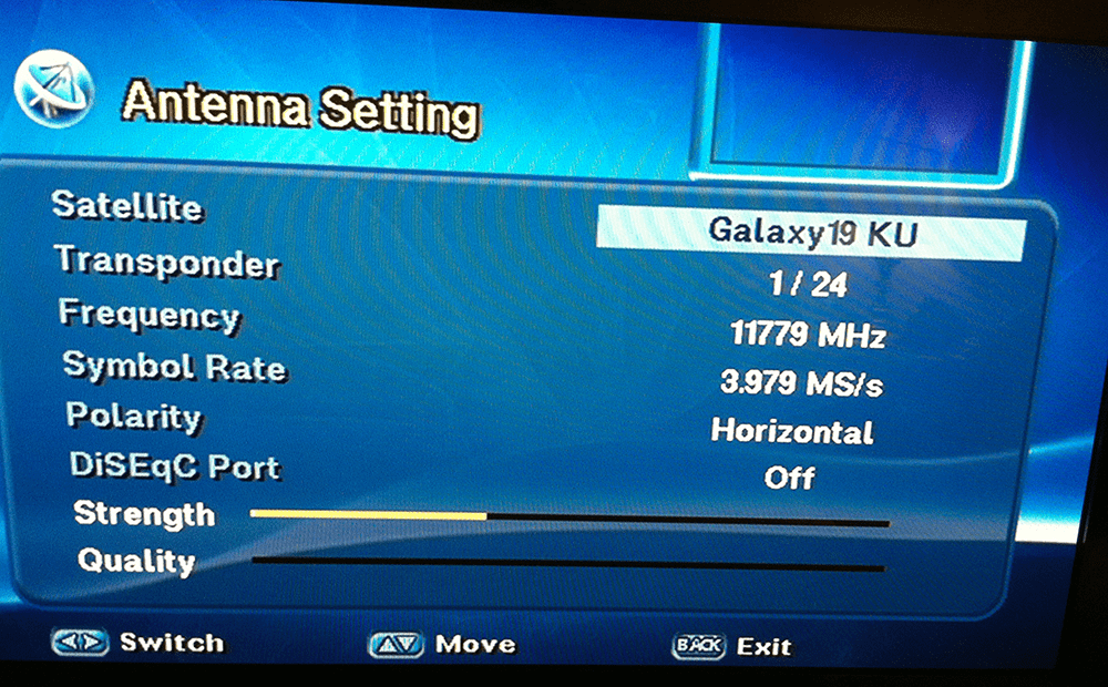

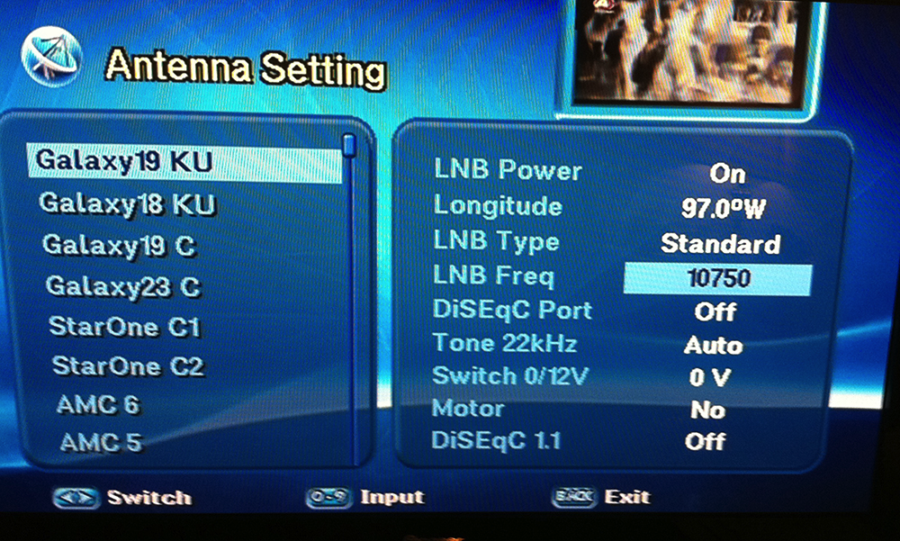

Thanks for the reply. The channel in question is ITN TV. They were originally at 12122. Then they announced that were now at 12022. So I went ahead and deleted their current location, hoping to do a manual or blind scan to add it again. But no luck sofar. It never shows up. I've done every possible thing: a manual scan between 12000 to 13000. And also a blind scan. At this point I'm wondering whether it has to do with the settings of Galaxy 19 KU. I've attached screenshots of my settings. Is there something I need to modify to be able to get ITN to show up under 12022? Appreciate the help.

In the last photo you show the Antenna Setting Menu screen. Highlight the 2nd line "Transponder" and use the Navigation arrow < > to select a different transponder. Press <or > until the 3rd line "Frequency" displays 12022 or 12023. Now look at the 4th line "Symbol Rate" is it displaying 22000? Does the 5th line "Polarity" display Vertical? If lines 3,4 and 5 are displaying correct parameters, look at the bottom Signal "Quality" reading. What percentage does it display? The "Quality" level likely needs to be above 45-50% to scan any new channels on this transponder. If the quality level reading is below 45-50 % either the dish is not aligned exactly, the LNBF skew (rotation) is not correct or the LNBF frequency is off.
Did you try the automatic (satellite blind scan) mode?
Are you getting any channels now on this satellite?? When changing the frequency selected, as Titanium indicated, do any of them show Quality? If so, list a few, that may indicate to us a setting that's incorrect.
