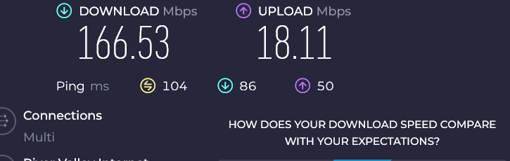

Up front, when I do a Speedtest.net or use the Xfinity speed check everything is within my speed range that I pay for.

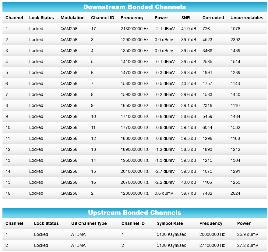

When I go into the modem status page I see all 32 down are locked but only one locked upstream. Adding to my confusion is that only 4 upstream channels show instead of 8??

Both my down and upload speeds exceed my plan speed by about 10% so on that point I'm happy. This is the upload even after pulling the plug on the router, waiting a few minutes and plugging it back in.
ChannelLock StatusUS Channel TypeChannel IDSymbol RateFrequencyPower
1 Locked ATDMA15120 kSym/s35.60 MHz39.50 dBmV
2--------4----16.30 MHz----
3--------3----22.80 MHz----
4--------2----29.20 MHz----

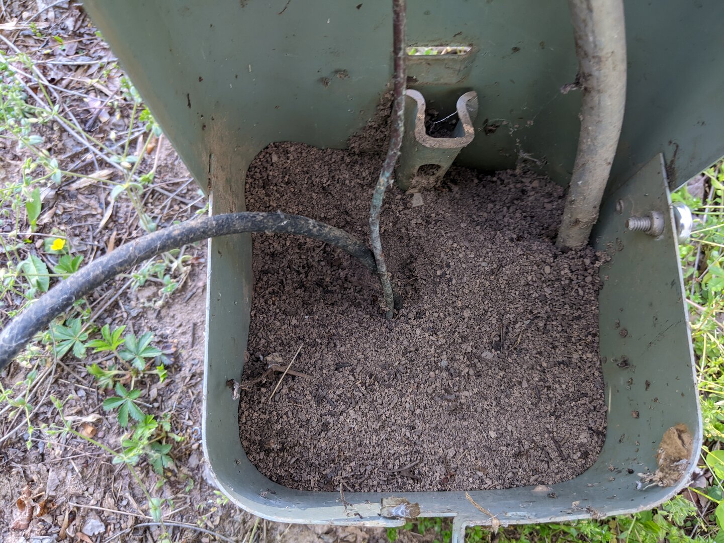

Since then I cleaned the connectors with alcohol. I decided to see was was in the outside cable box and found material in the bottom that reminds me of an ant hill which is easy to believe because I've been trying to kill any hills in the vicinity. Will ants chew through coax?

The first thing most any field tech will do is cut and splice in new connectors. Their field equipment would be able to test signal and dB of each u/d channel. For your cable pedestal to have ants and anthills in it is not uncommon.
As long as the cable jacket is good, you're good. Ants are nasty and love electricity for some reason.
If Comcast techs aren't willing to dig the crud out then you should and wipe the cable clean. Look for damage.
Or try dousing it with the hose and see if your signal goes south. Right?
One thing to look for also is in the modem management screen. After a reset. Look for uncorrectables that increment in huge amounts on one or more channels after a screen refresh (F5 or the reload icon).
If you see some channels steady and one or more incrementing in huge numbers. It could be the CMTS at the headend is flaky. I learned that from my higher lever cable engineer.
Mine would go 224, 700, 998, 1500, 1900, 2450, 2470, 3500. Just an example of course. Every time I refreshed my screen as often as I could. The tech saw it looking at the modem stats at the headend. Swapped a CMTS card in a rack and it was fixed. All day long and maybe 50 uncorrectables. Sorta'. Not 100% full of bs, but it's a good description
Crappy cable or coax connection will increment uncorrectables across all channels. Could be a bad line amplifier.
