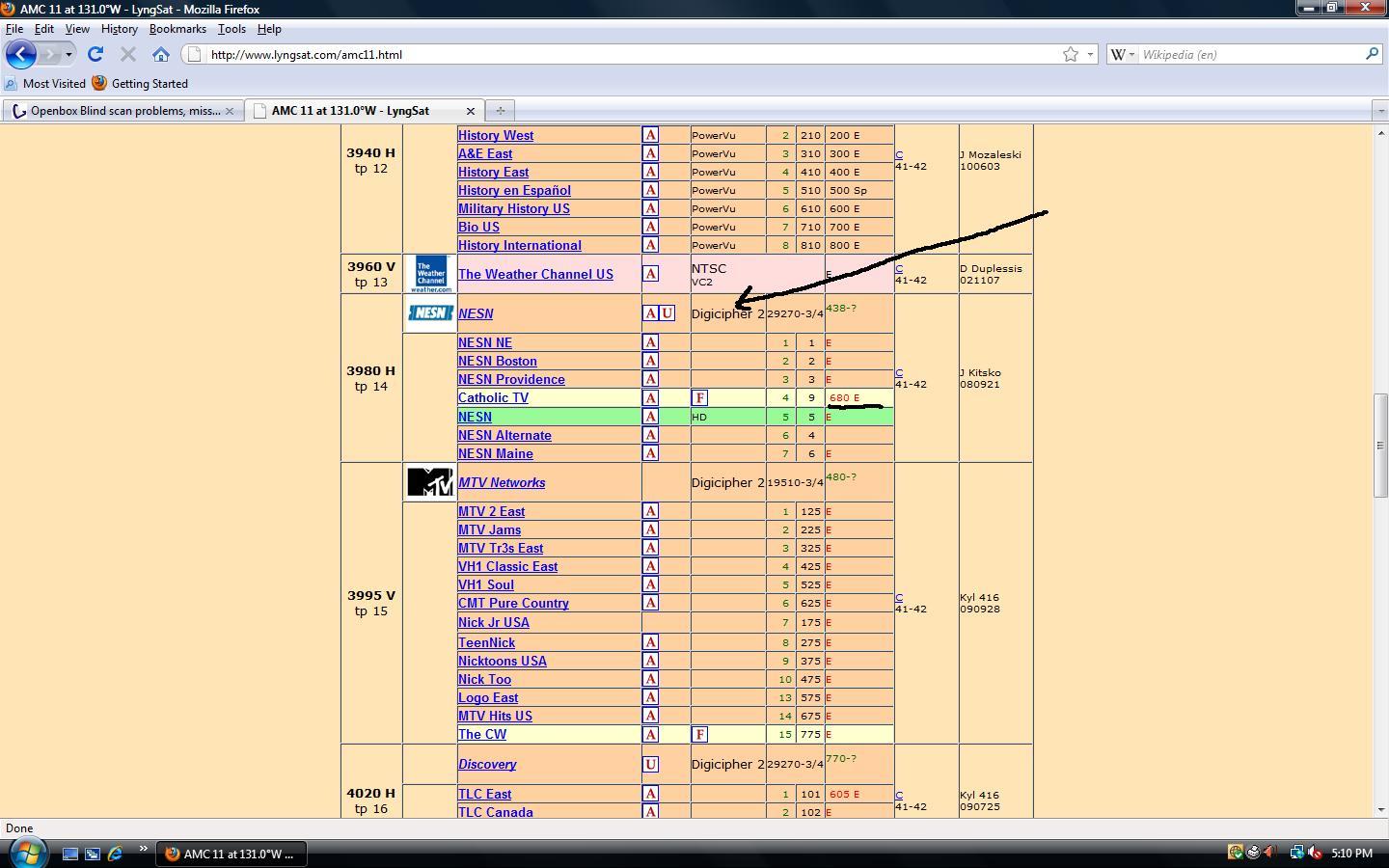

yes and no. You have to look at the 1st line of the transponder to see if its DVB or Digicipher II. In these cases they are DCII so the 4DTV can receive them. See attached thumbnail
now as for receiving those 2.....Catholic you should get. See the pic below. When looking at free or scrambled channels if there is a red number to the right that is the 4DTV channel. SO for Boston Catholic, you tune to 680. Now with the whole 4DTV thing going on right now I cant guarantee it is still there
As for the other, since there is no number it is not mapped in the 4DTV. This is where generics come into play. Here is a recent thread on how to get channels using generics (complete with links)
