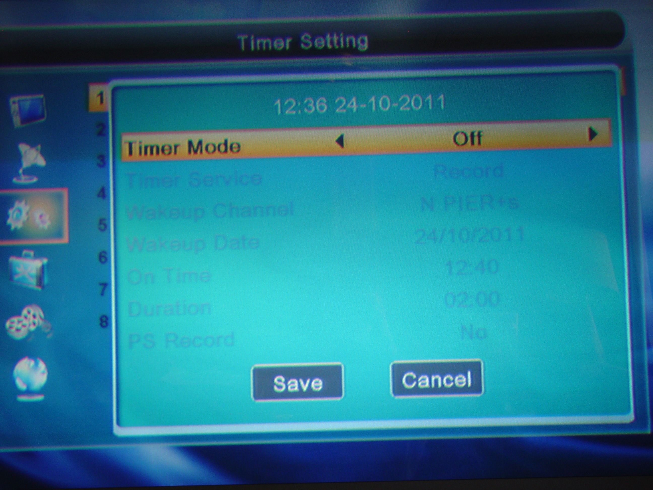

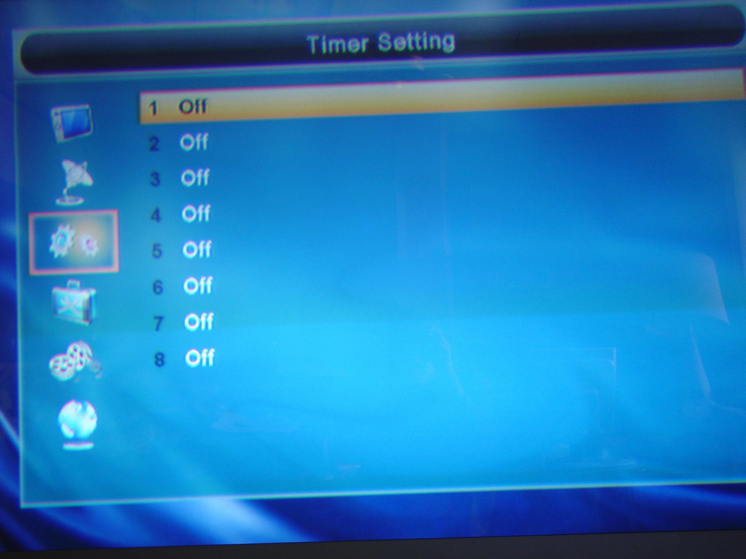

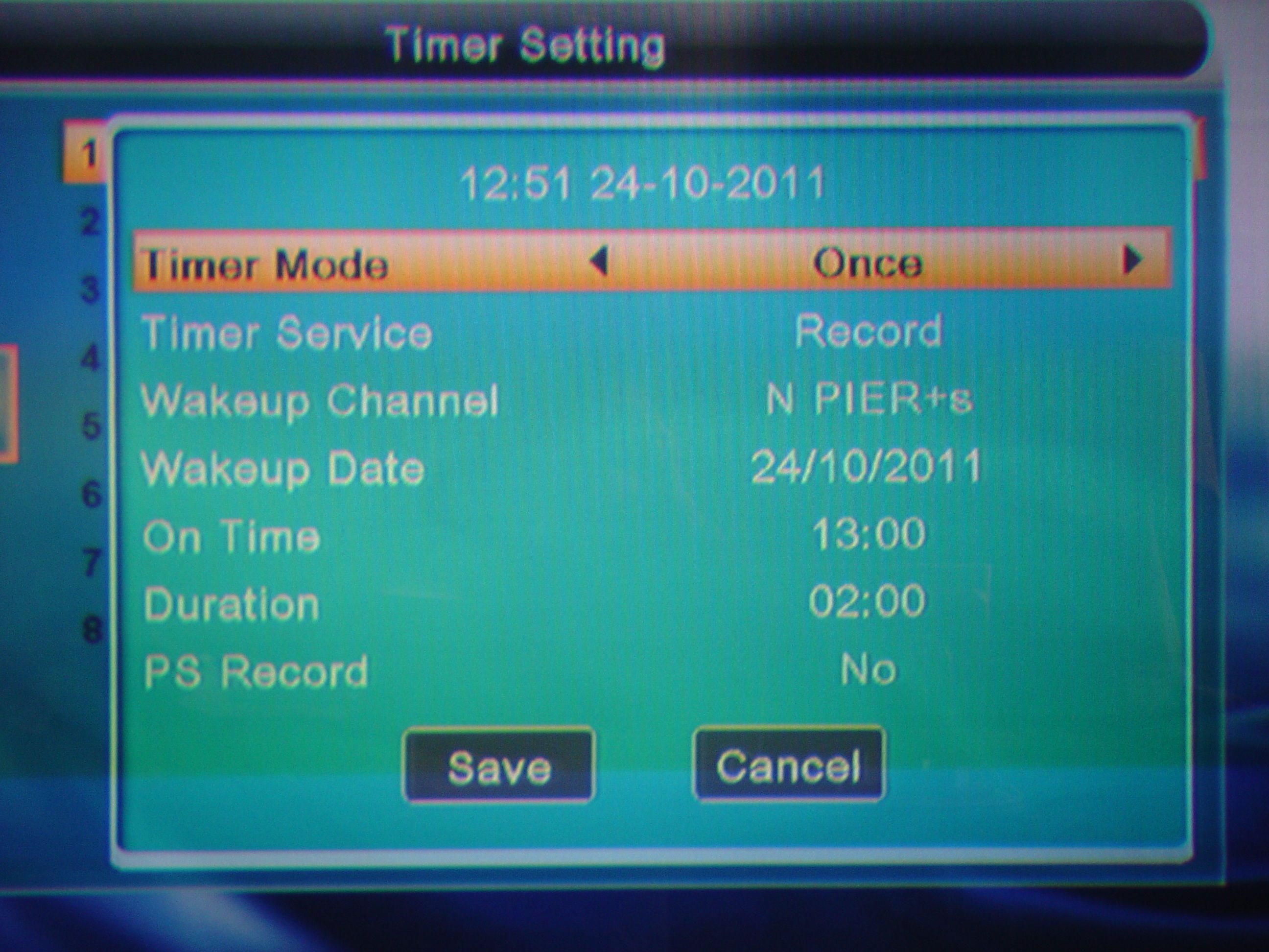

Press Menu
in system setup, highlite timer setting, press OK
You get the first screen picture. Press OK
You get the second screen pic. This screen has timer and date(backwards date)
press left or right arrow on remote - "once shows"
Third picture shows "timer service" This must say "record" To change press arrow.
The rest of the info explains itself mostly. Low quality of pictures from screen shots.

Ah Ha for me too, that fixed it!
Didn't know about that setting or how it got changed.
