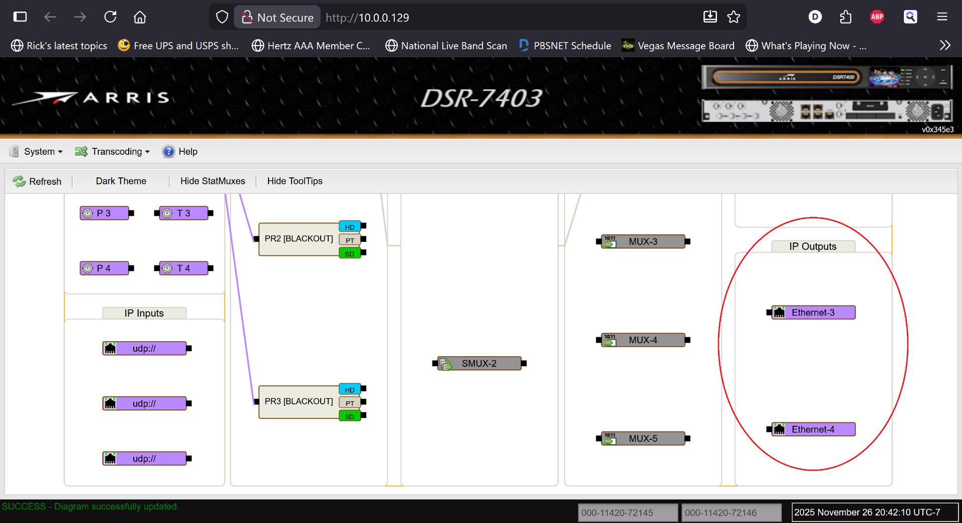

I've been using my Edision OS Mini 4K to record TS files, and it does a great job. The issue is it only has one tuner. I would like to be able to record TS files for both C and KU from the same receiver. I then use TSReader to anaylze the streams for bitrate and other modulation parameters, or just to save my recordings with the highest quality possible (ie no transcoding). I've been searching for an OS MIO+ with no success. Then it occurred to me...
I already have an Arris DSR-7403 and an Ericsson RX8200. Both have 4 tuners. Does anybody know if these receivers can record/output TS files? The Arris has ethernet outputs, but it's unclear to me how to utilize those.

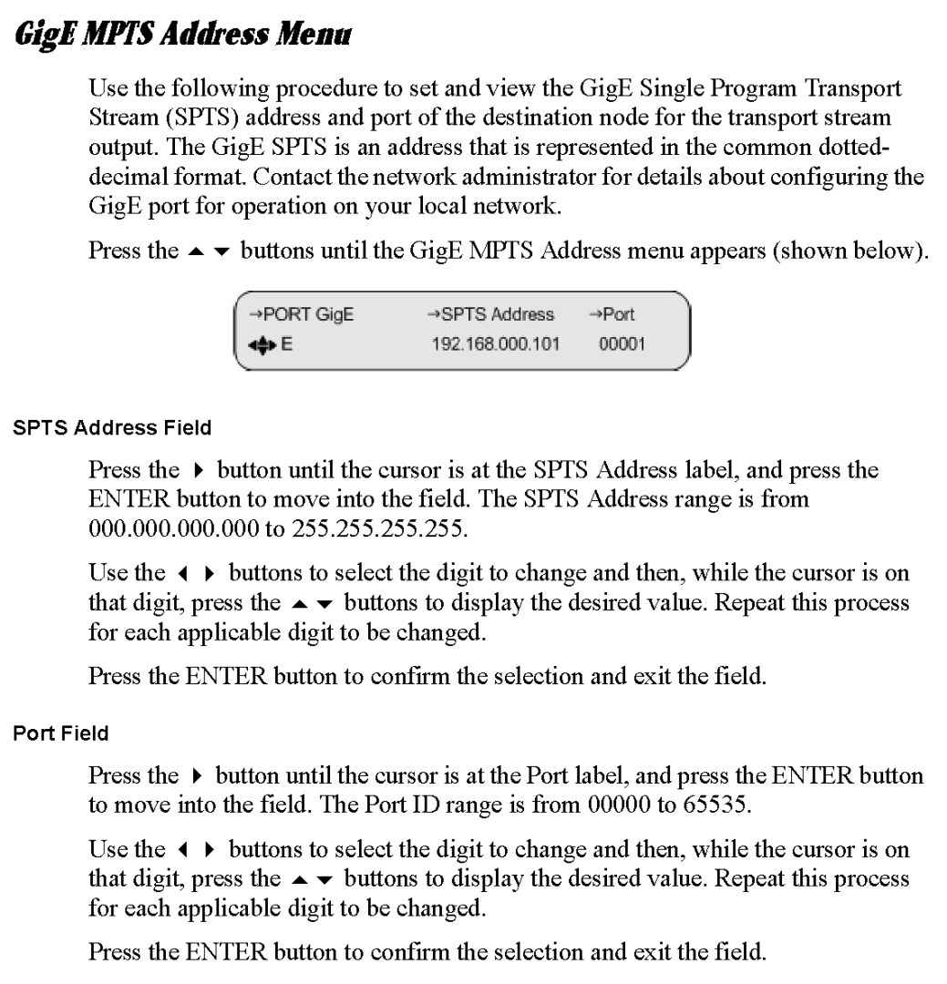

Probably not much help but zipping thru the dsr-7400 HD series op manual it looks like the gige port is industry standard and can be configured to send a ts stream. I don't know.
Have you gone through the gige menu to see if an output selection (asi, .ts) is available?
Yes I think it can, but where is it sending it and how do you access it?
Whew. Wish I had one to play with.
Looks like besides being able to set the LAN management interface like you show @ 10.0.0.129 you can set the GigE port IP for channel streaming.
Links for the DSR-7400 HD Series Operators Manual always take me to scribd. And I don't have a scribd acct so things get fuzzy (literally) fast. But. going back further to the DSR-6000 and DSR-4530 manuals step you thru the config menus.
Could it be if you setup the GigE menu to another IP on your lan in the same scope. And use VLC to tune into it....magic? I mean. Looks simple enough. VLC <IP Address>:Port. Mr. Smiley is supposed to be a colon IP<colon>port. An after the fact edit from me.....
Single Port Transport Stream.....sounds like a hint. Maybe the Ricks DSR guys could help?
Reactions: comfortably_numb
In a nutshell, it won't do what I want it to do, right?
The receiver will not record the stream.
The IP Output functions will package the stream into UDP packets and will put them into an IP multicast group on the wire. If TSReader can use an IP multicast input, you would use the same group information to configure TSR and you should be able to analyze in real-time and potentially record. (I have never used TSR, so I am out on a limb here.)
Commercial receivers are typically first-in, first-out devices with no storage features, beyond buffering a stream for a few seconds if transcoding.
That's ok, it doesn't need to record if I can capture the stream on the PC.

So the Arris is able to be connected TO by typing in 10.0.1.129 in a web browser.

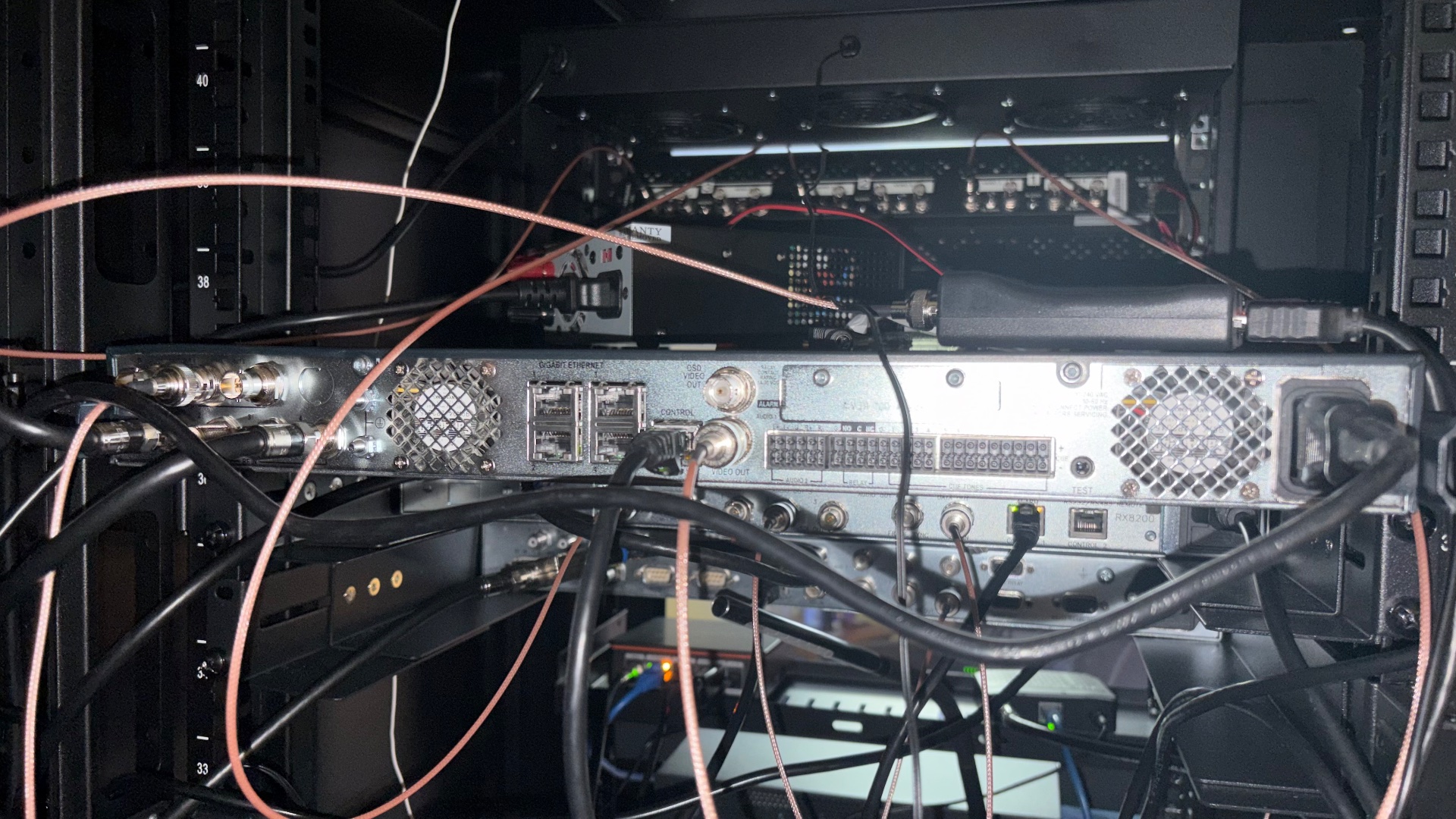

For anybody interested, here is the back of the Arris:

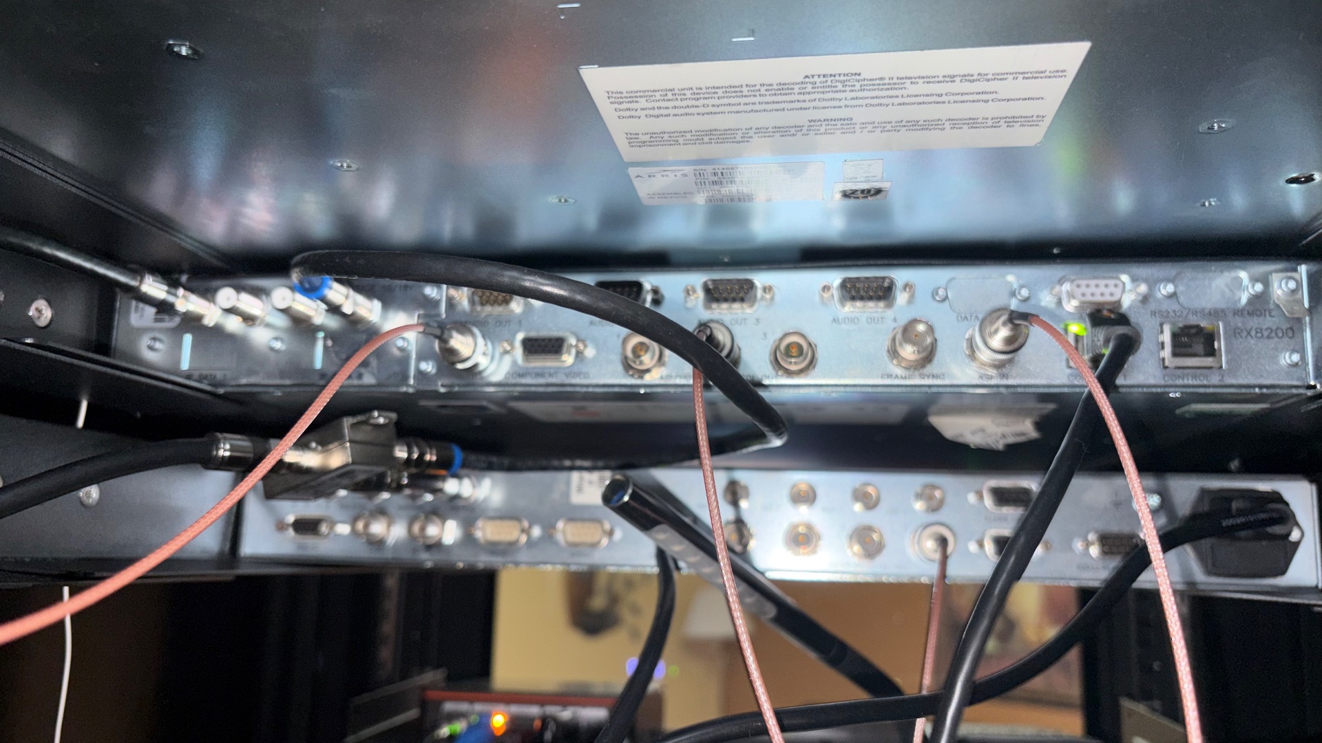

And the back of the Ericsson (below it is an old Tandberg receiver)

Comf. Yeah. You are correct. Your Arris management console IP allows configuration of its parameters and operation.
On the send side. In the Output Config. screen. Try what one_db said. I would have no idea how you would "tune into" the stream on a multicast address. But for gits and shiggles what if you set an IP in your scope that is something several octets different from the management console IP. And a known port. 8080 (common webcam port).

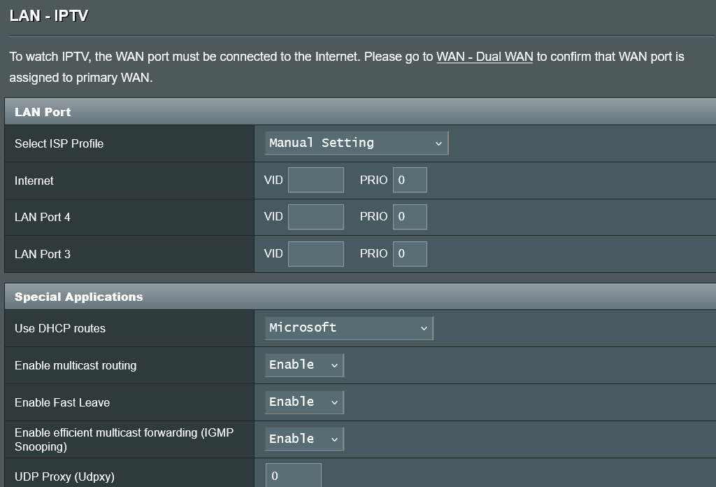

My Asus router has apparent multicast capability and settings for it. And an IPTV section that I have no clue how to use. Only because I never used it.

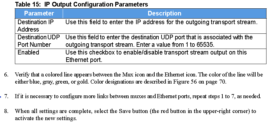

Page 53 of the Users Guide posted above clearly states "destination multicast IP address" in Figure 38.
Most firewalls/routers that have multicast support is exactly for supporting provider IPTV, which is really access into the provider's private multicast network via an internet last-mile. The majority will be running a piece of free code named igmpproxy or will implement similar IGMP proxying functionality on their own. GitHub - pali/igmpproxy: IGMP multicast routing daemon
igmpproxy is a clever piece of software, however it is typically used to participate in an existing multicast network on the WAN side and to help facilitate the inbound NAT of the multicast UDP packets and their retransmission on the LAN side. It may or may not be able to help in this case and the nerd knobs in the configuration file that I have on my BSD firewall will likely be unavailable in a GUI-driven consumer product.
