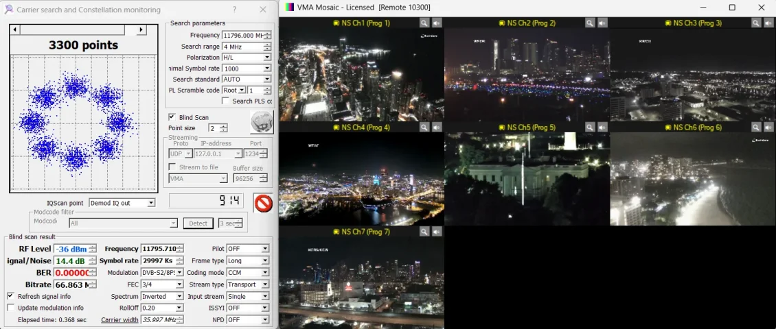

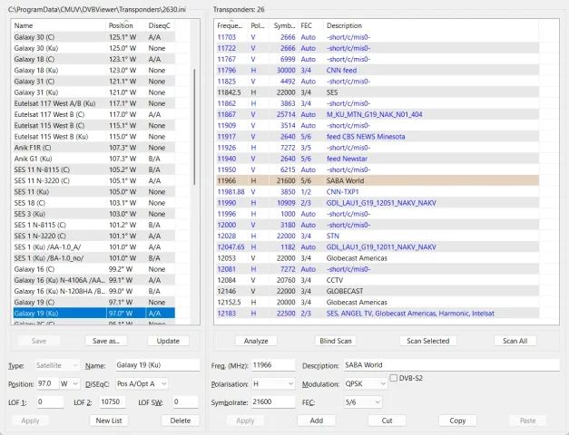

The CNN Newsource feeds on 97W Galaxy 19 are listed in Lyngsat on 11795 H 30000.

Hi, ok, I knew they were out there since I remember them moving over from the SES 2 sat. I was watching them before the foliage came in this past spring. Since moving the dish to another spot, I am able to get a good signal, not the best, yet, but 68 channels worth but cannot receive them 7 channels I use to get, then news feeds that came up once in a while, unless it's still my quality of signal still until all the leaves come down. I have that transponder in the unit, but not a spec of signal from it. Far as the signal readings between different receivers, both of these are the same vendor. When I, some time back, compared between my HELLO and GTMedia units, both were pretty close in levels. Between these 2 new KOQIP units, big difference. Thanks

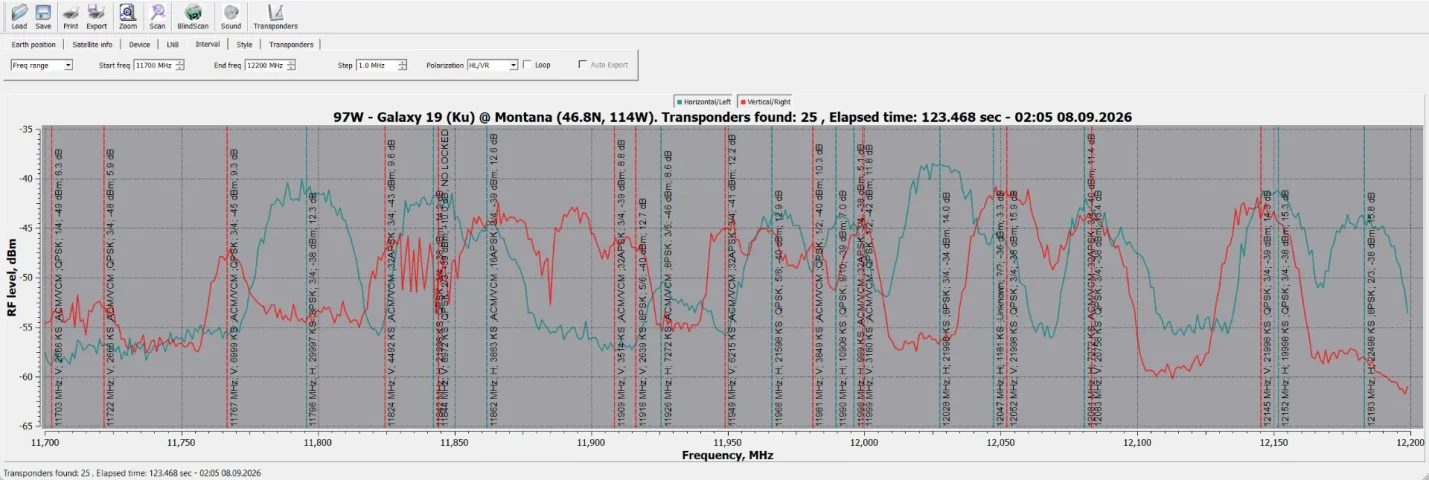

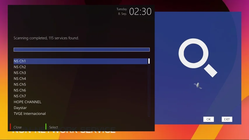

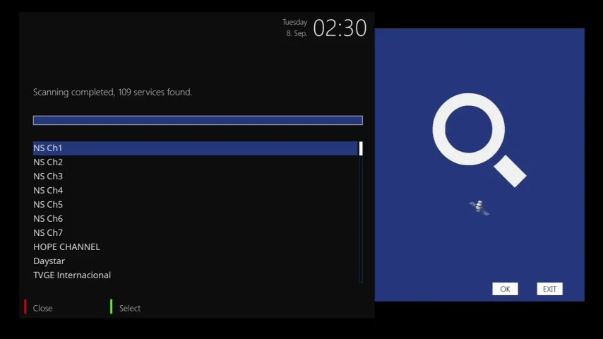

I scanned 97W just now and it resulted in 109 channels total with about 86 TV and 23 radio. Some channels scan in more than once from the same or a different transponder. Quality numbers range from about 10 dB up to about 13 dB. The CNN Newsource channels are the lowest quality. So it could just be your foliage getting in the way.

Currently, 25 DVB transponders have been found. Some are unlocked, they may be DSS or DC.
Tuner Si2166 without ShortFrameFEC support
Tuner AVL6261 with ShortFrameFEC support
