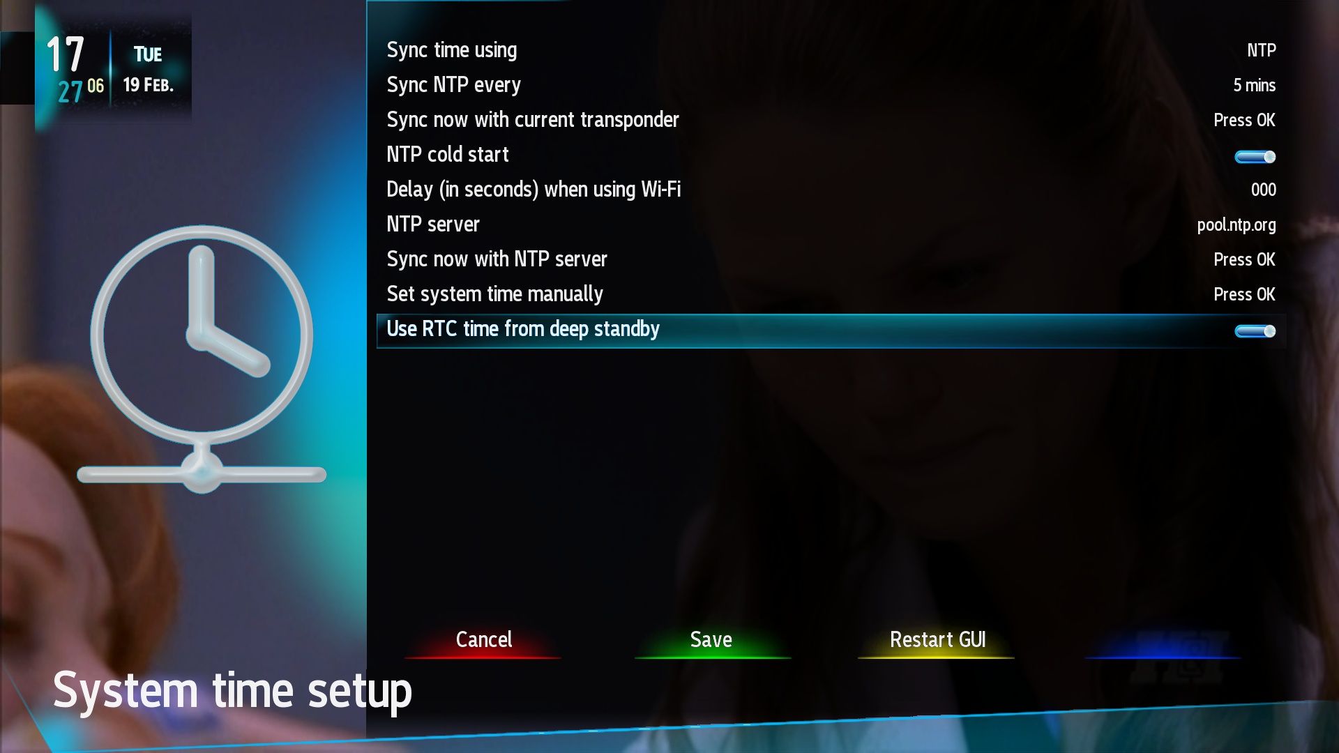

AFTER you multiboot back to the image the timers were set it (NA SatDreamGr in my case), the dates on the timers change to the year 2068!
Not only that, but you can't fix them. You have to create new ones, and delete the now bad older ones.
I understand from your posting on another forum that this was a menu setting? Could you share the menu setting that provides correct DVR timer date and time when using multiboot?
Reactions: primestar31
I understand from your posting on another forum that this was a menu setting? Could you share the setting that provided correct DVR date and time when using multiboot?
Yep, haven't had a chance as of yet to update this thread. I wanted to make sure the fix survived all my testing, and it has.
Basically, IF you have the "System Time" plugin installed to let your receiver ONLY get its time from an internet NTP server (should be nearly all of us here in the states), you must also go into its settings, and turn ON these settings:
1: "NTP cold start" (default is OFF)
2: "Use RTC time from deep standby" (default is OFF)
OpenVIX does not have those settings (maybe it assumes them?), but SatDreamGr and OpenPli 7.0 do
So, in NA SDGr image, hit MENU, Setup, System, System Time, flip those two settings to the right (so they look blue), then hit the Green button to SAVE. Then just back completely out.
P.S. I also have the "Sync NTP every" setting set to "30 minutes", as it seems to work best. My receiver is hardwired to my router.
I have also learned that IF I've done a Reboot a few times for whatever reason, I need to manually resync to the NTP server, otherwise it drifts nearly immediately a little bit just from that. Of course it would fix itself when it gets to the "30 minutes" time to auto-resync, but in my case, I might have a timer set to fire before then.
