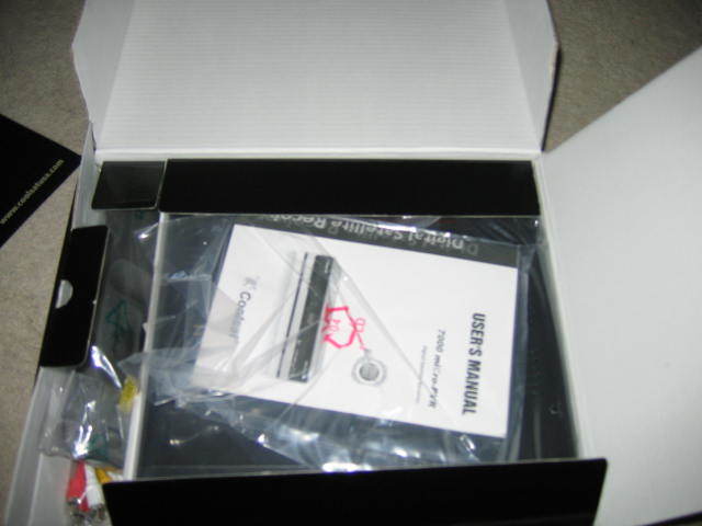

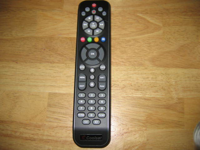

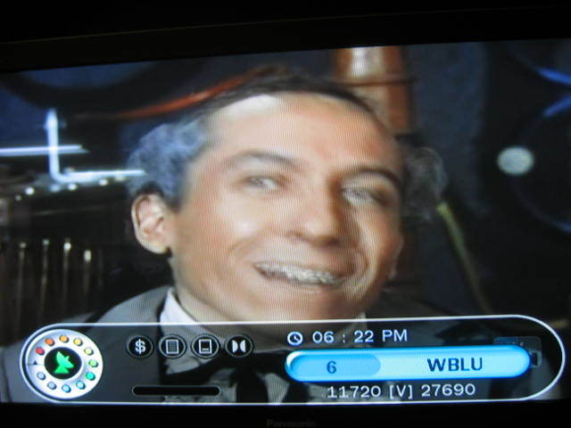

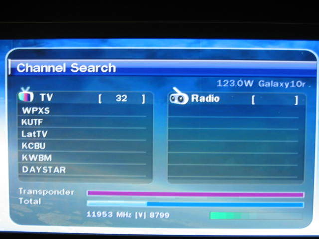

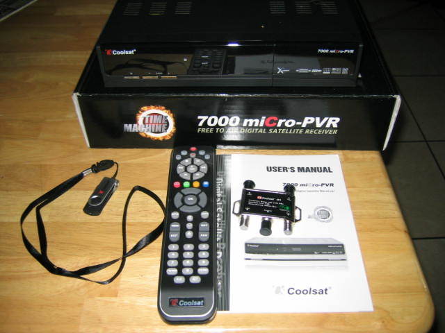

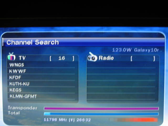

For all of you that are waiting,here's some pics I snapped yesterday, I have ID'd at least one other niggling issue...audio. Audio only channels are very flaky. Sometimes they won't come in at all. I am on 119, sometimes it will just sit there, no audio, then bam comes right in. :confused:
Well, lemme go aim that dish, here's the pics.

do you like the feel of this coolsat or does it give you a feeling of another box (maker altogether). The older coolsats seemed easy to navigate through the menu system.
Totally different. Only thing that is remotely (har har :rolleyes: ) similar IS the remote. ;)
Blindscan works different, setup is different, everything is different. And its too new for me to say if it is better or not. That will take some time. :)
I just got back from aligning my friend's D* dish, so I am settled in here, I only have one sat stored on the motor so off I go to store the rest of the arc. If you don't hear from me, it went smoothly.:up
Ice, I think I owe you and Coolsat/Visionsat an apology. I think I had my Latitude and Longitude set up wrong...USALS on the 7000 is bang on. I need to go check the Visionsat now...:)
Other issues with the 7000:
1) Hangs with 4:2:2 AND HD feeds. If you have a sat stored like Anik that only has 4:2:2 feeds better not try it, I had to reboot three times before getting it changed. They need to change this pronto.
2) Seems to be very belated with the disecq switching when moving the dish. Sometimes you have to change the channel three or four times once the dish stops moving before the switch switches and you get signal.
3) Listen to Brother Ice, change the blind scan frequencies and the blind scan works MUCH faster.
I see on the Coolsat site there is a 1.05 firmware posted, my box has 1.01 I think, so there's something that might fix some problems. I am gonna load that up tomorrow.

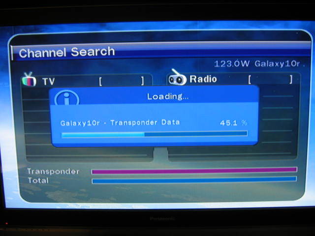

1.05 is a MESS!
it changed the interface entirely. Still pretty easy to get around in the menus, though, USALS is still pretty much bang on, blind scan is just okay, it wouldn't BS KUIL or ONN, I had to manual scan those.
BUT, this firmware completely broke the disecq switching. Take the switch out, box works 100 percent. Put it in, it works maybe 10 percent of the time. Maddening. Have to turn it off with the switch on the back to get it to reset. Then it may work, may not. I guess I need to get a couple 22khz switches to run my little dish for 119 music. Because this thing is gonna drive me NUTS!
If anyone wants to see pics of the new interface with 1.05, post back and I'll take some.:)
