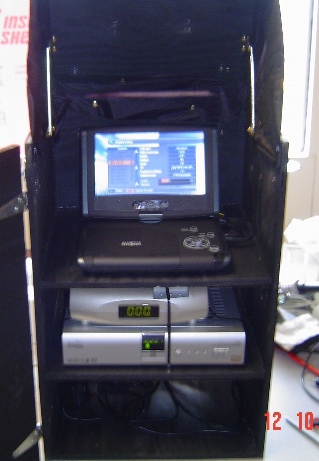

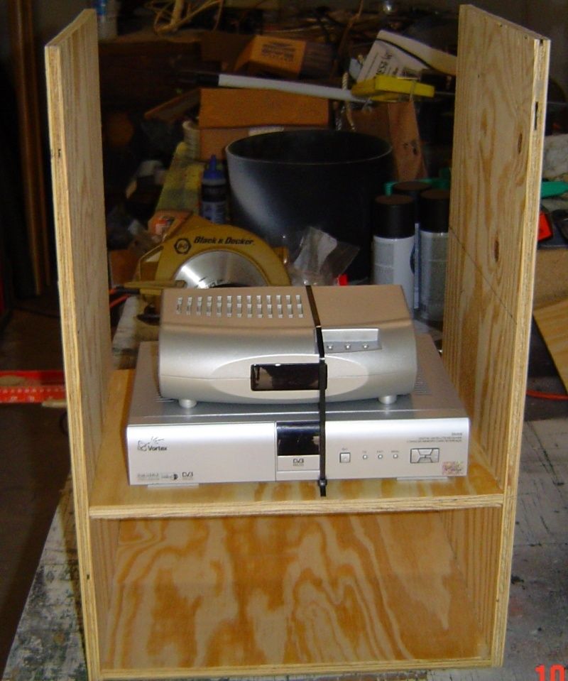

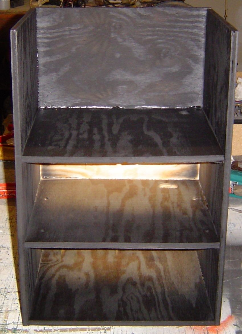

Below are the pics of the finished Linuxman Satellite tuner.
Here are the specs so far:
Very sensitive tuner with stable meter for peaking the dish. (Used Vortex 3500)
Will move a big dish with linear actuator or H-H gear driven motor. (New VBox V which replaced my VBox III which I sent in for warranty work) Thanks DMSI!
Will move a diseqc motor with 1.2 or USALS.
Will control a servo motor on a Co-Rotor or Polarotor.
Has blind-scan built in.
Has an 8.5" color LED screen complete with audio that displays for 4 hours with it's own battery. (Got an open box Insignia for $110.00 at BB)
Will have a UPS, or inverter/battery combination once I figure out which way to go.

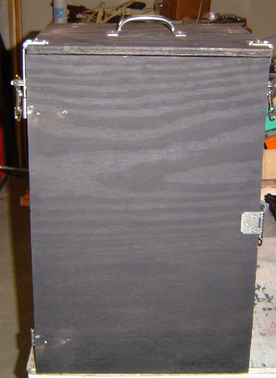

It is 14-3/4" wide X 12.5" deep X 22" high with 6" of clearance in the bottom two compartments, and almost 8" of clearance between the top shelf and the top lid.

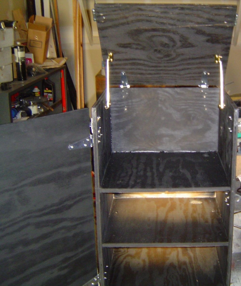

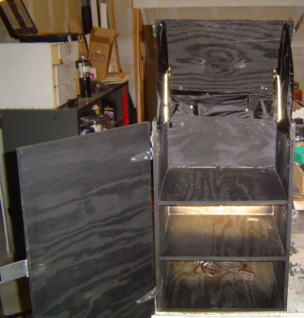

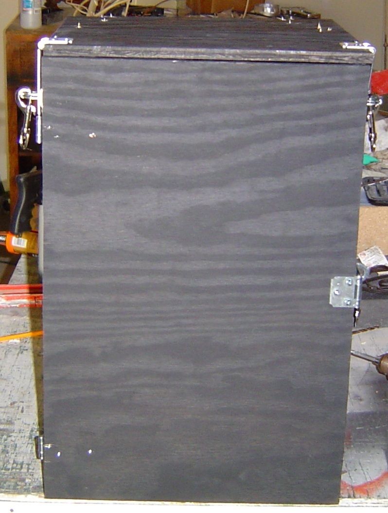

Adjustable fold out lid with side supports along with black shading to keep light off the monitor. (used a broken umbrella for the shade material) Hinged front door. All secured with folding locks to make it safe to carry with equipment inside.
All in all, I think it will serve my purposes very well. Here are the pics:

What's the bare box weigh? And you're going to put a lead battery in there, too?

It is an Insignia 8.5" DVD player with A/V input from an outside source. Seems to be working well. Has a source input button, so I could watch a DVD while waiting on a scan, or whatever.
Probably will not use the battery as indicated above. :)
Just grabbed the digital bathroom scales. It says it weighs 31.5 pounds with all the equipment and cables attached. Once it is on the roof, it will be sitting on a bucket. :D

It really is not much more than my laptop bag with all the electronics in it, then the bucket with the cables separately.

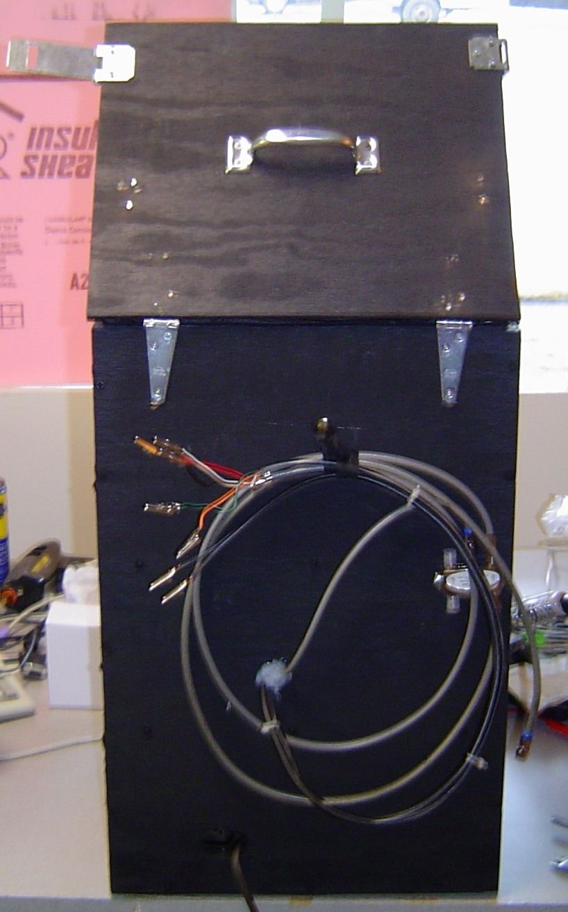

The great thing about this box, is that all that has to be hooked is the ends to the dish.
I have terminal strips on all my C-Band dishes for alligator clip hook-up. :)
