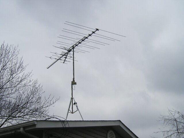

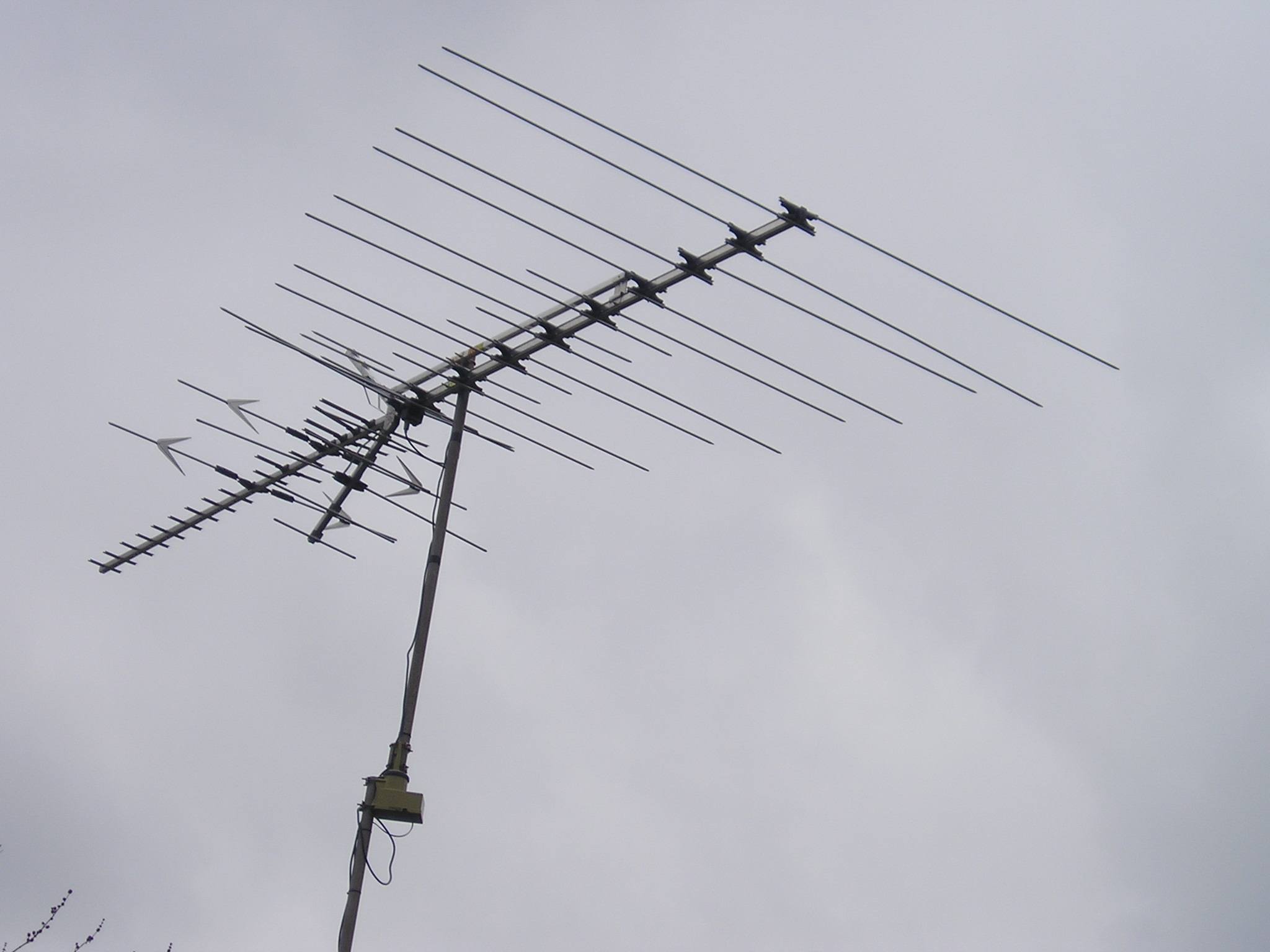

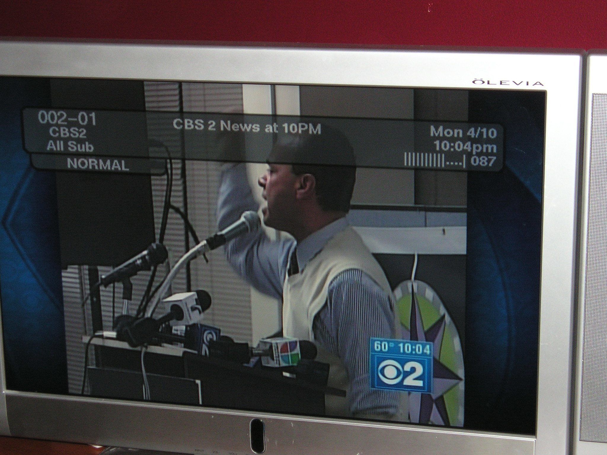

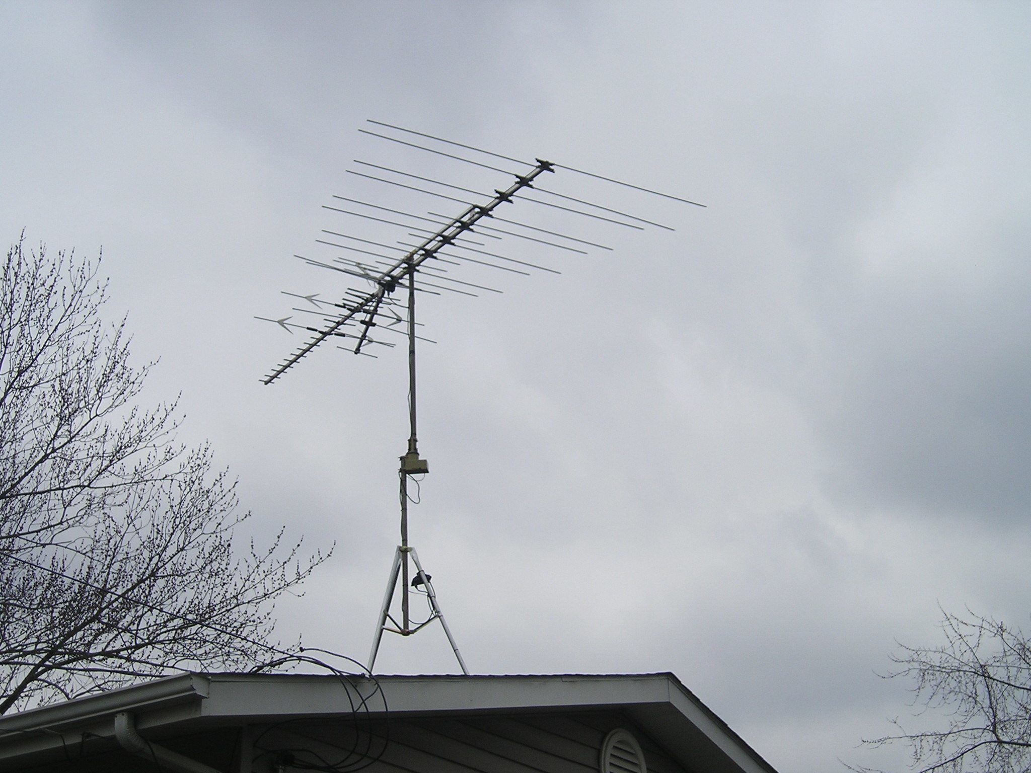

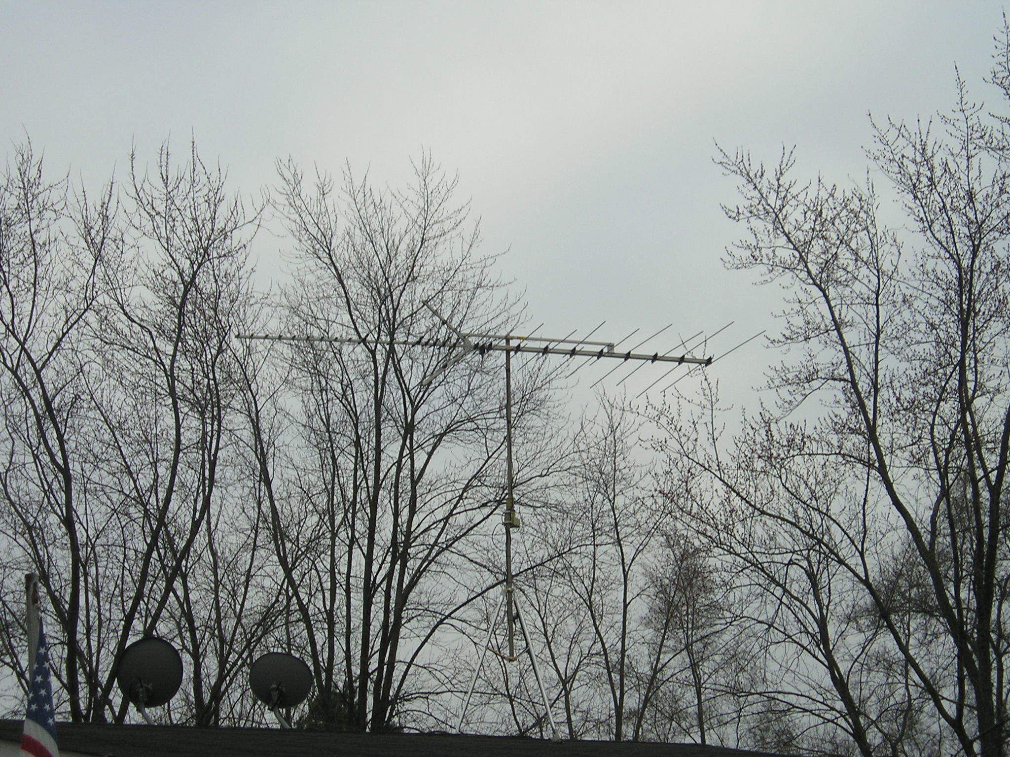

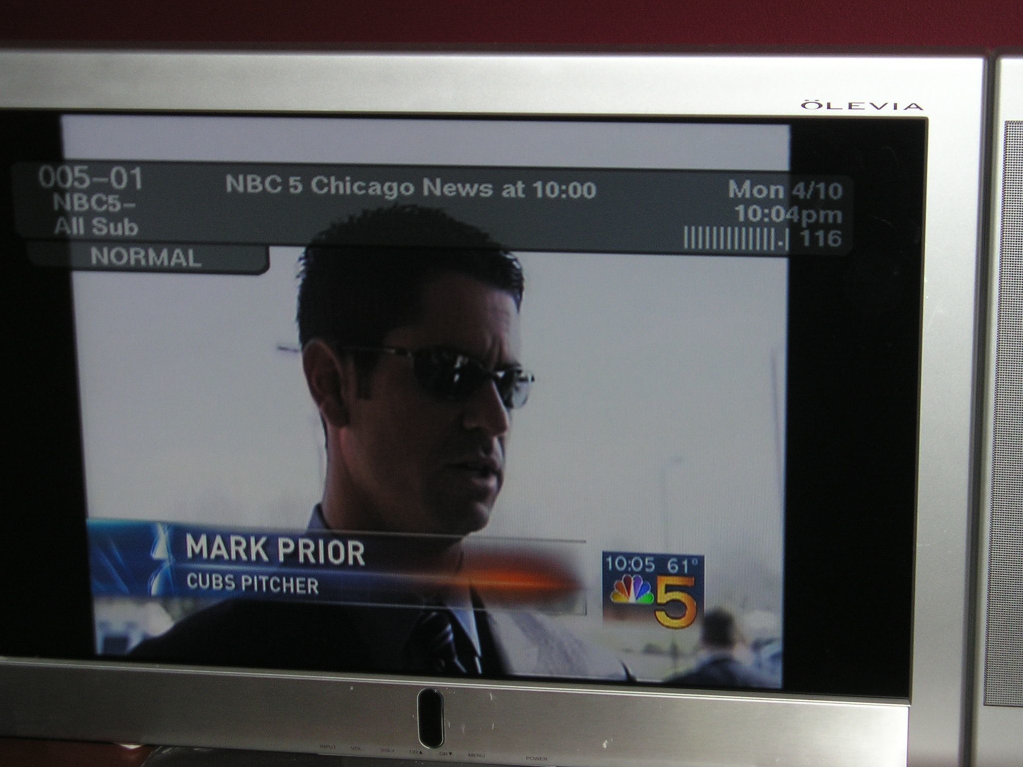

I am in Plano, IL 55 miles of Chicago and I recomenc to all HDTV'rs To get the Winegard HD8200p works Great!!! I also have the AP8275 Preamp with it as well.
Works Great Here is the pic of the antenna and a screen shot of Ch2 Digital off my 921..

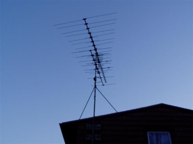

Ditto...as my original recommendation, here is a picture of my beautiful hd8200p
