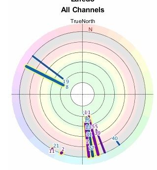

Using 78045 for Laredo on TVfool ch 27 KXOF(39.1) is 1 edge which indicates possible obstruction of signal. What are you using for an antenna?

Why are you aiming N? Zip 78045 from TV fool shows only ch 20 KPXL to the north virtually all other channels are south or slightly east of south by the zip code.

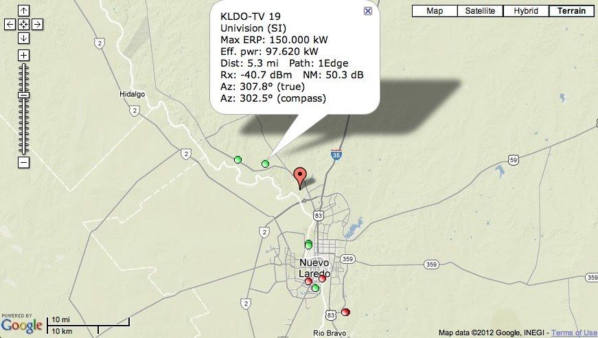

I am aiming south-Southeast. the zip code "78045" is too general and actually pinpoints an area well north of my house. There are two stations to my northwest. 8-KGNS and 19 KLDO. 8-KGNS comes in just fine. After all of this, I am not sure I even have a problem, however, Its been coming in perfect all day after blocking for the past 4 days. I guess I will try adjusting the antenna if the problem starts again.
BTW, if you haven't noticed, I love crazy close to Mexico...you should see some of the crazy stations coming out of that country.
Good Luck. Yes having the actual address plot vs. the zip code plot does make a difference. Zip code shows 19 south of the zip center actual plot is north of your location. You should still be able to aim south and pick up 19 & 8 off the back side..
