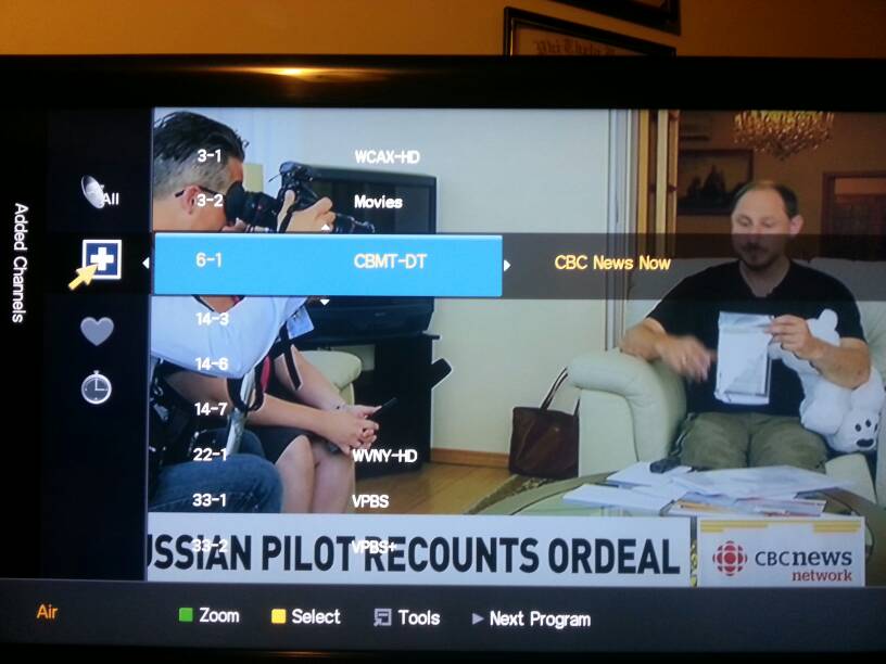

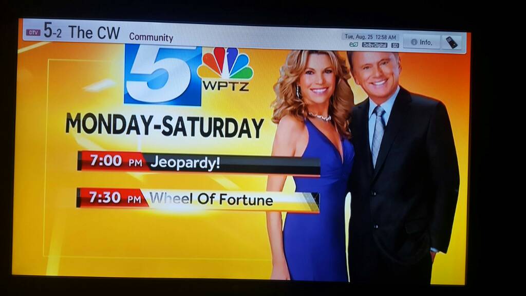

This could be part of the problem. WPTZ is showing the rf channel (14-3, 14-4, 14-5) in the "guide" not PSIP. Surfing thorugh, it shows on 5-1, 5-2, etc. But not here. Signal is 91% on the AM21 and around 70/100 on the LG TV tuner. Samsung, shown, doesn't have any sort of signal analysis. What would be the best way to word an email to WPTZ?

Update: I never heard back from WPTZ, but today when I checked, they are on PSIP channels (5 not 14) and there is guide data.
