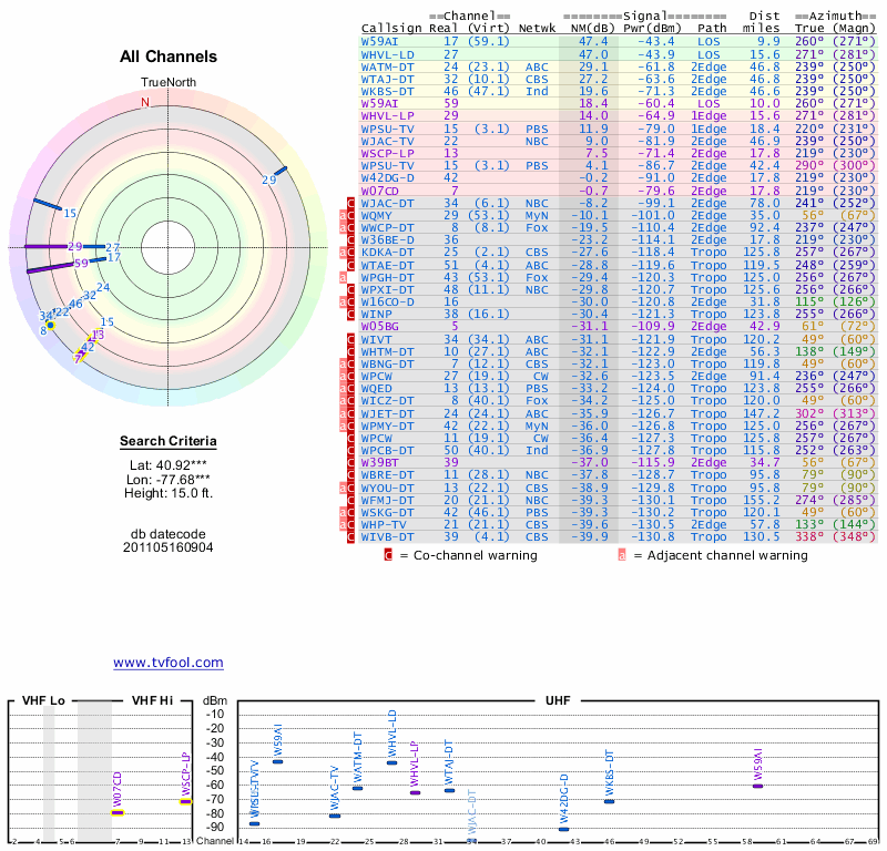

Hi all,
I have a channelmaster 4228HD with channelmaster 7777 preamp, located indoors on a second floor (about 15 foot above ground). I have been trying to get channel 15, listed on my tvfool report (coincidently, there are two channel 15s on the report, I am trying to pick either one, but I figured the one coming from magnetic azimuth 231 degrees would be easiest) Radar-All.png
but I can't seem to get it, which is frustrating. Does anybody have any suggestions, maybe on what type of antenna I should be using in place of my bowtie antenna? I can't move the antenna outside. Thanks in advance for the help!
The key to your dilemma is "can't move the antenna outside," combined with the weak signal-strength figures for WPSU in the dB (NM) – aka decibels above noise margin – column of the TVFool report. Most viewers with antennas mounted within their attics (and I am one of them) report that reception typically starts getting sketchy once signals drop below roughly 20-25 db NM. This is especially true of signals obstructed by hills/ridges (the "1 edge" and "2 edge" notations in the Path column). Ten decibels below "sketchy" is 10 times weaker than the consensus threshold. You have my condolences, but no antenna and no amount of amplification can overcome the handicap of an indoor installation in a situation like this. Until the 4228 can be mounted as high above the roof as possible, you can pretty much forget about receiving WPSU reliably.

WPSU is actually operating two transmitters on channel 15. In your location they interfere with each other. To pick up the strongest station, you need an antenna that nulls the second channel 15 transmitter by 15-20 db. By itself, a properly aimed 4228 has side lobes that are roughly 15 db below the main lobe. Channel Master 4228 The problem is that the attic scatters the signals and recreates side lobes even when the antenna by itself has sufficient rejection. This assumes side lobe performance of the 4228HD that matches the well documented 4228, but that's a bad assumption. Temporary page
For this reason I feel that there is no antenna for an attic installation that can be predicted to pick up WPSU. That said, there may be a location in your attic that does not add any side lobes in the direction of the weaker WPSU. That could be behind a chimney, or even a man made shield such as a large piece (4' x 8') of chicken wire configured to block the signals from WPSU's weaker transmitter.
On the roof the 4228HD is not the best choice. Consider a 91XG instead. It has a much tighter pattern.
WPSU has a special setup with a high power transmitter near Clearfield and a lower powered one near State College on the same channel. Unfortunately for you the lower powered one is more visible than the main transmitter. The biggest thing is to get the antenna close to a window facing either transmitter and if the window has a metal screen it should be removed. Also this antenna has a decent beamwidth so any large metal object infront of or off center on either side could reflect the signal back into your antenna and cause multipath interference.

Thanks for the help guys! A multipath/interference scenario never occured to me. Actually, the antenna isn't mounted in a roof-its in a corner of a room where there are two windows. One window faces approximately west and the other south, and I have the antenna aimed at the low power tower out the south facing window.
Bob2011-I pick up channels 22, 24, 27, 29, 32 and 46 listed on my tvfool. Channel 22 is farther away and comes in really well (it's never dropped out), and that's why I can't figure out why 15 isn't coming in. I also pick up channels 7 and 13 with my C5 VHF antenna if that helps. Thanks again guys.

Well that shows your antenna is doing fine but probably confirms that the station has signal issues in your area.
