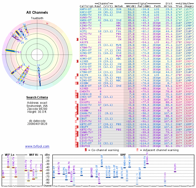

I have installed a Channelmaster 3018 antenna with new RG-6 coax, outside at approx 30ft. I am getting all my locals, except KING-5, which is digital-48. I talked to the enginnering department & found out their transmitter site is 1000 ft from Komo-4 & Kiro-7. He also informed me they share the same tower with Kong-16, which is coming in with 50% signal strength. I manually enter both 5 & 48 & get the weak signal message. I am wanting to get your input on this situation if possible.

No Doubt, Find your DMA antenna farm location do a channel scan, next find the lowest station signal output from that antenna farm set your antenna to that lower powered station for the highest signal. your done. enjoy!
If you want more accurate multiple DMAs its better to get an antenna rotor.
