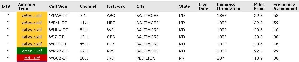

Thanks guys. First, When I first bought the terk( which I will never do again), I mounted it without the pre- amp. There were so many channels I could not get, I bought the pre- amp and it made a world of difference. Secondly, I went to "antenna web" as was suggested by "Jim5506" and it shows that I need a "Medium directional antenna with a pre-amp". Will do some searching on my own for one, but if anyone has any suggestions, please feel free.http://www.antennaweb.org/aw/Stations.aspx
Thank you all again for your help
All just at 30 miles of the zip code and all UHF; all but 2 channels, PBS and IND are located at 188° heading. Maybe the antenna is not properly aimed or it is the multi-path issue. I would certainly look into a quality anytenna mounted outside on the roof or on the chimney. An omi-directional if you want to attempt to get them all without the need to rotate the antenna; or a uni-directional if you do not care about the PBS or IND channel.

Do you have ANY interest in WMPB-DT PBS @ 205° or WGCB-DT IND @ 38° ? All the others are at 188° and that will go a long way in determining your correct needs. If you don't want those, then the uni-directional is all you would need.
I would try something like these uni-directionals below (no special order) WITHOUT the amp. You can aim these at 188° to receive all you major networks, and if you wish, attach a rotor to aim to the other headings.
