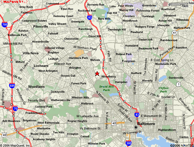

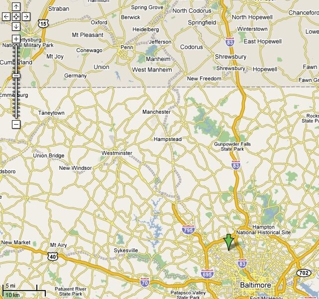

30 miles and 188° from 17361 (nearly due South) GET A $12 compass; thats as easy and non-fancy as it can ever get! Everyone should have one or two anyway. Kind of like a flashlight.

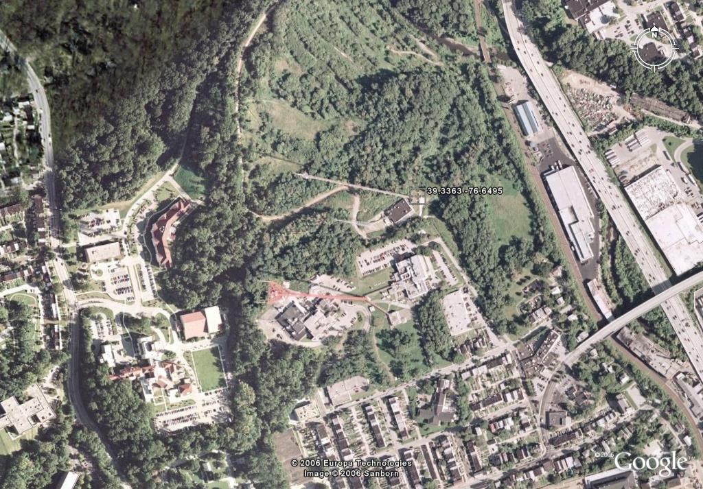

All the Google searches and plotting is way over the top, too much and un-needed confusion for the everyday user just to perform the simple correct aiming of an OTA antenna. All the needed info is located in the FCC Query tools. However, all the towers are just outside Woodberry, ME at:
39° 20' 10.68" N Latitude
76° 38' 58.20" W Longitude
or for Google World location field: 39.3363 -76.6495
or
compass heading 188° of said start location. Narrowing it down to his exact Shewsbury, PA address, some 30 miles away, will not change the result enough to alter the aiming.
