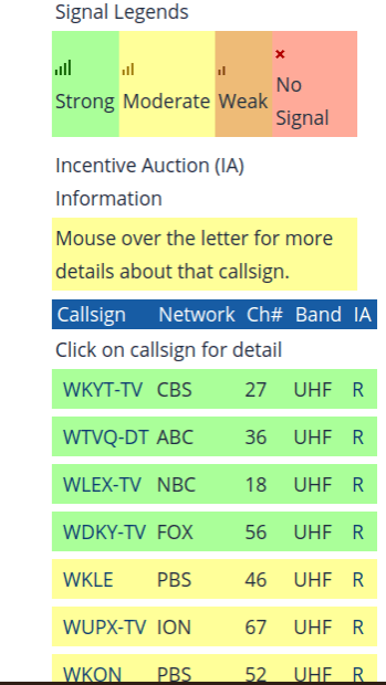

Your antenna is inadequate, especially in the attic. You have to have good strong signals since adapters don't perform as well as a straight connection to a TV usually. You need more than just enough for a picture, you want a healthy fade margin to assure all stations come in, all the time. All of your possible stations are UHF, there are better antennas that could fit in the attic may need a preamp also. Outdoors is far better, don't worry about weather they are designed to work out there. The assumption that the antenna will not receive HD is not correct there is no such thing as digital or HD antennas as others mentioned. What did you order? Here is a report for your town in your sig. RabbitEars.Info

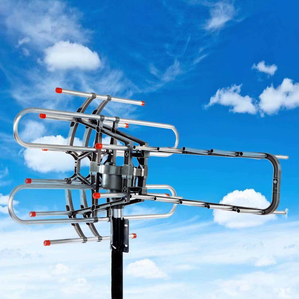

So, I have decided to replace the current antenna with a newer one under the roof. A friend here suggested a brand.
Leadzm TA-851B 360°Rotation UV Dual Frequency 45-860MHz 22-38dB Open Antenna Silver
I ordered it on ebay. (less than $20 with tax and free S&H). Here's the details:

I don't know much about all the details, to be honest. Just hoping that it will work. I am not expecting dozens of free channels. If I get couple, I will be happy.
