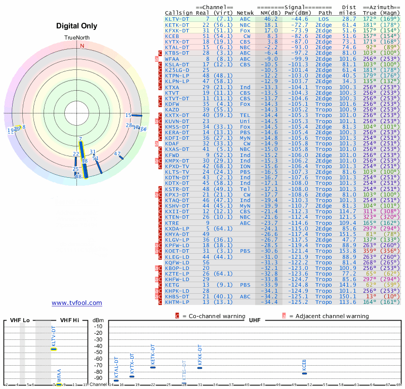

Please take a look at this tvfool report and tell me if getting OTA in HD via antenna is a lost cause?
The antenna would be on our roof and I want to say it would be 10-15 feet off the ground.
All I care about are the 4 big Tyler locals in HD
TYLER ABC-KLTV
TYLER CBS-KYTX
TYLER FOX-KFXK
TYLER NBC-KETK

It looks like they would be easy to get with a standard large antenna (like they sell at lowes or home depot).
Green An indoor "set-top" antenna is probably sufficient to pick up these channels
Yellow An attic-mounted antenna is probably needed to pick up channels at this level and above
Red A roof-mounted antenna is probably needed to pick up channels at this level and above
Grey These channels are very weak and will most likely require extreme measures to try and pick them up
KYTX is the only one on your list in read indicating a roof mounted antenna needed.

I would not recommend either of these antennas, they both have the wide elements needed for VHF-LO, which you do not require. You do however need an antenna capable of VHF-HI as your ABC station is on channel 7, so the UHF only U-4000 is also not a good choice.
Both Antennacraft and Winegard make channel 7-9 antennas that should work good for you.
At 51 - 73 miles you are fringe and deep fringe at 2edge for most of your channels, so the second largest or largest antenna would likely work best. Antennacraft HUB44, HUB55 or Winegard HD7697P or HD7698P. All are available from Solid Signal with the Antennacraft being cheaper, but people report the Winegard are better built with the performance being similar. The Antennacraft are also available from Radio Shack with free shipping to your local store or your house.
A pre-amp will also likely be required, but you can try the antenna first without to see how you make out.

It is pretty clear that you are at some elevation based on your TVFool report showing decent signal strength at 60 miles. If you are only going for those four stations then you probably could get away with something like an Antennacraft HBU-33 which can be found for less than $70 shipped online. The other option is to go with a small VHF-hi antenna and combine it with a larger UHF antenna to rule out any issues with that weaker station.

The CBS station at 71 miles may need an amp or larger UHF antenna to be perfect.
