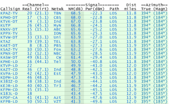

KPHO is the one I am having issues with. Can't figure it out....

I still like the adjacent channel explanation. You have a low-power K18JL on real channel 18, which is right next to KPHO on real channel 17. It is possible your Wally got "confused" on the OTA scan, and is sometimes displaying the strength for the wrong channel while you are watching KPHO. I used to have a similar issue (displaying the strength for the wrong station, with a signal loss message on the screen) on one of my Wally after a bad OTA scan messed things up. Another OTA scan (at a time when all of the stations were actually coming in with a stronger signal than I normally get) fixed that problem. So, a re-scan may not hurt in your case, either.
KPHE is on real channel 16. Also a low power, but more received at dishdude's location. And he says his TV has reception problems on KPHE, so it's not just a Wally issue.
KPHO is also putting out a megawatt. But so is KPAZ and KTVK. Neither of those have adjacent channels that I can see from the chart above.
