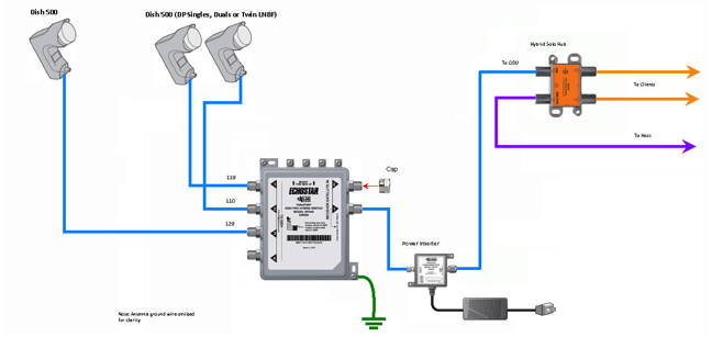

I don't have clear access to the sky to pickup all Dish satellites with one 1002.wa. I have three holes in the conifer canopy that will allow three different dishes mounted in three different locations (100ft from rcvr) to each access a single satellite of the trio. If I combine thru a switch, would this setup work on a single Hopper DVR? Does each dish need to point to a specific LNB? or can the center one be used on all of them?

I don't know what your asking but the receiver other than a Hopper 3 will work usong a switch like a DPP44 if you have 3 seperate DishPro LNB's connected to a DPP44 or 34 and receiver(s) connected to switch.

Yep, three separate 500 (wing) dishes, one pointing to each Satellite with a DPH 42 Switch will run a Hopper 3 (and I'm sure a Hopper 1 and 2).

After surveying possible mounting locations, I narrowed the antenna locations to two. One can get 119 and 129, and the other 110. I was thinking I could wing-in a non-twin lnb for 110 into the LNB in on a 1000.2wa and avoid the switch and just go with a hybrid node. Is this correct? If a still need the DPH42, and used this same setup, would I wire the #2 and #3 off the 1000.2, or can I just wire one cable off the antenna?

No, you can use a Hybrid LNBF but if you wing in the 110, put a piece of tin foil over the right eye - looking form behind - on the 1000.2 so it doesn't conflict with the wing dish. Then just run 1 cable from port 1 out to the Solo Hub
