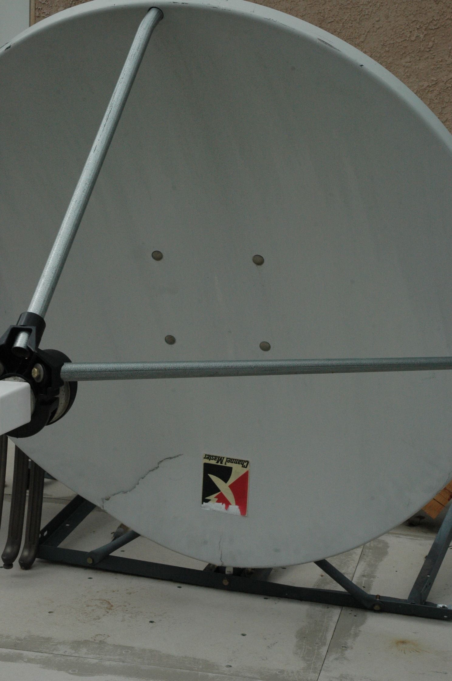

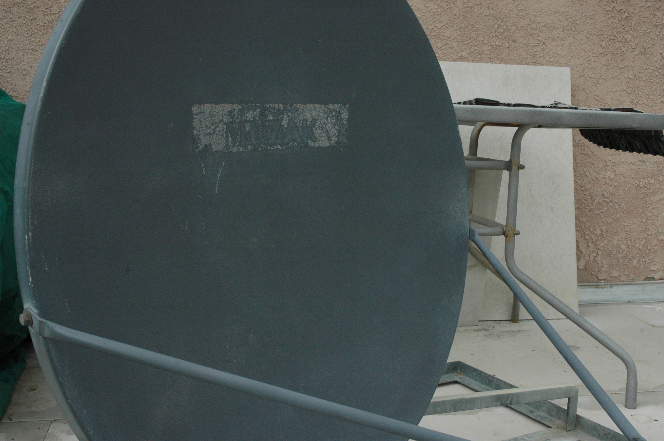

Need some advice I'm planning to get PAS9 from Los Angeles and I was wondering what dish to use in the photos attached 2623 is a 30inch dish
2625 is a 40 but the bottom is cracked I don't know is it's still can be used?
What universal LNB can I use? dose the freq need to be 10.7? I wanted to get one from sadoun any Ideas...:D

You mean the top is cracked? What are you interested in on PAS9?
Hey the Cuban what to see the Island and get Cubavisión Internacional :up
digiblur,
Got a pretty good shot I'm up on a hill. So what do you think about the cracked dish ? Today is trash day, Do i put it out?
that crack wont make much of a difference :)
Yes you will need a Universal. Any Universal will work (has to be able to receive from 10.7-11.7 for sure. Most Universals are 10.7-12.75)

I think Pas 9 is an eastern sea board sat ? If so , I doubt you can get it from LA . My chart shows Rainbow 1 as the futherest east from LA at 61.5 West & an elevation of 18.6 degrees .
If you did get it , the elevation would be lower than that , I think . You would need to be on flat ground or looking down hill would be better , with no trees or buildings for quite a ways . Or get your dish up higher ?
As far as the dish is concerned , I would try to pull it back into shape & glue it from the back .

the conus beam it shows 47dbw for la if you dont have any obstractions you should be ok .........i don't think you will be able to get it with the 30"dish
I reside in the Los Angeles area (part time, dual homes) and I can confirm that you can simply use a 30" dish at Pas9 for Cubavision amigo. You dont need to go with a 40", but bigger is always better.
Those dishes you have posted look kinda heavy and i would suggest getting a much lighter one, if you need a local source for 30" dishes with no shipping involved shoot me a PM and i can suggest a few local sellers that have excellent prices on 30" dish and lnb combos.
Hope that helps
Konjo , Coño ?
Both dishes look good, even the cracked one with a little repair looks like a good stationary dish for Pas 9.
Do you plan on motorizing your setup ?
