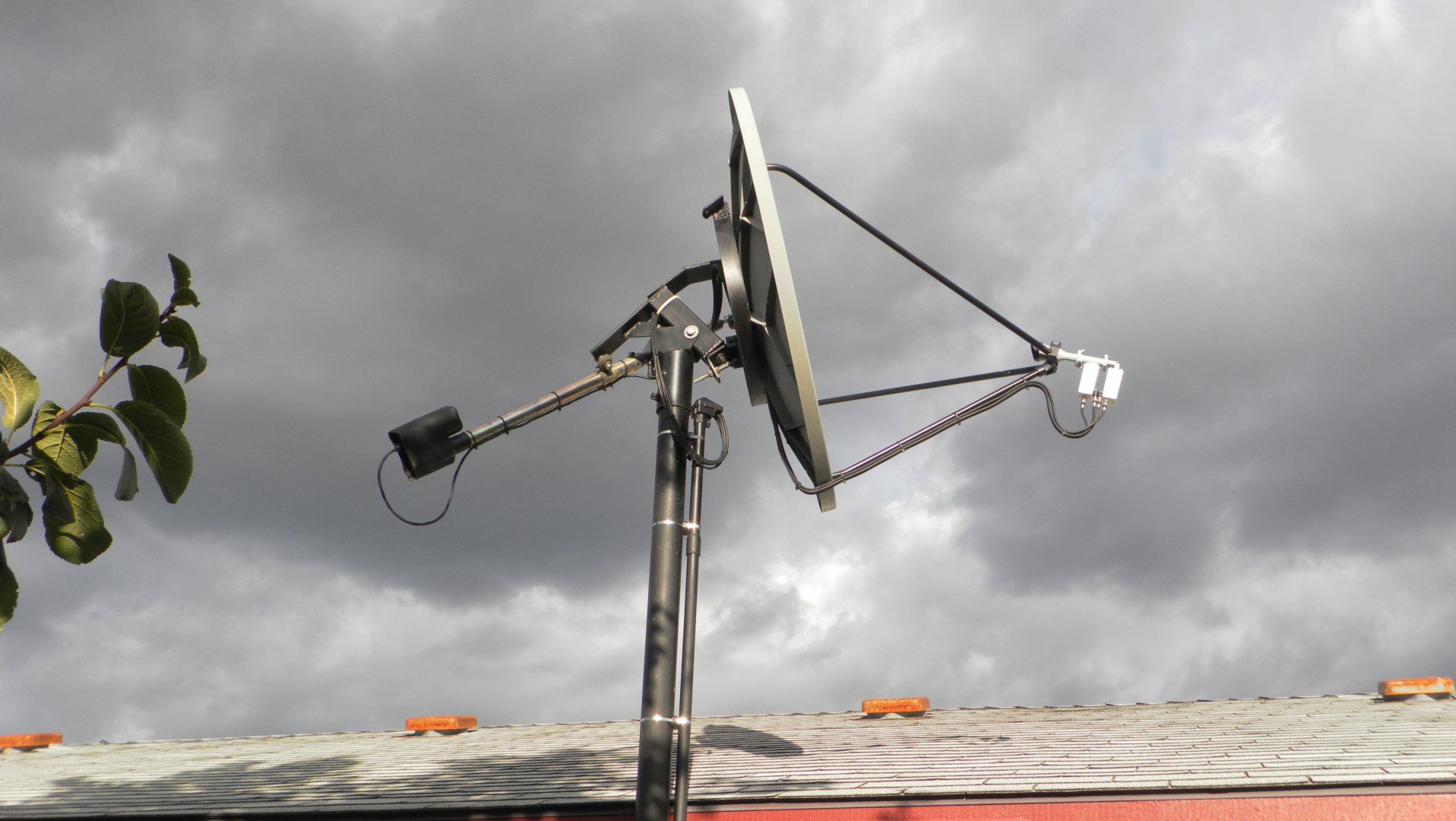

Using a 1.2M here and not having any issues. Signal is down a bit though.
kuortho-003-jpg.141699
Reactions: Cham
