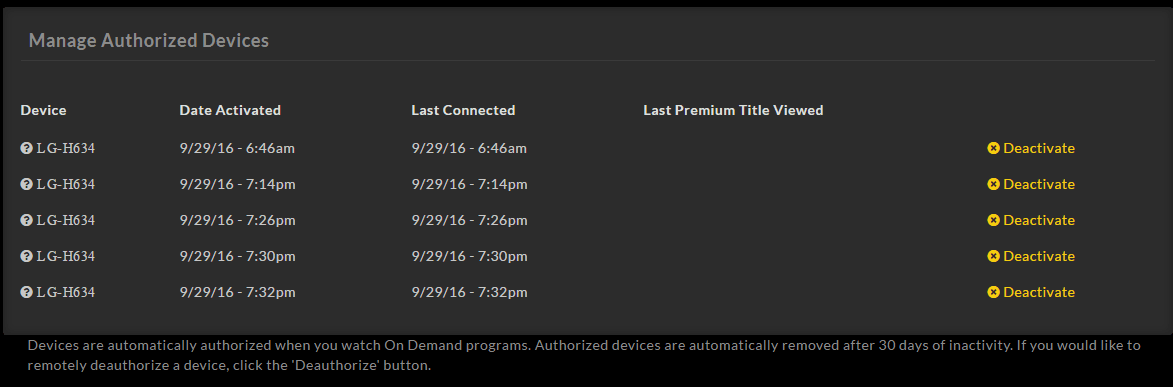

So I just got a H3, installed the anywhere app, play with it, all seems good; until the wife tries to so the same thing and she gets a message that the max devices (5) are authorized.
I go and look and my phone is listed 5 times.
I deauthorize mine 4 times, and all seems good, until I star the app again on my phone, it fills In all available slots again.

I can deauthorize my phone, got her added, now hers is in there twice, and mines in there 3.
I even tried doing it via pin code vs name & password ; same thing is happening.

I can deauthroize in the phone app itself, or online at dishanywhere.com; but it reconnects multiple times once opening app again.
I guess if I need to, i'll just have everyone open the app at the same time after removing all the devices...???
So I removed my phone completely, now her's has it filled up...???
