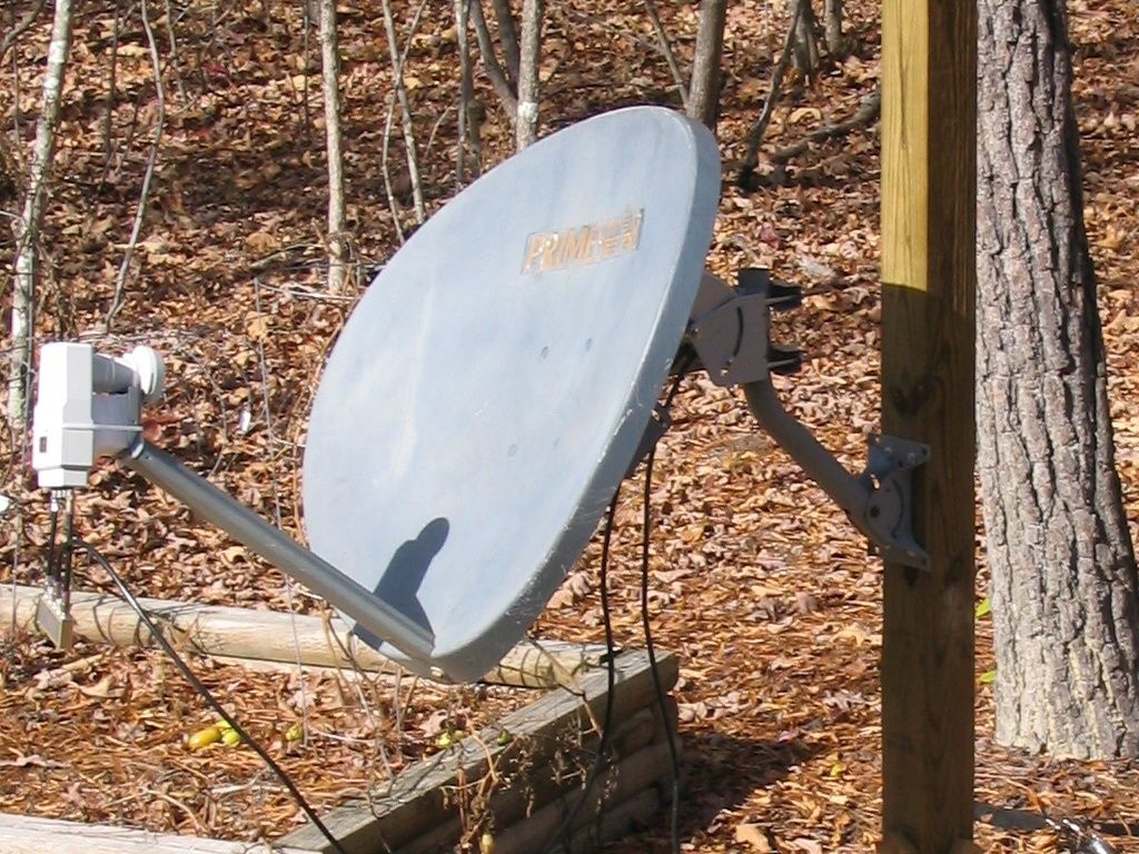

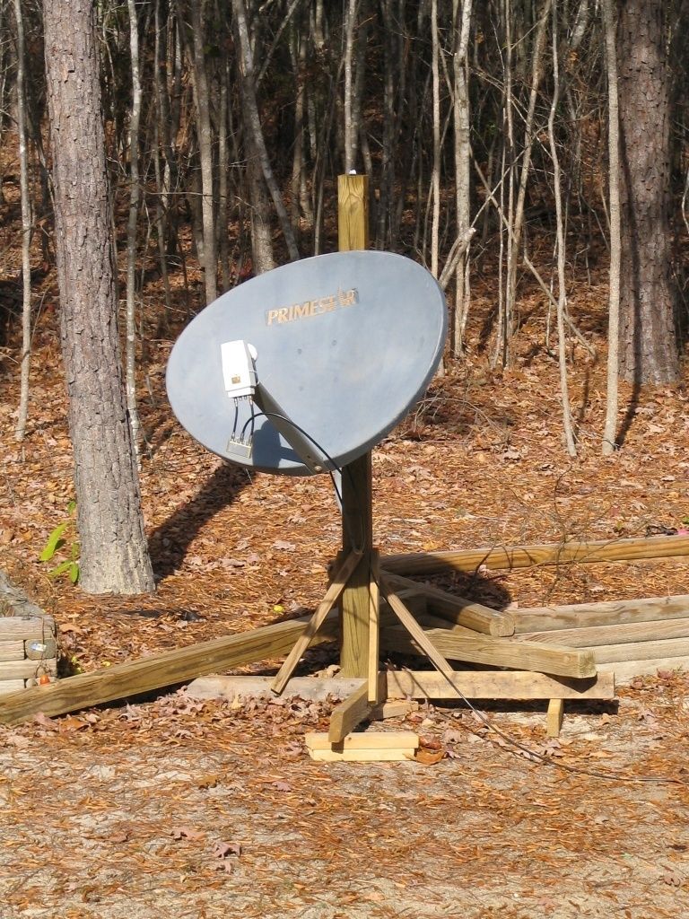

Here are pictures of my Primestar dish mounted on a 'mobile' stand I put together to determine where I could permanently mount it to avoid line of sight issues.
To test a location, I move the stand and level it. Then I set my true south satellite, and check the arc for any problems.
We live on a heavily wooded lot, so I had to try several locations before I ended up in the current spot.
The fun part still remains... the hole, the pole, and the concrete :eek:
