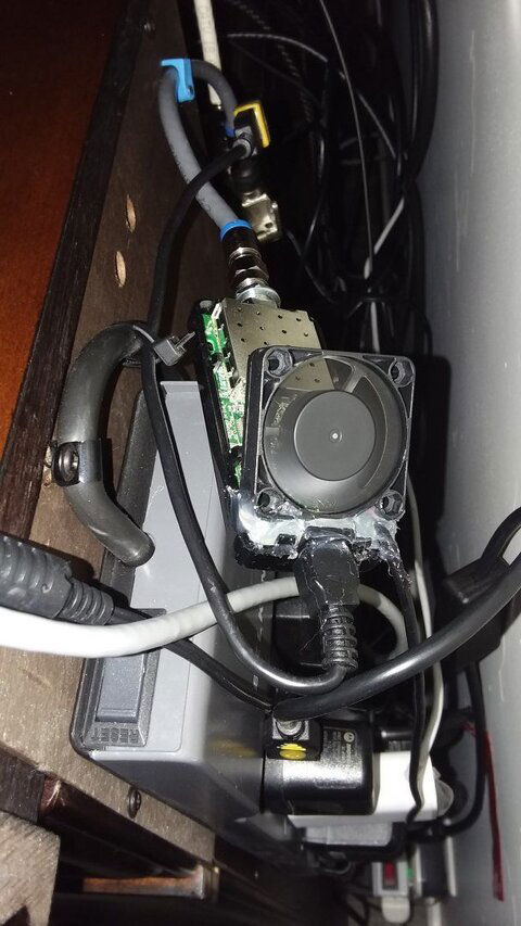

OTA causing pixalation on joey every 3 to 5 days.. PROBLEM solved.....Loosen the nut on the coax side of the ota box. Use small flathead screw driver and pry off the top cover of the ota box...This let the darn thing breath however after about 8 days it started to pixilate again... I bought a tiny usb computer cooling fan and mounted it to one side of the circuit board to let cool air blow on it..Has not done it since been 3 weeks now
