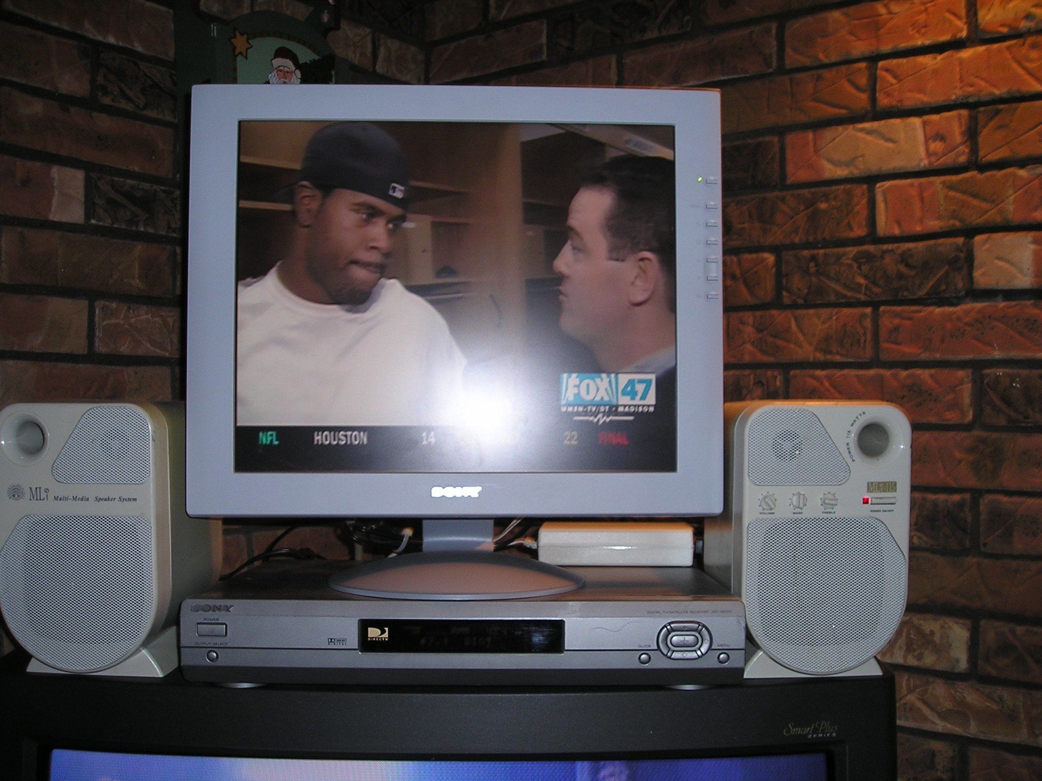

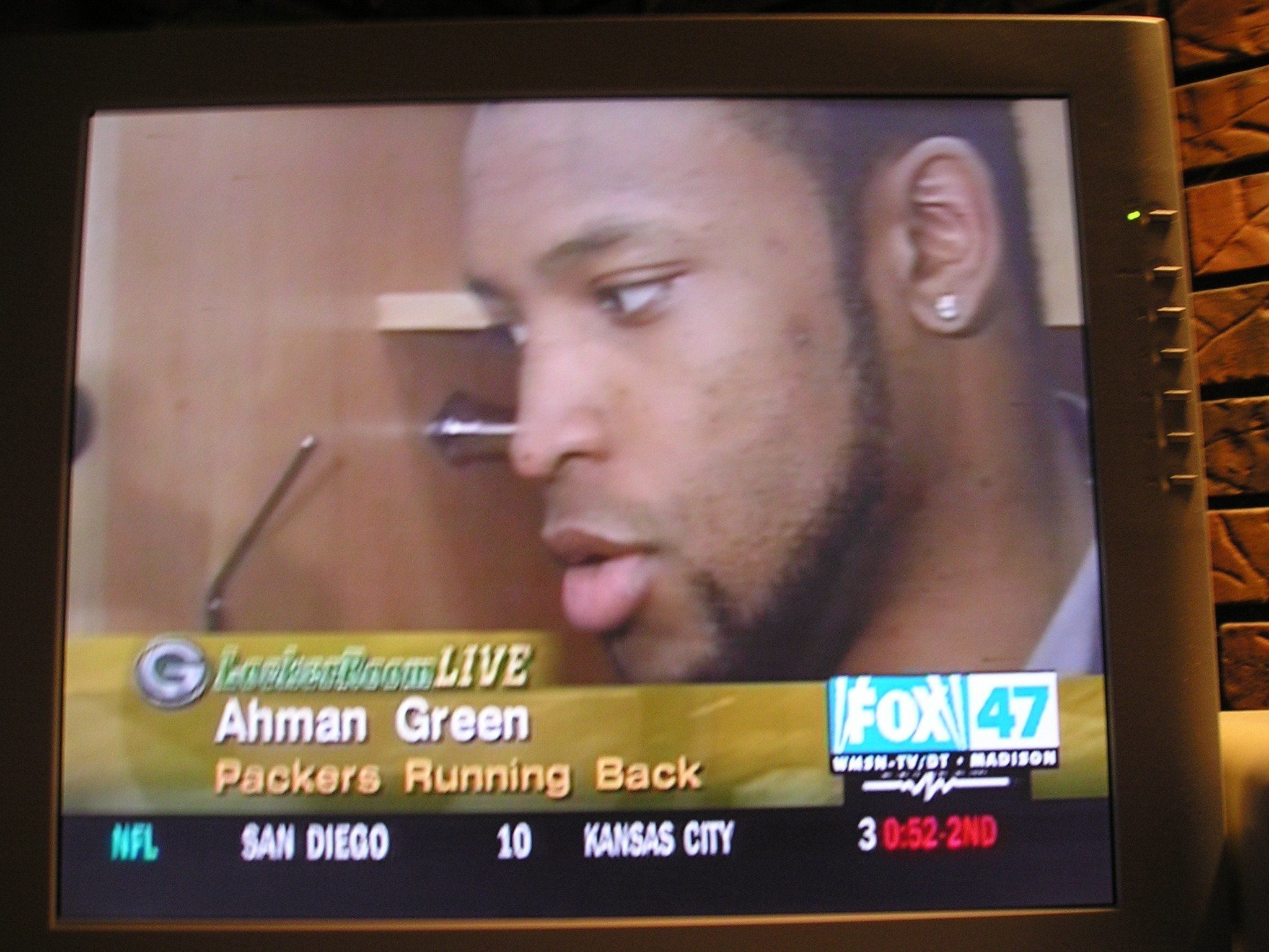

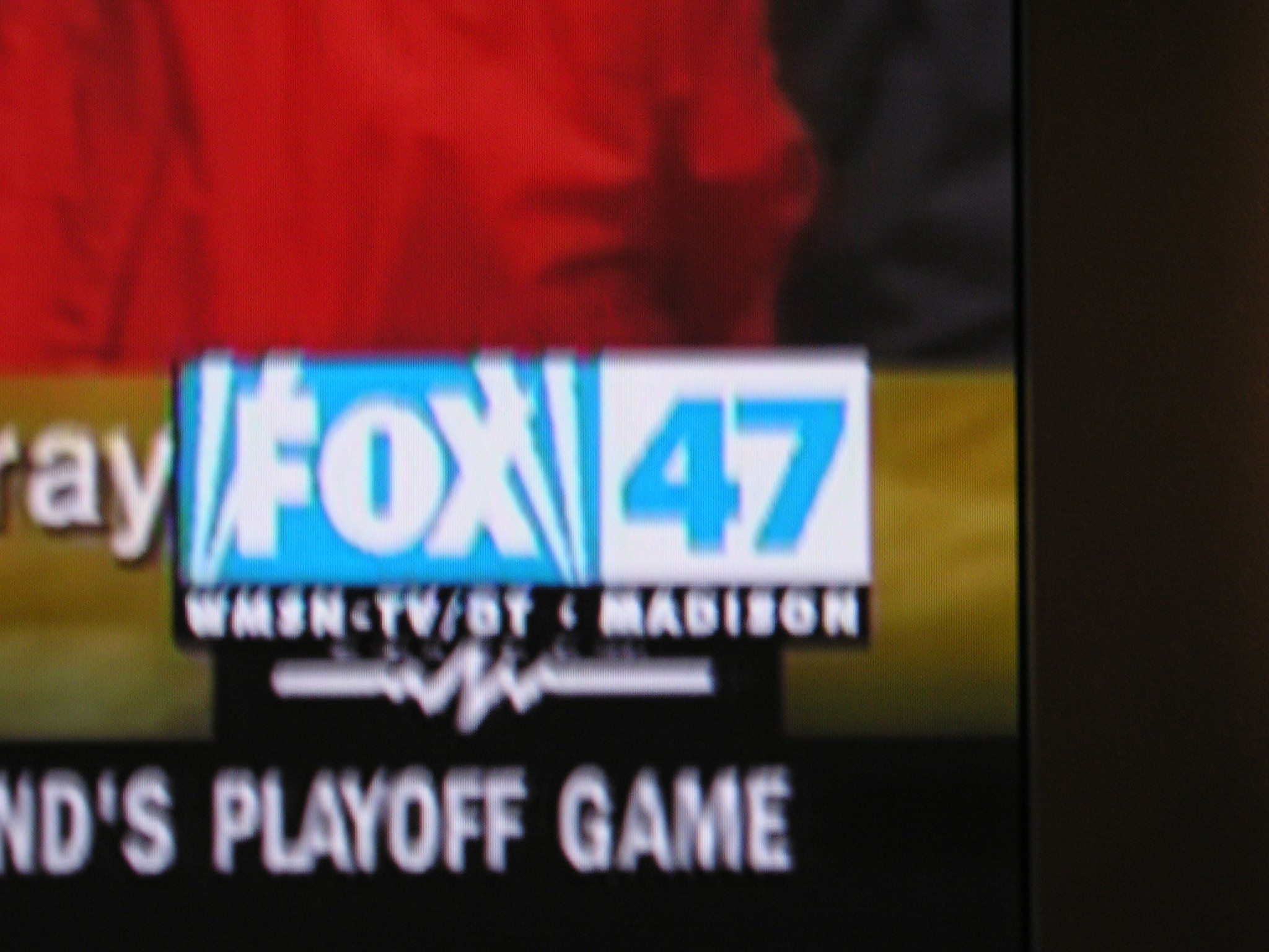

attachment is of my sony sat hd 100 and a sony 18 lcd flat panel display on vga 1080i and I was receiving fox 47 out of madison wi on 1-2-2005 great hd day!!!
