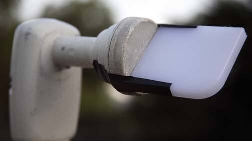

In the old days converting linear lnb's to circular by putting plastic in the lnb throat,I noticed the lnb would still get linear signals at a reduced quality(mirrored V and H tp's,but what the heck)
I was wondering if I could do something like that to a fixed dish aimed at 103w to get the nbc hd without having to skew the lnb? If the weather is ok I could play with it tomorrow.It would have the benefit of getting nbc and the other tp's without having to twist and shout.

I kind of doubt that it would work, but I don't know what you're trying to do anyway. If it's a fixed dish, why not skew the LNB?

linear lnb's to circular by putting plastic in.
Linear to Circular LNBF 1

I aimed the fixed dish @83w and set the skew,then aimed for 103w using the coolsat with it's settings.
I left the skew alone (103w -20 =83) then scanned with the openbox to get nbc hd.
Quality readings in the 73% range,which for the openbox is plenty.
The only nuisance was trying to get audio on the nbc channels,I had to play with the audio button on
the remote to choose a setting that would give audio at the proper level and not distorted.
