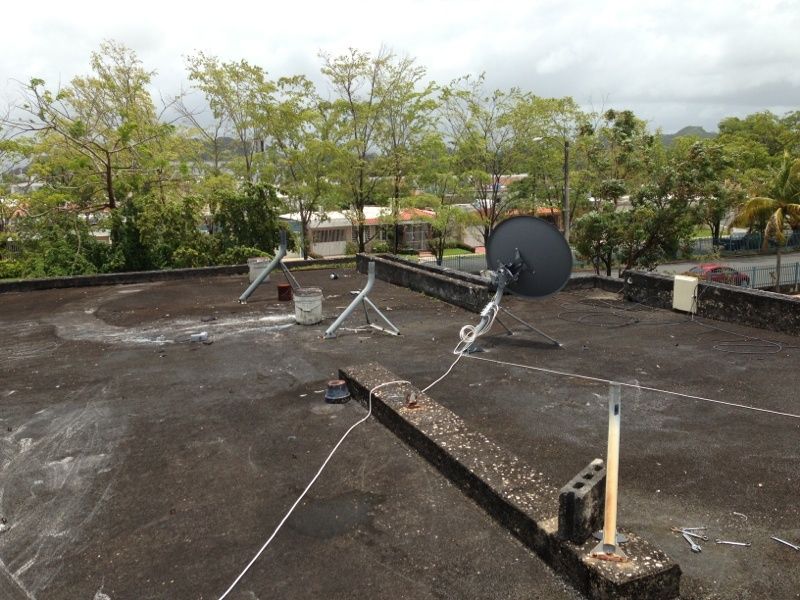

Just finished removing my old dishes, off to the trash they go.
