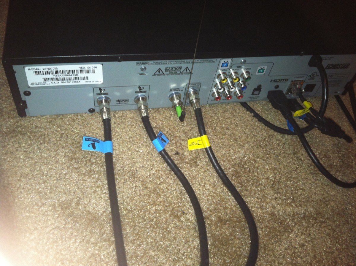

jim pic one is good pic 2 is WRONG !

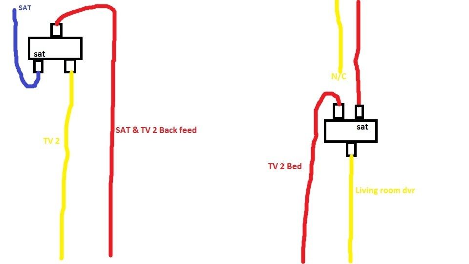

Since your tech did bolth lines on roof if they are next to each other you can use my crude draw to fix the issue

it should be no other way to do it if he did put the 2 lines to the roof. if they are like my photo you will need another diplexer or you could just call dish or toss a $5 to the next guy up on your roof to swap the lines
yep 2 lines to the roof . If the rooms are next to each other you can get a diplexer and run one line to the new location.
just hook up the line direct to the triplexer to sat in on diplexer and run the new line on the side with a single connector to your living room and put the box on the new line and tv 2 on the same side as sat on the diplexer
can also be done with 2 cables one connected directly to the line the triplexer was on and extend it to new location then for tv2 hook up second cable from box where you see the yellow tag direct to the tv 2

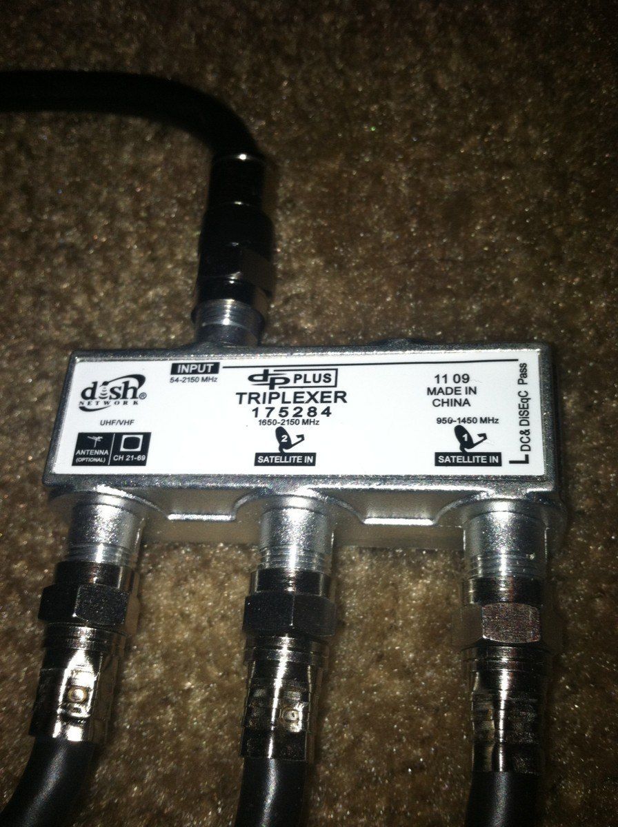

View attachment 77283View attachment 77284 ok soo here it is this is the way it is setup in my bedroom what you think?
