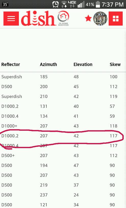

All setting are as shown in the book 207 42 117
What now?
Disconnect EVERYTHING from your receiver and do a check switch to clear the switch matrix, then reconnect and try to find 119 on the center lnb.
You're right, this is directly from the tech portal
