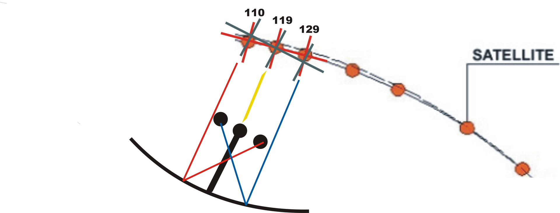

Yeah. I'd suggest you try to zero in on 119 for the center LNB and skew in for 110. Then see what 129 gives you for signal. Start with 119 and the dish at the suggested skew. Center LNB 119, Right is for 110, left is 129 looking at the sky from the rear of the dish. DishLNB.png
