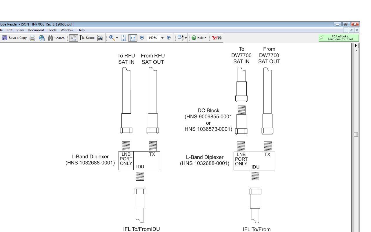

While on the install subject, can someone tell me if one RG6 cable will work for install, or does it take two cables from dish to modem? I have one RG6 coax coming from dish site to modem place in house and don't want to run another cable. Thanks in advance if you can answer my question.

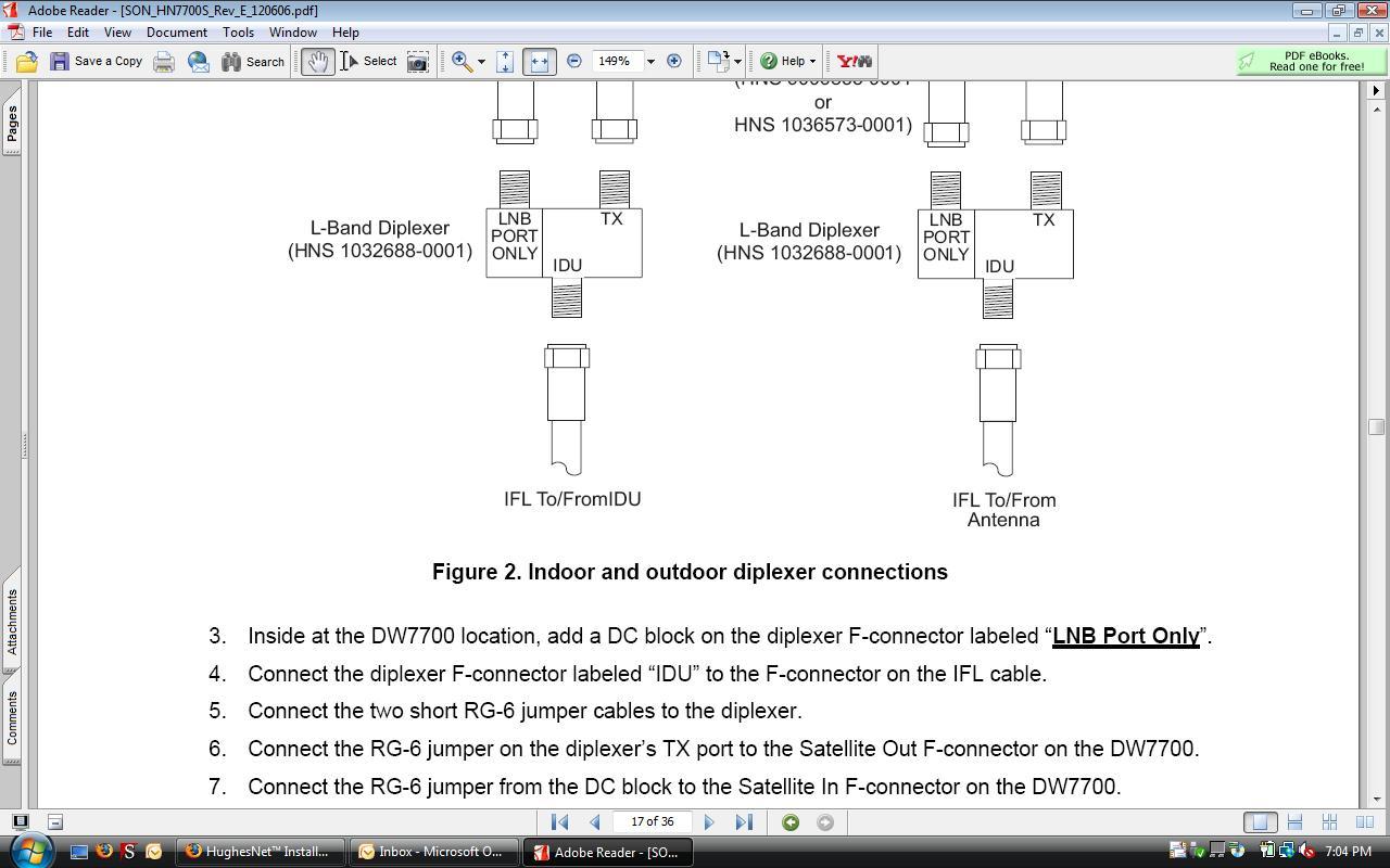

It is possible. You will need 2 L band diplexers and a DC block. Good luck finding them though. Below is instructions.
