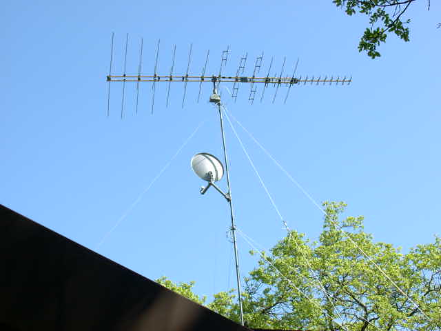

The standard dish mounting base can be attached to a mast using U bolts. I'd say anything much over 5' - 6' should be guyed to avoid swaying in the wind. I've got my 61.5 dish mounted on my TV antenna mast (20') at about the 12' - 13' mark, which is right above where the first guy wires attach at 10' so it's pretty stable.

Nice setup Doug. The mast would definitely be swaying in the breeze if not for the guy wires. Job well done.

Thanks guys. I did it overkill just so I wouldn't have to do it over again since it is such a PITA to take care of. Plus we don't want that sat dish waving around when the wind blows. I actually used 1/8" plastic covered wire rope as guy wires instead of the regular antenna mast wire as it rusts over time and a strong blow will snap it (as evidenced by experience). Not this stuff... :D Didn't cost that much more and now I'm done until the roof gets redone in about 5 years.
