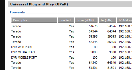

Well I managed to fumble my way through this. I enabled upnp on the router and dvr and have access over lan, haven't tried internet yet. While working on this I discovered ddrt on my router actually keeps track of bandwidth usage. That is a pretty neat feature. Any disadvantage of letting upnp configure port forwarding? I did leave dvr on dhcp. If I change it to static and my public ip changes, will this change anything? Also I noticed in router "teredo" it started off with 1 & now there is several. What is this? I noticed it has my laptop ip beside it.

Success......had to bridge dsl modem to let router handle everything. Also set up dyndns account and that is sweet, dynamic ip has already changed but dvr has never missed a beat. This was a good learning experience, thanks for the replies.
