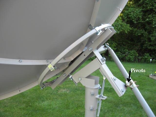

I find that once in a while my dish may shift alittle due to the pivot action where my actuator arm is secured to the polar mount.Havent found a solution for this yet i just learned to live with it.

It's most likely some "play". either in the actuator itself, the holes for the pivot? or the holes that mount the actuator. A small bolt in a large hole..
just push/pull on the edge of your dish
and look for something moving that "shouldn't be", and when you know what the "play" is you can either remedy it or compensate for it.
I didn't understand it was a new actuator, shouldn't be much slack in the tube if its new! FatAir is on the beam, as always-look for 'looseness' elsewhere in the drivetrain. (pivot point, motor attachment bolts, where the end of tube fastens to the dish ring, etc) There's usually several places on a dish that can have some slack.

mine does overshoot /undershoot. one of them. but it moves so fast it really doesnt bother me to go back in and move it till the tp is peaked. i know this is a little extra but i think it is more at the pivot bolt than the actuator. the thread on putting these dishes and actuators in working order had many of us trying different ways to make that actuator flush with the mount. extra washers, spacers etc. for me i have it about as good as it will get with the pivot and just come to accept tweaking the settings when i move dish to dish. i will continue to mess with it a little but not much.
Outback I had a dish like that, the extra slack turned out to be in the pivot point. I never did figure a way to take up the slack and just learned to live with it.
