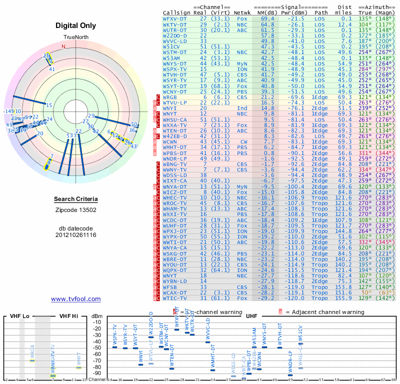

The antenna is a db8 and is up.
I need to get the owner to move it a bit.
Can get most except real channels 15 and 29. They are like 180 apart so I think I MIGHT get 29 if the antenna get move a bit more from the backlobe.
I like the one antenna idea. I think if I add a pre-amp to the one antenna that might do it to?

Are you really at the top of the hill next to the transmitters or was that the default TVfool plot for 13502? My guess is that you are down the hill in Utica where the ION station is a little more challenging.
North of Utica and can see some of it from about 100 yards away.

if your signals are strong, you can remove the reflector to get the signals from both front and back, but you will loose about 3db of signal. (have not looked at your tvfool report so this might not be benificial)
Lowe's sells a rotator for less than 70 bucks. Best to use one antenna and reposition it that try to hook up two antennas pointing in different directions.
