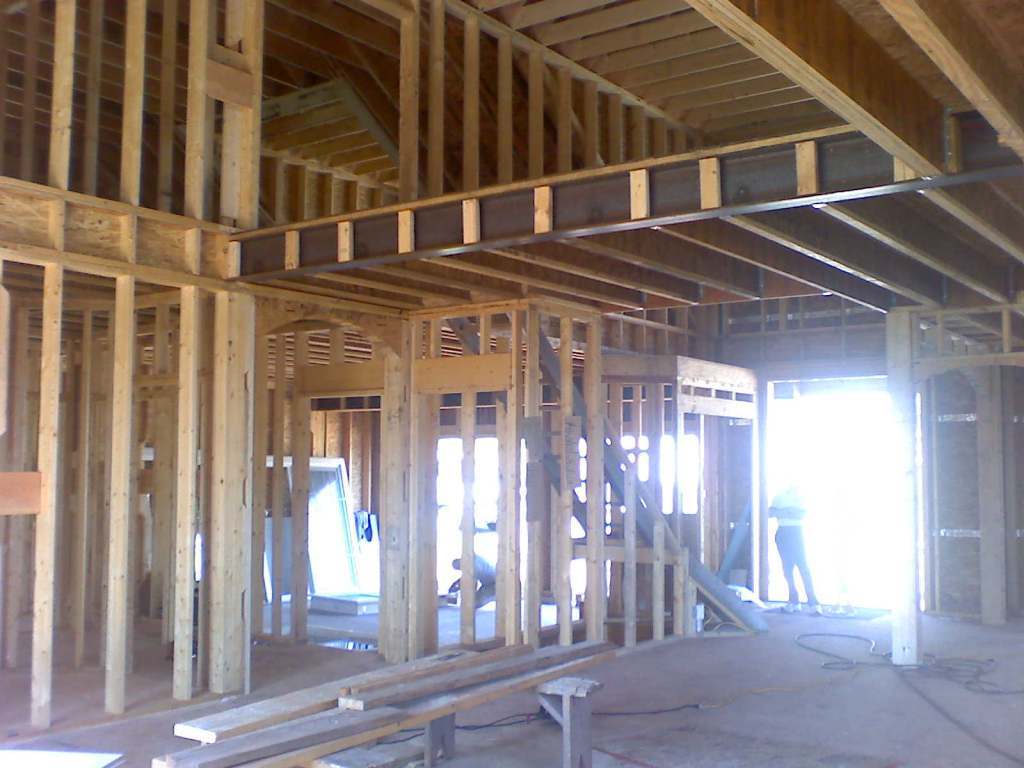

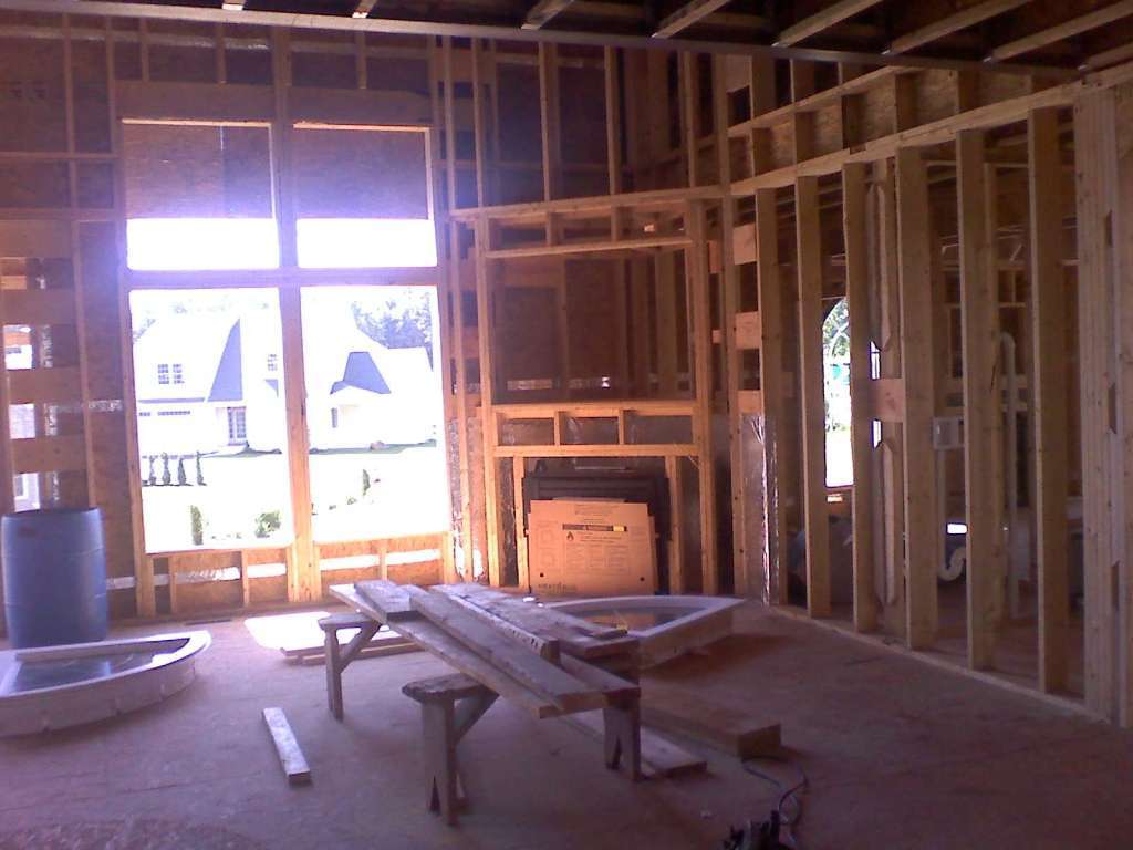

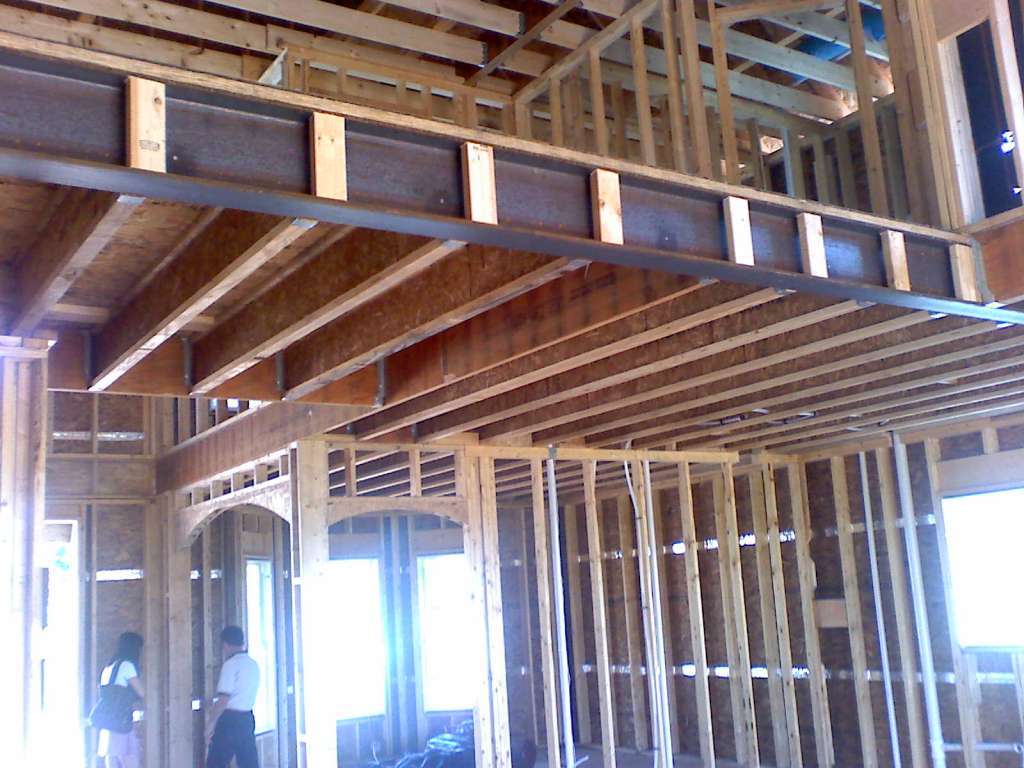

I went to the condo the other day and got some photos of the family room where the 5.1 ch setup is going. I still have to meet up with the installer to go over things in more detail, but from looking at the setup I have a number of concerns about the setup and how good the sound will be. For one, the area around the television is very open and scattered. Now I'm not an audio expert, but it's my understanding that for a multi-channel system to work properly (i.e. not sound like crap), you need it to be in a contained area and you have to have the speakers aligned in a somewhat straight fashion. Unfortunately this family room is attached to the kitchen area and as you'll see by looking at the photos, the possibility of a good alignment seems impossible, unless we want to put surround sound speakers next to areas where people may be preparing food. In the pictures, any "open" will be areas such as the archways and the areas without any wood pillars (the area about 10-15ft back from the television will be open, as well as the 2nd floor area, allowing someone upstairs to look down and see the television.)
Does this setup look conducive of a decent audio experience? I want to know or have some idea BEFORE I meet with the installer so I can see if he knows what he's talking about or if he's just a product pusher.

Open floor plans make living easy, and are very pleasing to the eye, but getting great sound is more often than not, very hard to do. Ask your installer what his experience with these types of floor plans has been. He may put you at ease. Understand that I mean that great sound is not unattainable, he may have a lot experience in this, and he probably will surprise you. The bad thing is that you won't know for sure until it's to late.
Ask him if he has another customer that had a similar floor plan, and maybe you can talk to that customer.
I ewcho what Paul says, but you really won't know until you hook it up and try. I had a somewhat similar open layout in my last house. The difference was that I had 17' ceilings for the family room, going down to a traditional 8' ceiling in the kitchen. I was able to build surrounds into the columns and with some tactical fabric treatments, get something reasonable.
I would be just as concerned about the corner treatment for the TV placement. It is going to be very difficult to get speakers to work properly when they really need to be on 4 different walls. I expect that this will be a bigger problem than the open floorplan.
I was about to make essentially that same recommendation as Paul did, that you and your father go see/hear an installed system that's as close as possible to the one the installer is recommending. If the installer balks at providing references, that should be a clue! Make it a condition of the sale. You wouldn't buy a car you haven't actually test-driven vs. just looked at in a brochure, etc...
My guess is that your father would be satisfied with a more completely installed/configured system than you or I would be, and there's certainly nothing wrong with that. I speak from experience (at a much lesser level). I know my mother was much more concerned about how speakers "looked" (or rather didn't, being installed in walls) than how they sounded. Future expandability or connectivity of perhpherals was a complete non-concern. Convenience was the biggest issue, and having one complete, integrated system with a single remote was the selling point for my folks, technology be damned.
But IMHO, a completely built-in system is a setback. It won't be able to "grow" with you as newer technologies and equipment become available, and along with that the desire to upgrade. But you could still provide a centralized location for the rack equipment and wiring to all the satellite locations to facilitate the installation later. Provide plenty of room so swap-outs and ventillation aren't issues, and plenty of redundant and "future-proof" wiring. One way to accomplish the latter is to run 1.5" or larger conduit to satellite locations so any future necessitated "wire" can be pulled later, like fiber optic cables.
