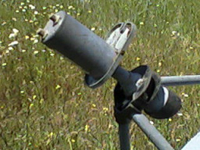

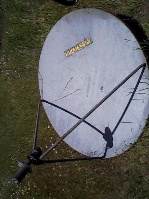

A friend of mine was clearing brush for the forest service up in the hills around here and stumbled on to this primestar dish. He has seen all my 36 inch dishes and says that this is bigger, so I'm assuming that this might be a 4ft dish. I have never seen a bracket like that before to hold a LNB or for that matter I have never seen a LNB like that before. He would like me to get him set up with this as I have a spare Merc 2 he can use. I have ask him to send me more shots of the dish, do any of you primestar experts know anything about this dish?

Looks like a 1.2
That's a 1.2m (4ft) Primestar/Channelmaster. Those are by far the best ku dish around. Some have even picked up a fair amount of C-band with 'em too. Great find.... I have 2 of them up and in use. Set your friend up with a 36 and talk him out of that one! J/K :D Oh... and those Primestar H/V LNBs work great too!

Thanks for the reply, LOL I didn't think about swapping him one of my dishes. :) This dish will be stationary so is it pretty straight forward as far as setting it up? I haven't seen the dish up close so I'm not sure how the mounting braket will work. Thanks again.
Get him to look at the back of the dish, there will be a "MOLD#" stamped on it somewhere, that will tell you exactly what size it is. Those bigger ones used a big pole, 2 7/8" or 3" I think, the mount is visibly larger than the 1m size dish/mount. Nice find!! Would love to find one of them hidden in the the brush someplace.

All you need for the existing LNB is a 2x4 multiswitch or better.
The LNB is missing the cover, but that's not critical.

The elevation markings on these, are spot-on accurate to the degree.
They are very easy to set up. :)
So true. Best AZ-EL mount out there. Even though the dish is quite heavy, its a breeze to adjust the elevation... All you need is to loosen the side bolts and turn the top bolt with a socket wrench. Great dish system. I have the 1 meter model fixed on AMC-21 for the PBS.
As for the LNB, the feedhorn is a standard C-120, so if you must replace the original LNB, just bolt a stacked Superdish FSS LNB right onto the original feedhorn!

The factory NJR LNB and feedhorn works great. The feedhorn is tuned to the dish. I have been using mine since I put it up and it does wonders. :)
This is probably a dumb question but can I hook my sat meter up to either input on the factory LNB that came with this dish. :confused: I ordered a multi switch today so hopefully in the next week or two I can get up to his property and get him going.

the 1m and 1.2 m should require a 2 7/8" pole. the primestar j pole is huge with 2 support legs.
crackt out,.
2 3/8" on my Channel Master 1 meter (same dish Primestar used) as well, but I've seen that dish with a 3" AZ-EL mount... I believe all of the 1.2 meter Channel Master dishes had the 3" mount.
