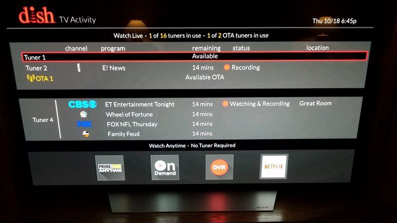

My Hopper is tuned to CBS. Attached is a pic of the TV Activity screen. As you can see the four prime time channels are all using Tuner 4.
That's how it works. All the big four networks use 1 tuner. If it was Hopper 2000 or Sling, it would be tuner 3. With Super Joey, Tuner 5. If you're not watching anything on those channels, that tuner would only say Available. That's what gives PTAT the ability to record all four channels using only 1 tuner

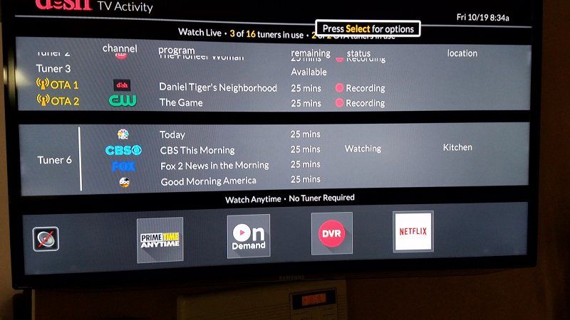

No telling what tuners the Hopper selects. She likes to pick different tuners that suits her! :coco Attached is two pics of my Hopper 3 Activity screen. She is recording two OTA channels and two satellite channels at the same time while I am watching an OTA satellite channel 4. I am using the AirTV dual OTA adapter.
