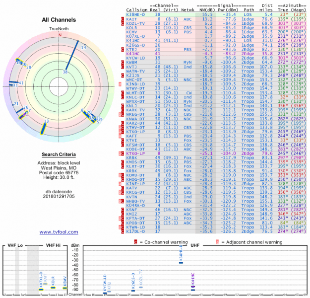

Thanks pamajestic and Jim5506. Sorry it's taken so long to get back to this. Tropospheric conditions did have a lot to do with some of the questions I had. But here are further details. I'm combining a home-made 5 element yagi antenna specifically cut for rf 13 with a large radio shack uhf/vhf antenna. The rf 13 yagi is pointed at roughly 200 degrees to try to snag KMEV, Mountain View Arkansas. The uhf/vhf combo is pointed at about 300 degrees aiming for Springfield MO stations at rf 10, 19, 28, and eventually 16. As a further update the RCA antenna preamplifier burned out. It was most likely defective as it was new.
The rf 13 yagi is mounted about 4 feet above the uhf/vhf combo antenna. The coax from each goes into a channelplus 2 input combiner. The common output from that now goes into the house where I've temporarily connected a cheap Wal-Mart ONN preamplifier and injector. I didn't want to get back on the roof until I was sure it was worthwhile. My interest in antennas only slightly overrides my fear of heights. The new results are that I get the intended Springfield stations and the local lptv ch. 36 all of the time. KEMV is fairly reliable, but occasionally I will lose signal for a while. (At most once a day for maybe an hour). I've been getting KTHV (rf12) for a few hours at a time but I'm sure that's due to tropospheric conditions. But it at least proves that the custom yagi is doing its job, I think.
My plans are to make new identical cables for the antenna to combiner connection. I'll be moving the preamplifier and connecting it to the output of the combiner. I'm hoping that lowers the loss for the cable run of approximately 70 feet. If anyone has any other suggestions I would gladly welcome them. I should mention that the TV does not have a signal strength indicator.
