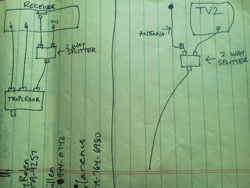

Try this...
Likely there is just interference. Did you add a wireless router, or game system or anything like that at all in the house?
