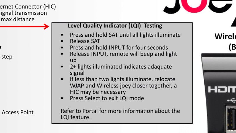

You can check access point range with hopper remote using attached instructions.

As well as relocating the WAP closer to the wireless joeys for better signal.
