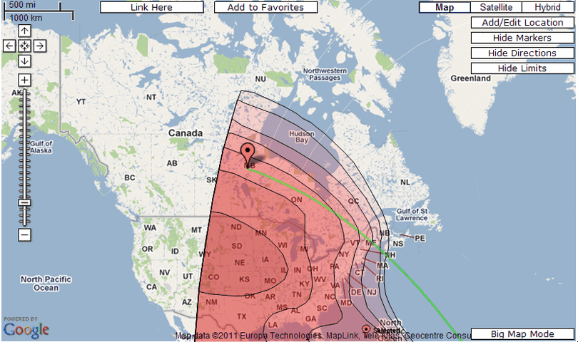

3 degree elevation and barely in the footprint...hope you got a BFD to try
looking at the maps you may not even be in the footprint....according to Lyngsat Cuba mux is on 1D, the rest are on 1C

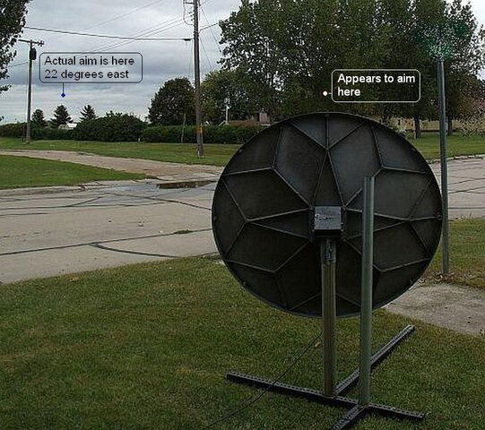

I'm at 97W 48N and had to put the dish on sideways to get a CM 1.2 to aim lower than around 16 degrees elevation as I have it at 6 degrees elevation. Dishpointer says 3.6 elevation, for your location, so terrestrial noise may be an issue on a smaller dish, as will LOS.

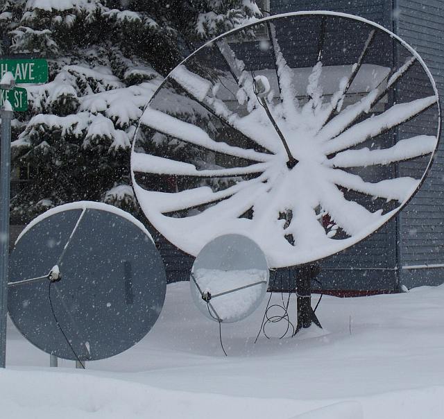

Someone posted a picture of dishes in Barrow Alaska and it was funny to see the Ku dishes upside down but thats pretty much what you're left trying at 3.6 degrees elevation. I think the experts here will tell you that even with an offset dish there is a limit to how low you can point it normally before ground noise interferes.

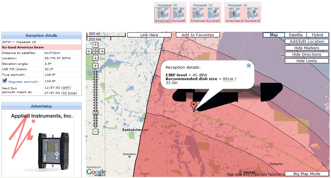

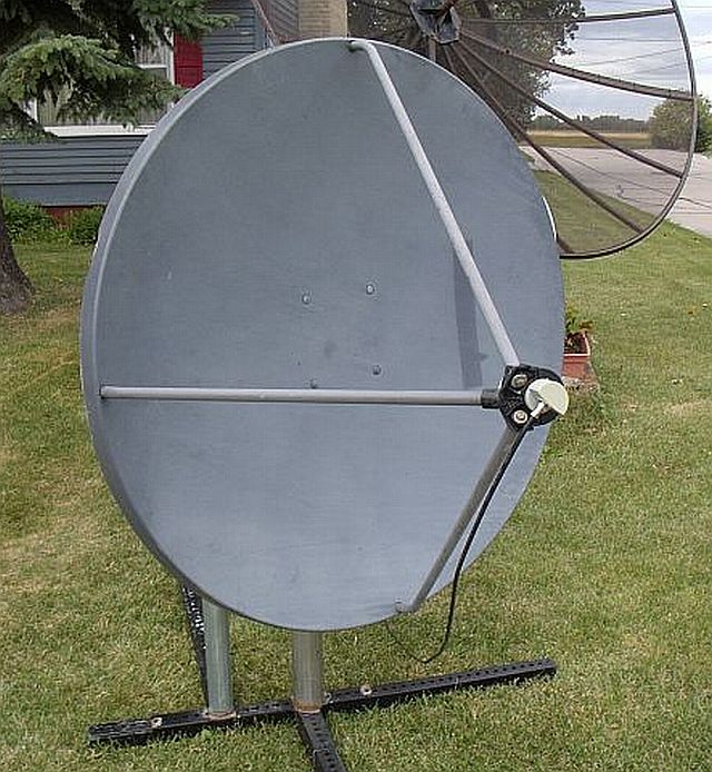

I looked at the coverage maps and google maps. 97w 55N Looks in the footprint, If the coverage maps are accurate. I will admit, just barely. dishpointer.com says he's at 3.6 elevation. Maps indicate 40dbw area, so should be possible. But, that being said, I feel a 1.2 meter, or larger, dish may be required to overcome terrestrial noise and the weaker signal at that low elevation. I know of no offset dish that will aim that low in a conventional setup. Sideways or inverted is the only "normal" way. Another problem with that low elevation is LOS. As can be seen in pic 3, that pine tree (~22ft tall, 570 ft from dish) would be a problem at 3.6 elevation, and will be with my 6 degree elevation, when it "grows up". BTW, I did the solar outage sat finder trick last fall to confirm that I could "see" 30w, before putting the dish up.

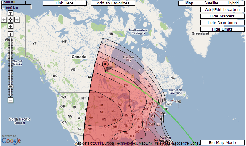

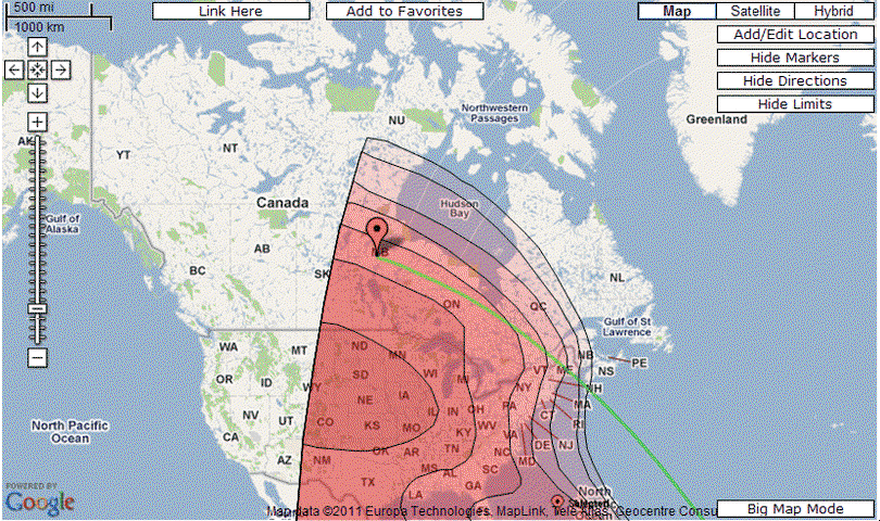

Here is a zoom-in shot of the EIRP map for your area from Hispasat 1D @ 30°W from SatBeams.com I would ignore the recommended dish size in the 2nd image for the reasons cited previously.
These images will simply serve to show you where you are in the footprint. I like the SatBeams site because you can dial in on the map for a better idea of what EIRP range (zone) your site falls into.
