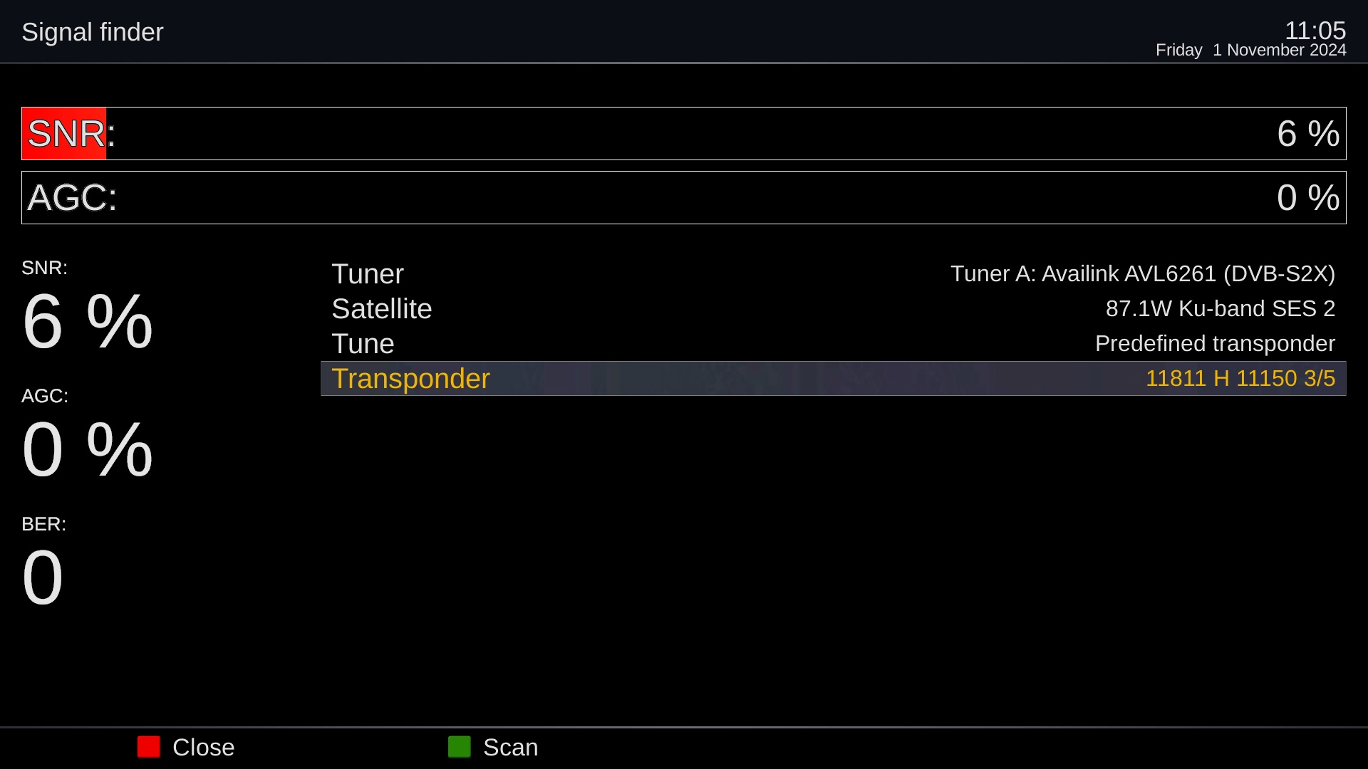

It's beginning to "fade in" which is what happens with LPB. Though far from locking right now, I'm seeing an SQ 6% bobbling signal on its frequency. Something is there. I bet within 1 or 2 hours it will be locked.
Might come in for you, but it will take a big boost for me for it to come in! Too bad they aren't as strong as CNN Newsource!

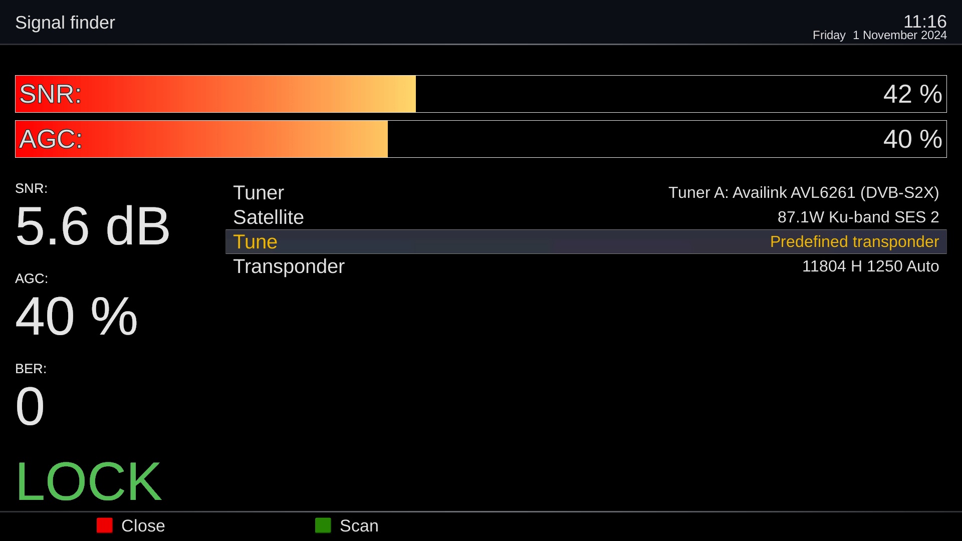

LPB Test just beginning to appear. Other LPB channels still MIA.
LPB Test Locked.

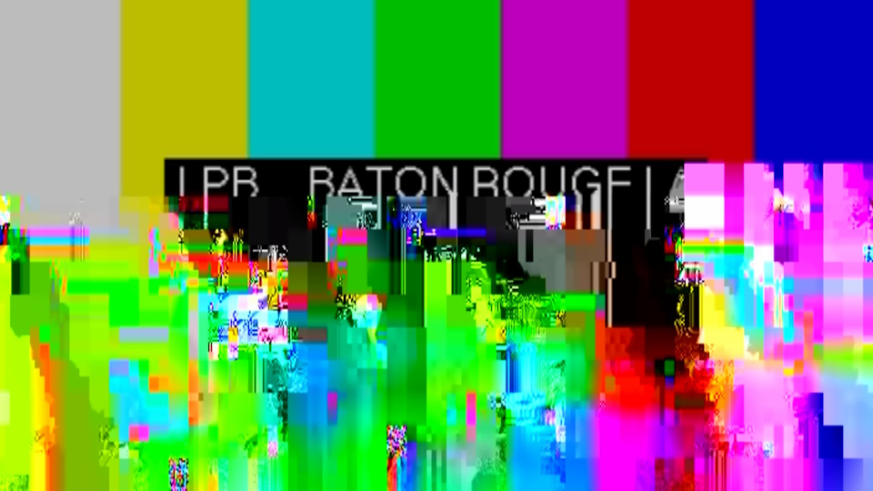

LPB channels not locking now.
