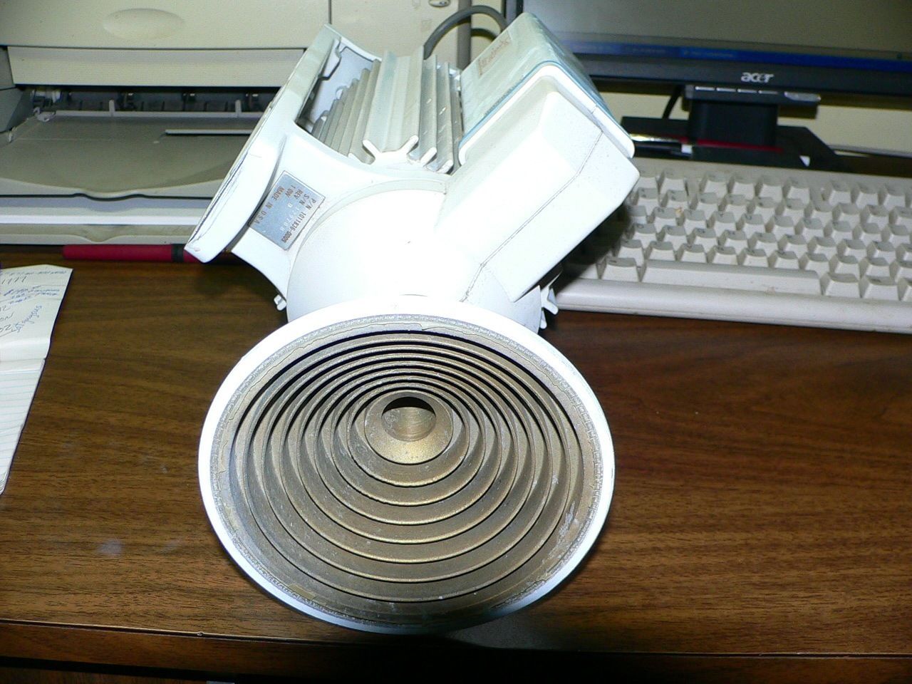

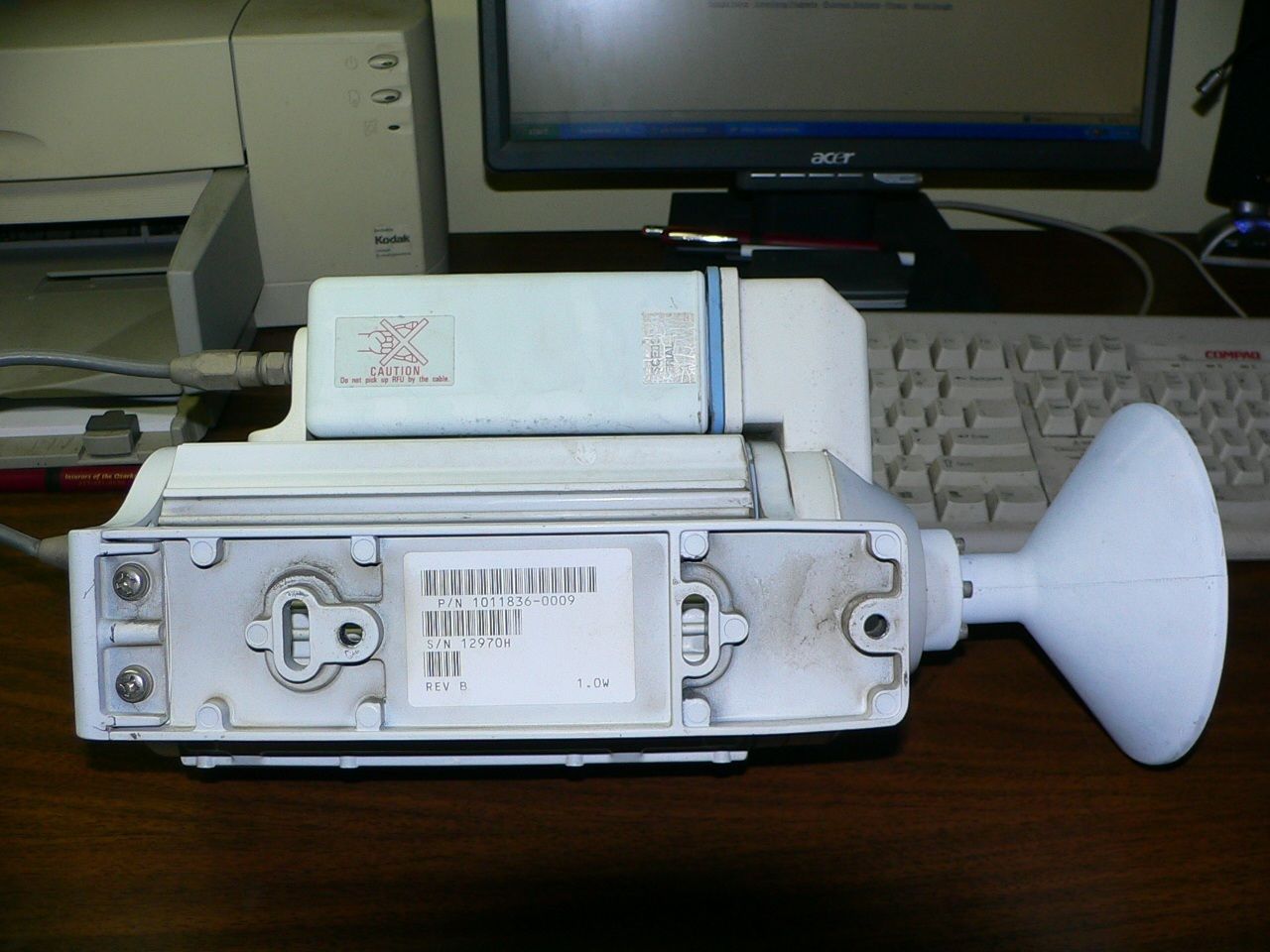

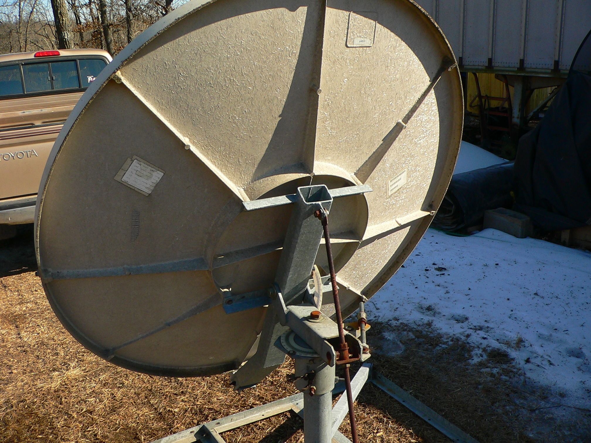

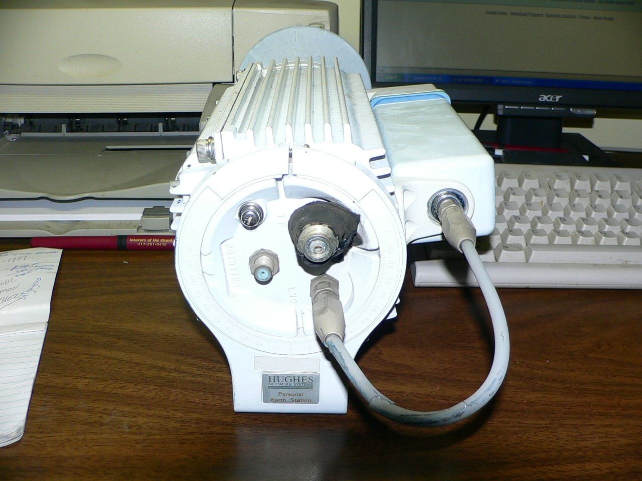

I acquired a 1.2 meter Prodelin offset dish a while back and was wondering if the receive side of the LNB/feed would work for FTA television reception?
Here's some pics of the dish and the tx/rx unit:

My bet is that it will work if you hook directly up to the rx side.
The catch is that it will be single-polarity...
Thanks, meinename. I think I will try that and see what happens, haven't been able to find any LO (or any other) info, so I'm not really sure what numbers to enter into the receiver.
The scalar/feedhorn gizmo is held on with 6 bolts, has anyone seen an LNB that would mate up with that rig?
I guess I could attach a standard linear LNBF at the focal point and see how it worked also.
Unless you want to transmit on that dish, you could just put a new KU LNBf with a new holder.
The Scaler ring on that old feedhorn looks awesome. It looks like it is missing the protective plastic cover.

We'll need close-up pictures of the flange :D
I'd punch in the standard 10750 but I'd aim it to some known satellite with an analog meter first. That way when you scan you know exactly which polarity it is.

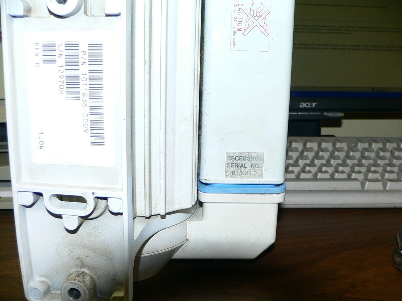

And my educated guess is that the Rx info sticker is squished between the big Tx cylinder and the little square Rx unit. :hungry:
Nice dish, BTW.
Thanks, Sadoun, I'm hoping to build an offset adapter for this one and install it on a BUD polar mount/actuator (unless I can find an H-H mount for it).

Here's some more pics of the flange, etc. :)
Looks like a C120 to me but someone else will have to measure. Can't get to my Starband. :(
I meant pictures of the other sides of the Rx :rolleyes: Also do you feel comfortable trying to remove the Rx LNB? In a way that could be reassembled, of course. That would answer some questions.

I knew what you meant about where the info sticker may be hidden, just haven't figured out how to take it apart yet. :D

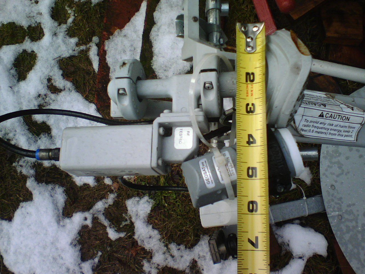

Whaddya know I do have a picture! with a ruler no less! :eek: :cool:

Interesting, does anyone have one of those that they could measure?
It has a symmetrical 6 bolt pattern, and the opposite bolts are approximately 1 3/8" apart.
Thanks! :)
The Superdish LNB mounts with 4 bolts, but has an 8 bolt pattern. The holes are about 1 9/16 inches apart on center. You could still probably attach a Superdish LNB, but you might have to be creative. The other thing that you would need to consider is that you will need to build something to mount the LNB on the dish since on the Superdish, they are held with these same 4 bolts.

No it will not bolt to a C120 flange, with all 4 bolts, only 2-bolts. have that same type odu unite here, an pop off that scalar an re-drilled it to accept a 120 flange lnb when I was setting up my 1.2m dish here. an it work well but a channel master feed really work a little better, so that is what I am using now. but I am a big beleiver in scalar rings on dishes, they will help any dish perform better when you use the right scalar with the right dish. so I would recomend using it, but play with some other ku-scalars at the same time, but remember to use the same lnb when playing with different scalars, because 1 lnb may be a little hoter than a other. an this is where a CtoN or a StoN meter is really helpfull.
now you may find that the lnb on the ODU, is made by "JapanRadio", an on mine here it was a .7db 100khz, which is a very good lnb. now on some of those style lnb on the ODU will have a small metal plate right inside it wave guide, if you'res has it just pop it out (only snaps in), that was meant to notch their freq that they where using on the receive end.
Been their an done it.

And, does anyone have any idea what the offset angle and f/d ratio might be on this dish?
