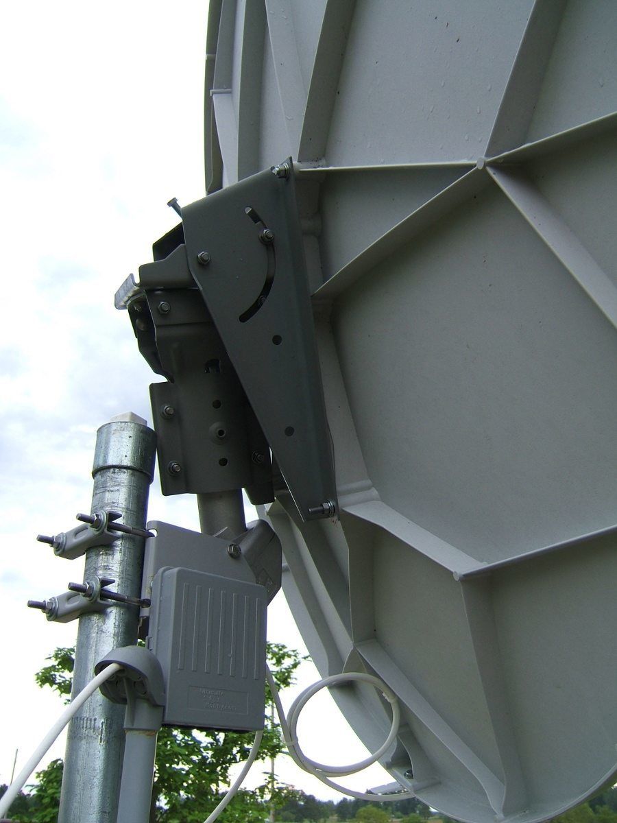

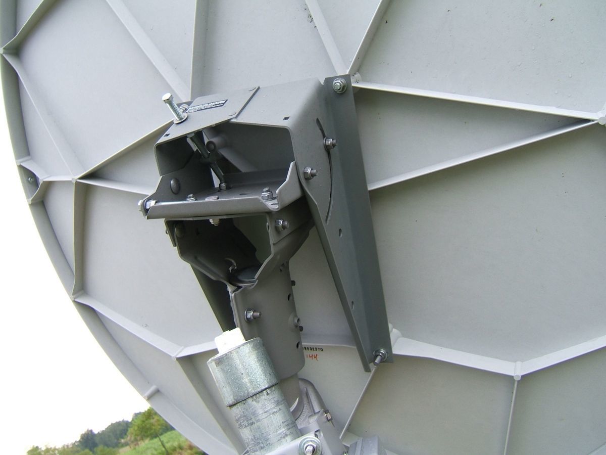

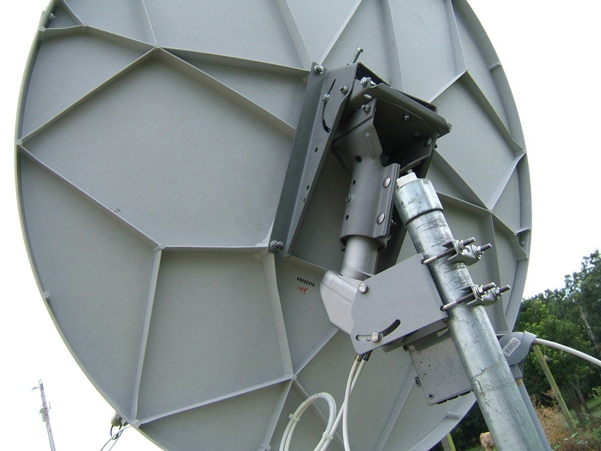

Here are a few photos of my AZ EL cap.
The dish is pointing to G23 in this photo with a 69 signal on a 1.25M dish

I'mm drooling, that's a sweet setup. I like the fine adjustment screws for the elevation. I am going to see if I can get a setup like that for this coming fall. Is the Dish a 1.2 M Prodelin, and did you buy it new?? It looks brand new, is that the polar mount and you adapted it for the up arm motor.
Sorry about all the questions your set up has peaked my interest.

Hi Mike, Yes this is the 1.2, & yes I did get it new. Mine is an ASC Signal brand VSAT dish. It's a lot of weight for that motor. This set up is 50 LBS. If you look at the last picture, you will see 2 square holes on the top of the AZ EL cap. Those are for 2 arms that connect to the sides, where the LNB supports connect. Anti Flex, but since I went over the rated motor weight by 13 pounds I didn't put them on. My LNB support was round. I bought some square tubing to make the adapter for the DMX741U. I will probably get board with that & put a regular Ku LNBF on it. Even though I get good signal on some TP's I get very poor to none on others. Where my 12' dish has no trouble pulling them in. All in all this is a fun toy. It was fun to make the LNB tube & get the Focal angle right. I enjoyed making the collar rings for the motor. Here in the US you see these dishes all over at gas stations, many are not used. I found what looks like an 8' Off Set on top of a local business, that's out of commission. I would like stop in some time & see if he wants that eyesore taken down:) That would be fun for testing C band on. EG Robinson, I always enjoy watching his acting.
