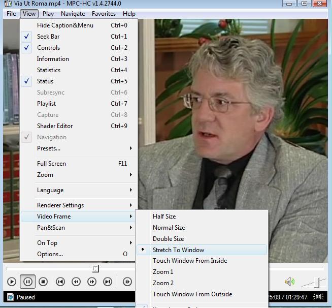

Try this setting in Media Player Classic-- See the picture

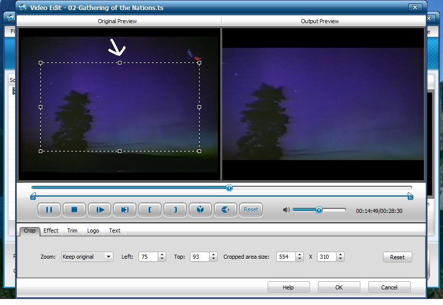

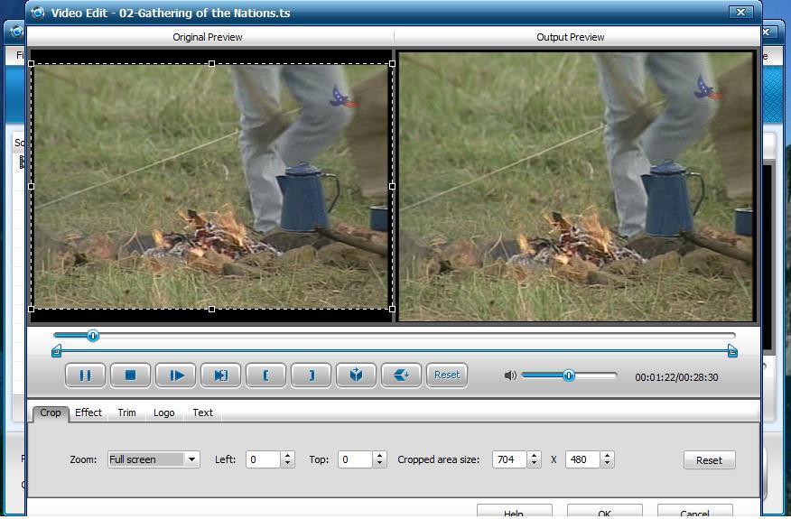

I was able to get it corrected by moving the box that the arrow is pointing to in the picture. Also as it shows in the 2nd picture set the zoom setting to "Full Screen"

See my last post I updated it-- but yes I have several recording from ADtv and have the same problem 352x480 is an odd aspect ratio. I was able to correct it by setting the zoom setting to "Full Screen" in iWisoft
OK, that works. So to get rid of the black border, I have to drag the dotted box, or change the parameters as follows in edit mode: full screen zoom, left 16, top 4, 320x476. I converted to HD mpeg2 640x480 (which is lowest), and hopefully most compatible. So MPC player full screen stretched is perfect this way.
