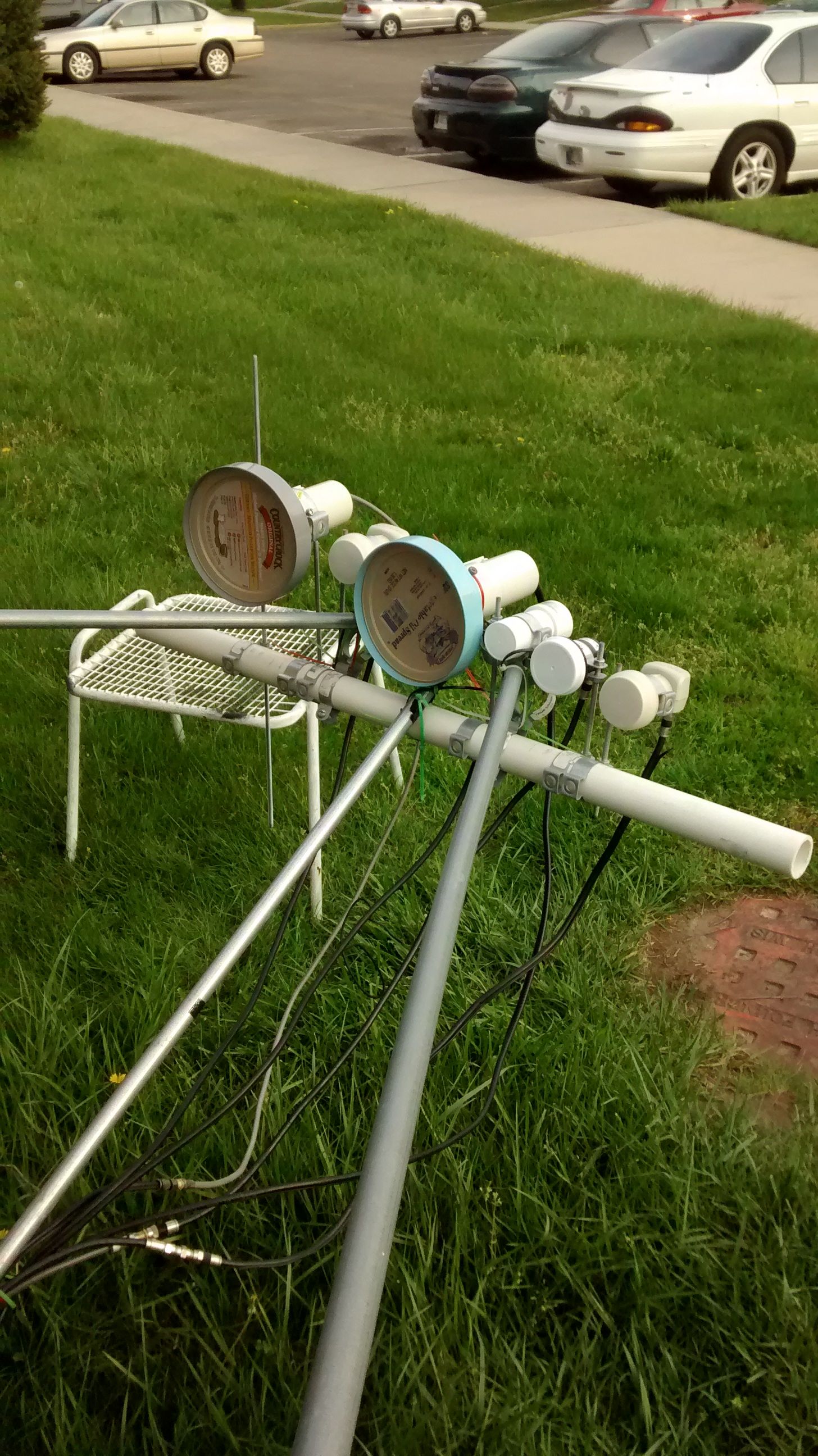

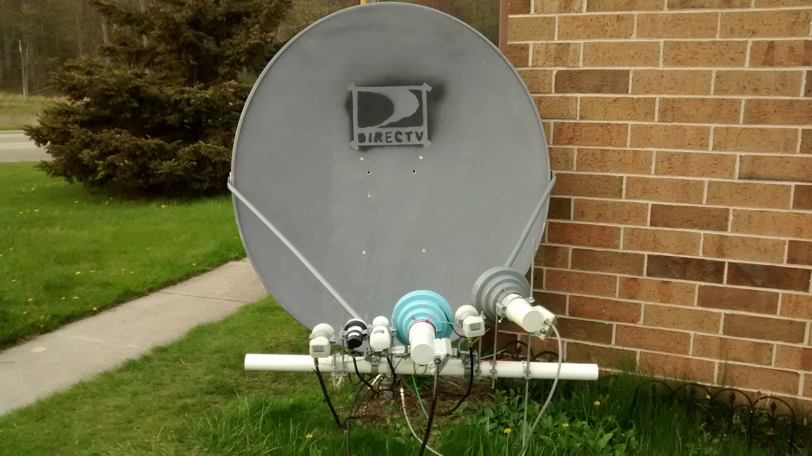

Today I got my new lnbf with scaler from Brian at titianium satellite I have it now working on 107w c band. I have also got a new amiko 8x1 switch from wallyhts. I wanted to watch 107w c band on my 1.2 meter dish so I have 6 lnbs on my dish now. 107w, 103w ku, 99w, 97w c band, 93w ku, 91w ku, 87w ku. I still have more work to do but its a start. More pics to come.

How is your signal on 107C with that set-up?
On the ctv 2 channel I had to work with the scaler to move up towards the dish to level 40 70q you have to get that number. You need 70q nothing lower or you will have lots of noise. Going to work on it soon to get the weather network channels. Ctv2 comes in at 70q+.

Dan I think that dish is only for directv.
Looks like someone hacking Directv....:D
Arrrr shiver my timber where is a levelty winch to walk the plank and cook my meals?
Chirp chirp chirp chirp. Today with rain and storms having a little trouble with 107w but still watching Ctv2. No luck with the weather channel still lot of noise.
Love the painted on Directv logo!. Keeps the nosy people away, they just think your a Directv customer. Very nice install and good job getting all those birds. It sucks for apartment dwellers to have multiple dishes.

Have an update here these are the transponders that I am receiving. Side lobe 107w c band 8 to 10 degrees off center.
3807 v 70q
3825 v 70q
3860 v 70q
4060 v 71q
4100 v 65 to 70q
I am at the bare minimum of trying to receive this satellite the threshold is at 65q 4060v is the one you need to aim for.
