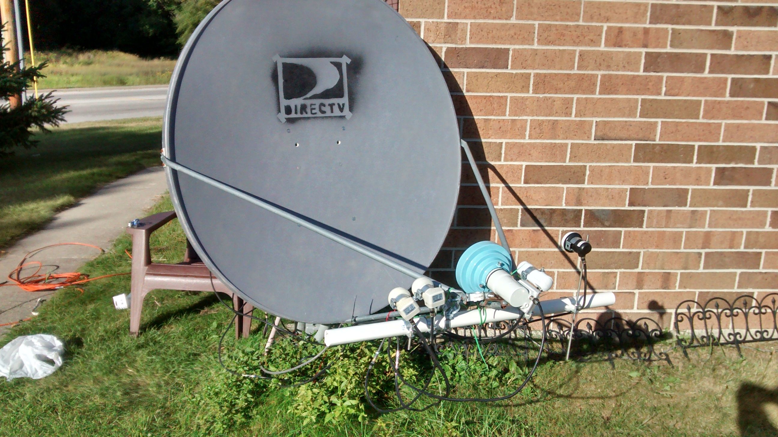

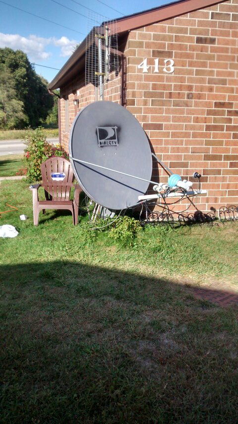

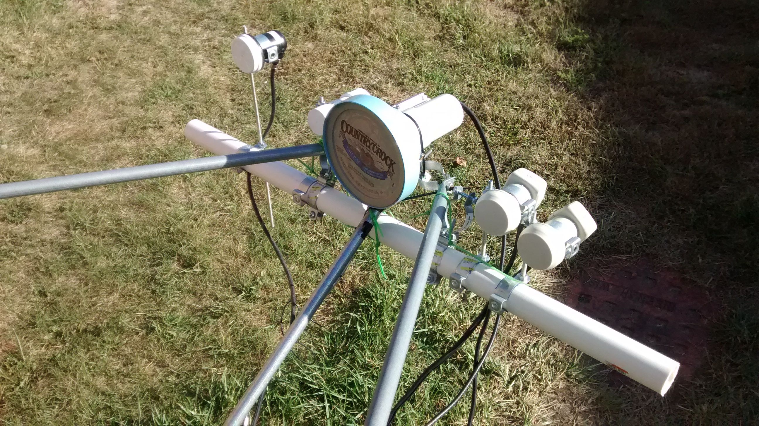

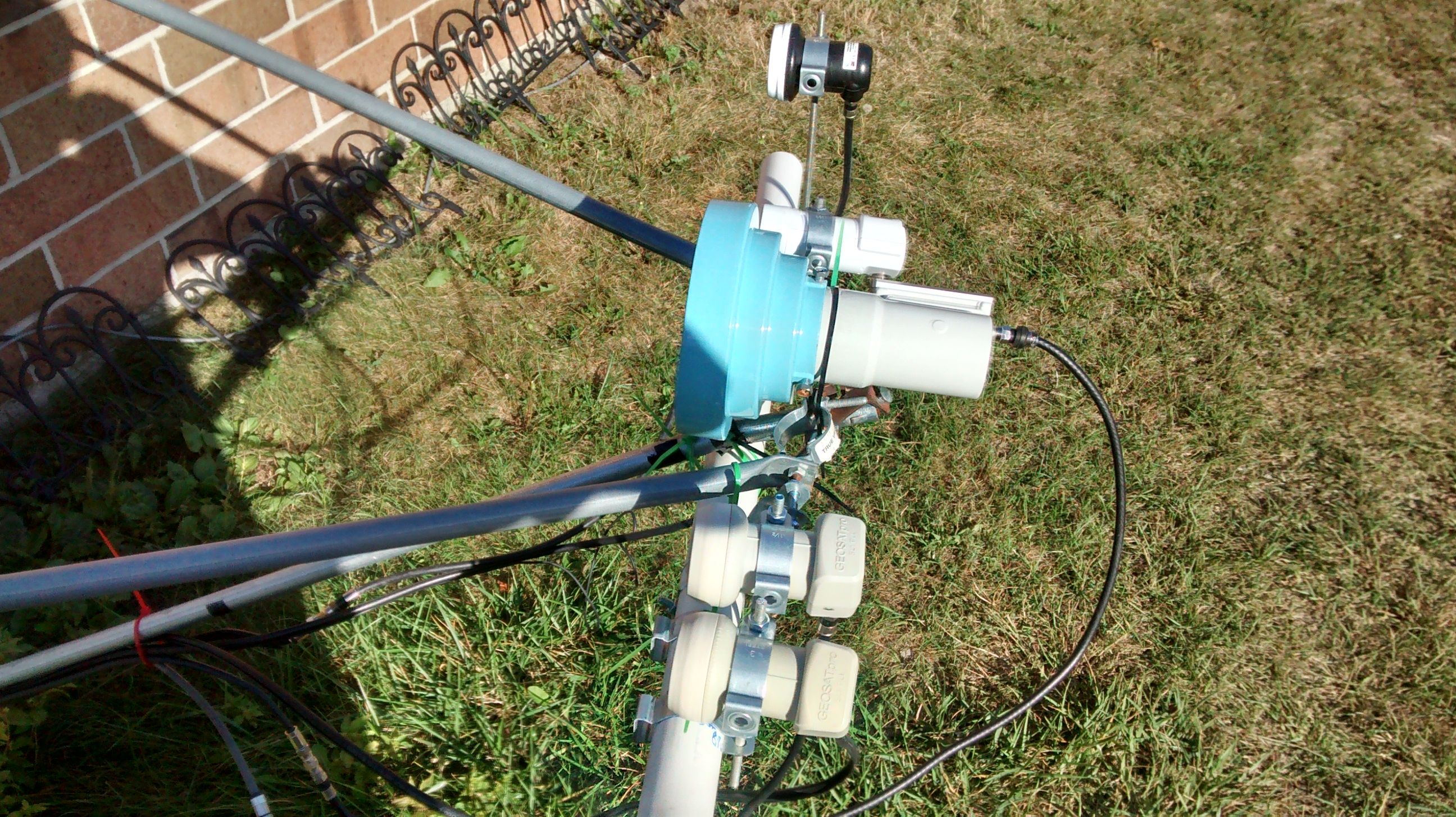

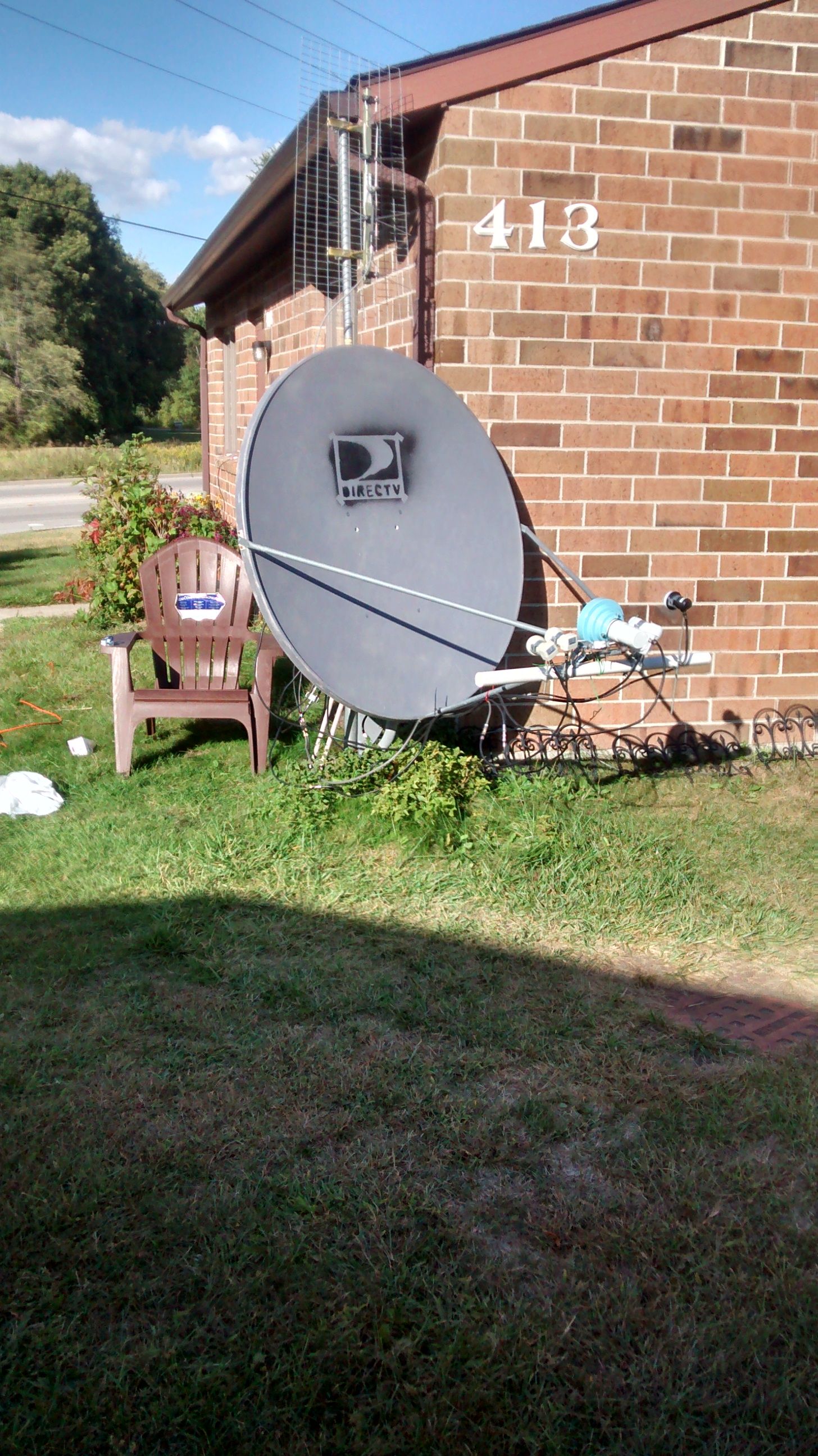

Here are some updated pics of my special 1 meter dish. Still a work in progress. 87w ku, 91w ku, 99w c band, working on the other two lnbs.

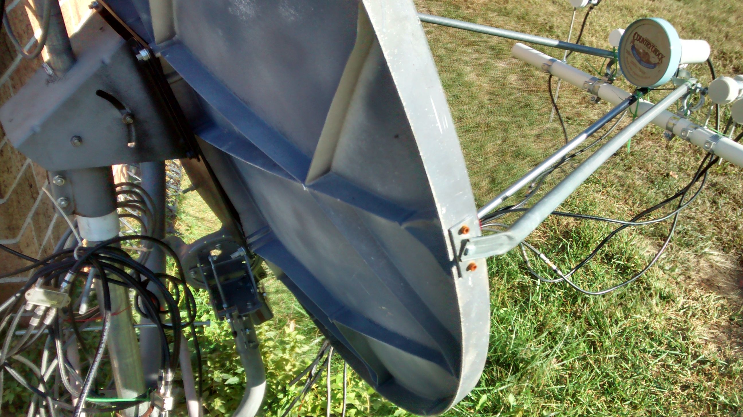

Its a "special" 1 meter commercial dish thank you jorgek. I like the local hardware store. To line up 91w ku find the abc news now transponder then it will help get 99w. If anyone needs a list on parts just ask. Also look at the last pic its brace to help support arm when it broke last winter.
