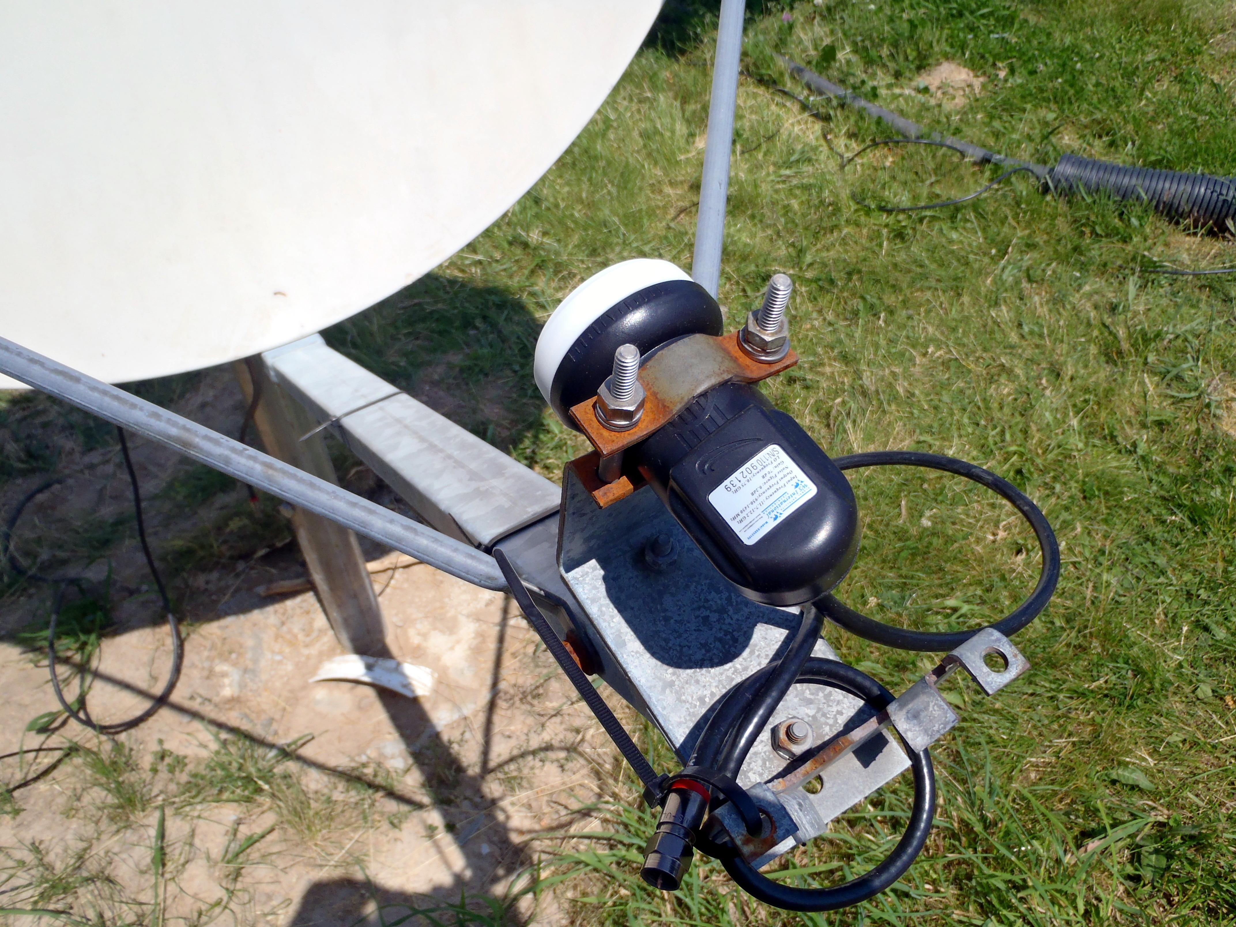

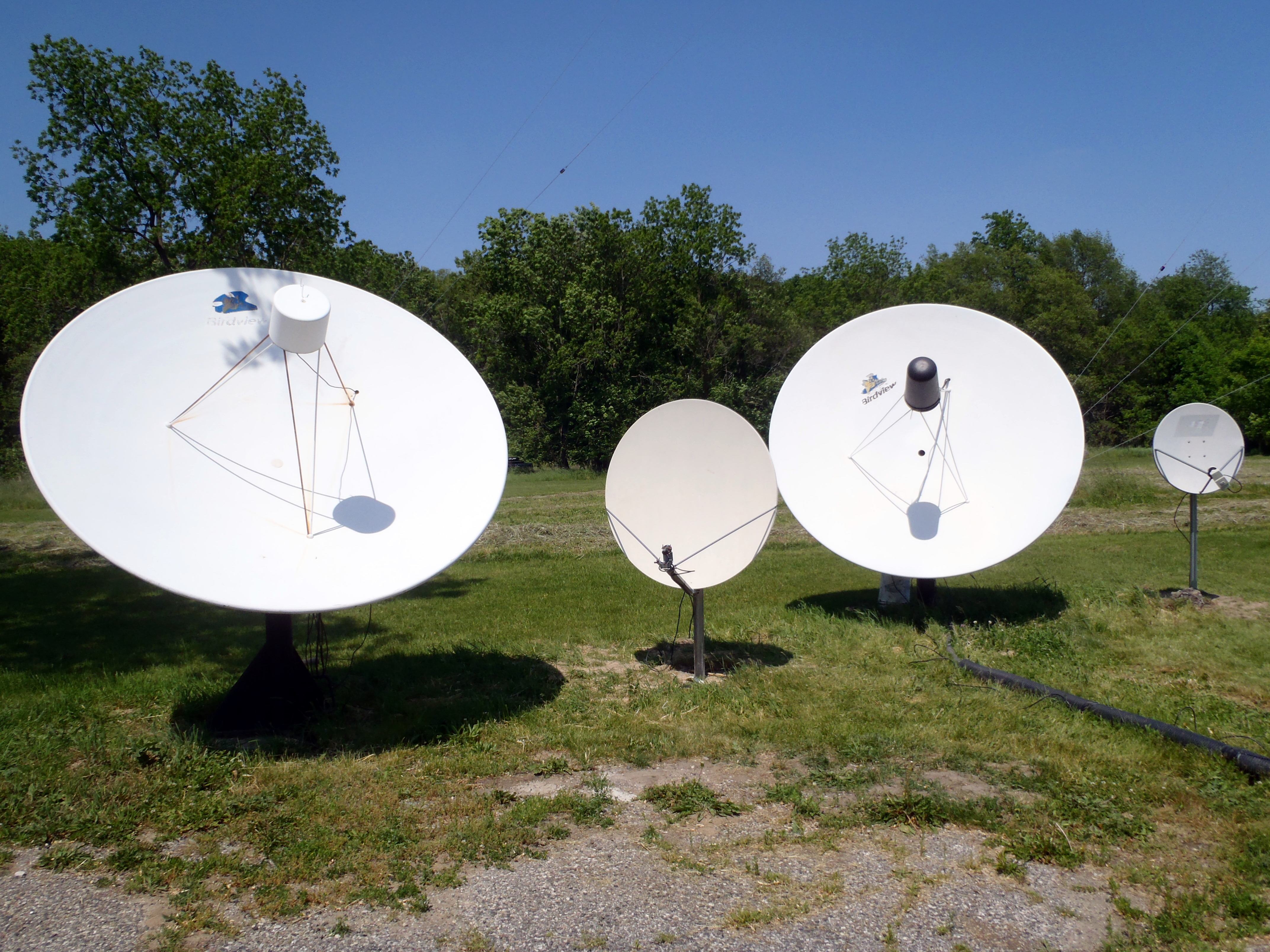

I finally got a few minutes to set up a dish I got from member PIXL last year. Concrete was set last week. The goal was to make it a dedicated 125 PBS, to free up the Channel Master so I can add a hefty (metal geared which I already own) motor. I'm not as good at aligning offset dishes as the center feed ones and needed something easy to monitor the signal and quality. Realized I had nothing left that was portable with a "video in"...then.....

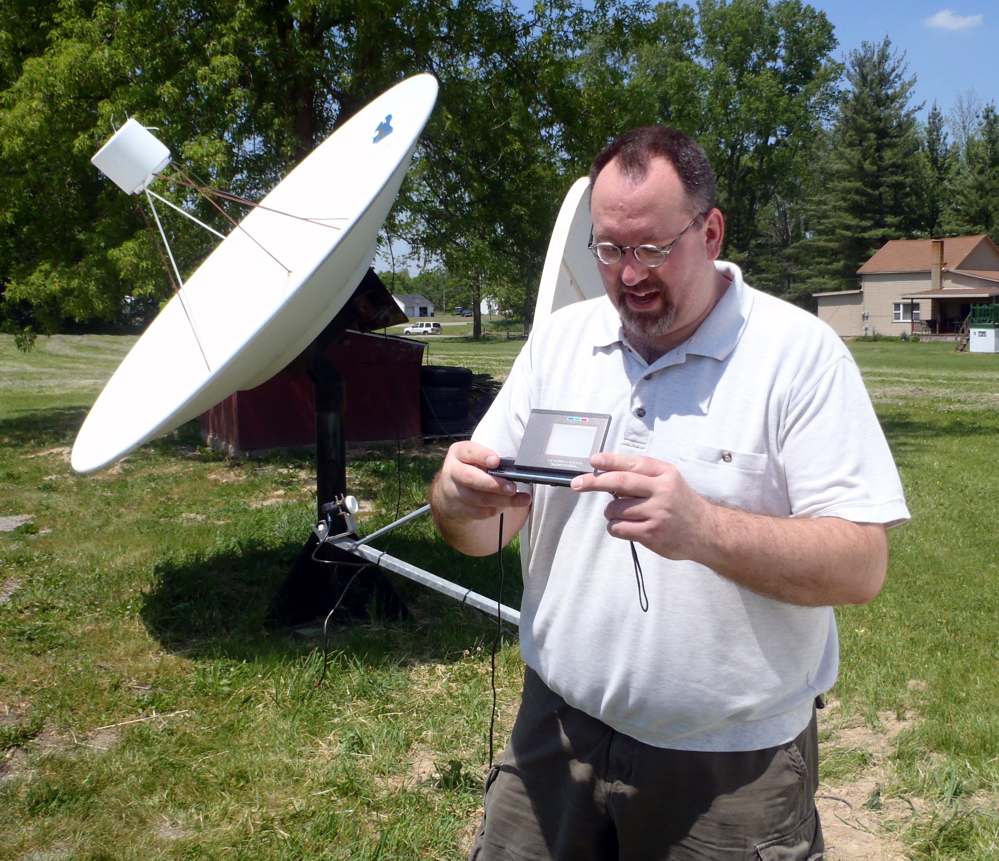

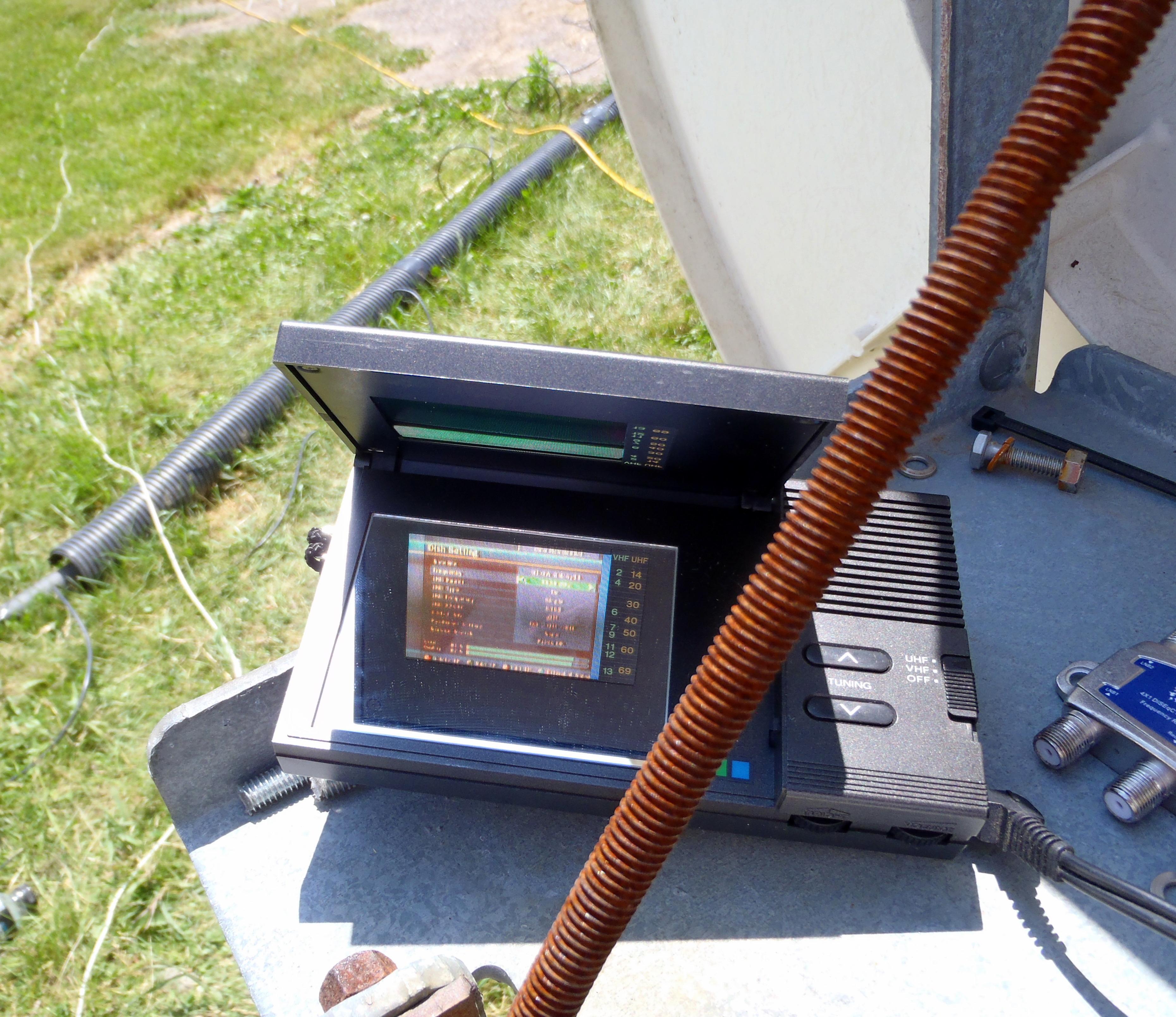

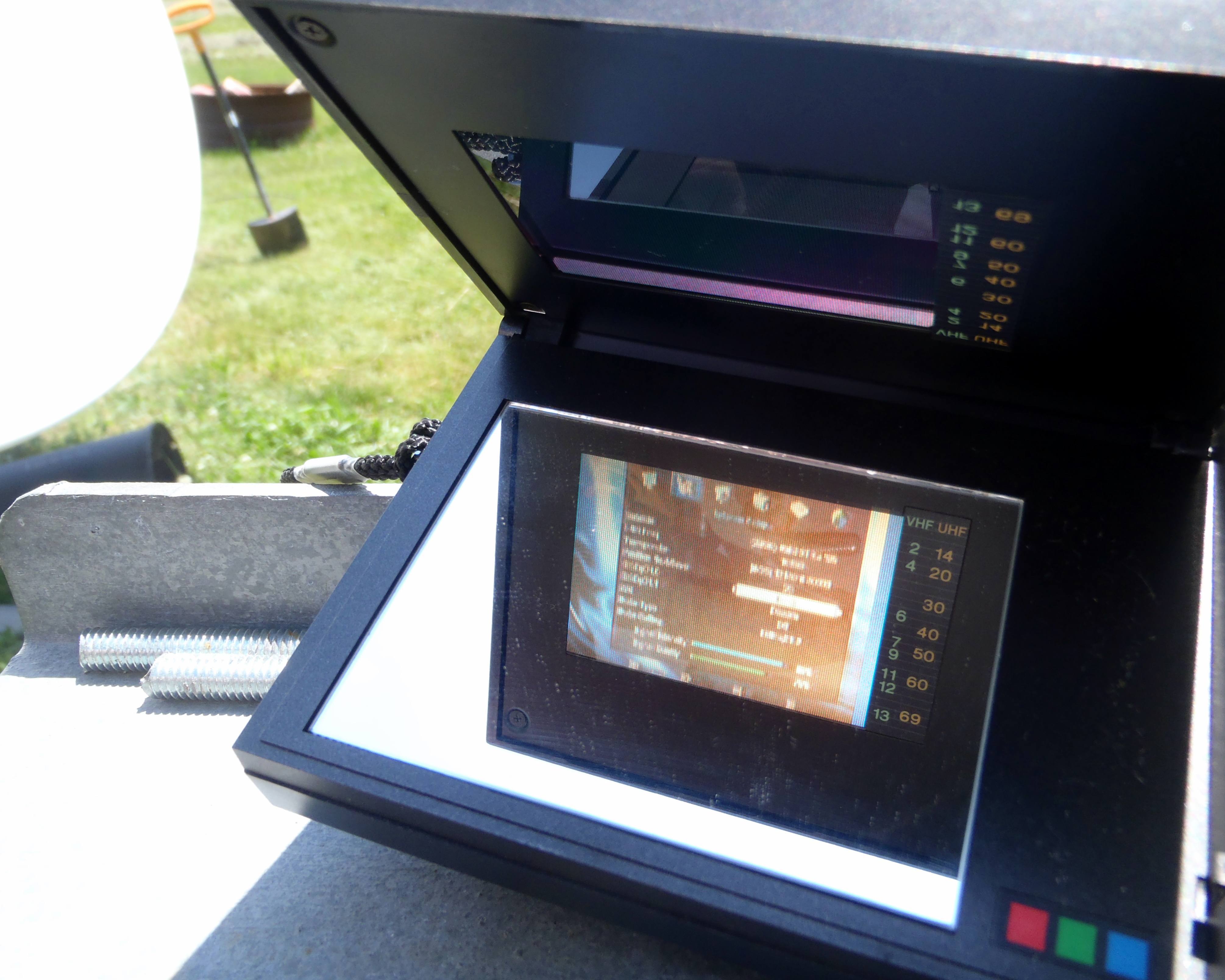

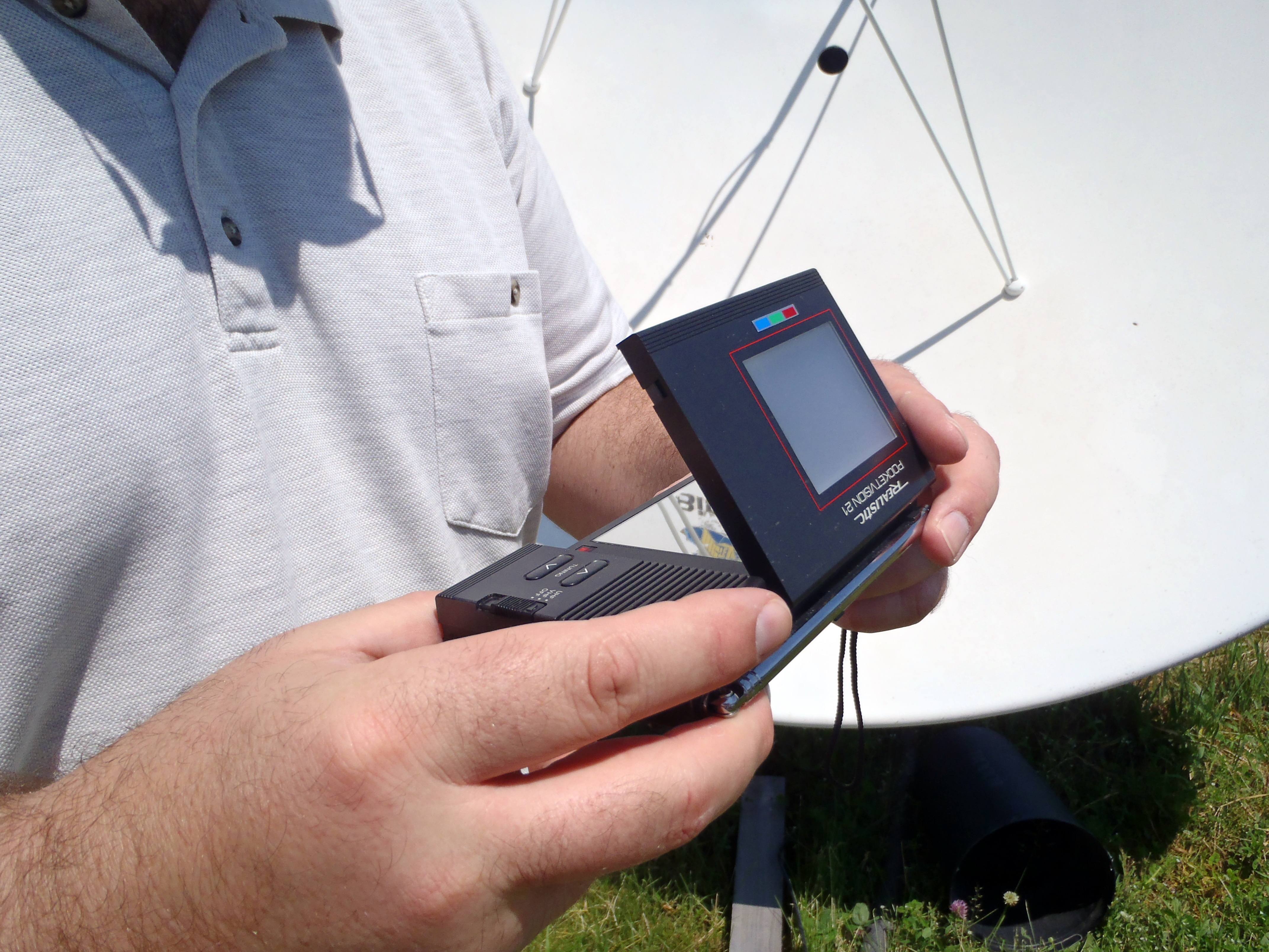

It hit me! I had an early LCD color TV with video input. The kind that had OPTIONAL backlight and would be visible in daylight! As you know, it gets BETTER in bright light! Plus all you have to see is the signal graph! Small, but...one long video cable and 4 "AA" batteries later, the battery operated mirror-type TV was helping us align!
My staff and friends thought I was nuts, but...it worked so nicely!!!!! (Even Scott, our part time engineer shown in the pic thought it was pretty cool....though he removed his glasses to read it up close.)
Okay, go ahead and laugh.............but, all the dishes are now functional! Now on to motorizing the former DTN!!!! (channel master)...and the dish from PIXL works great with a WS Ku LNB. The signal actually exceeds the Ku portion of the Birdview, which has not been tweaked in a long time.

"That would've had me so blind I would've walked into trees after a bit, lol. Is a neat trick to use though, if you can see it.
Did the job! But, remember, all I had to see was the infamous two bars for signal and quality. Even got to explain that to my buddy who helps with FTA but doesn't quite understand yet why I do it. I didn't realize how much I had relied on having a monitor available of a reasonable size! Guess its time to find a small AC/DC set for the back of the jeep when I'm working on my growing "farm."
